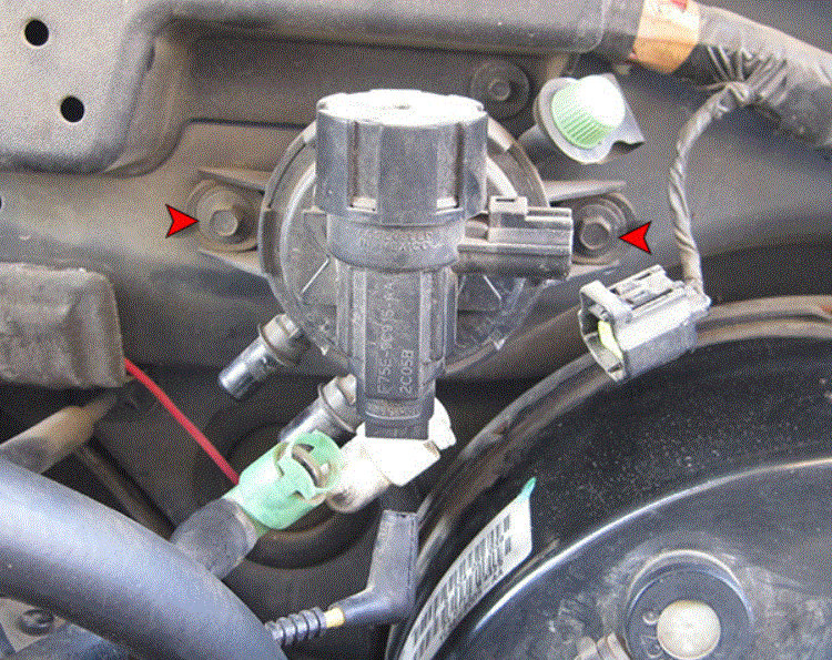

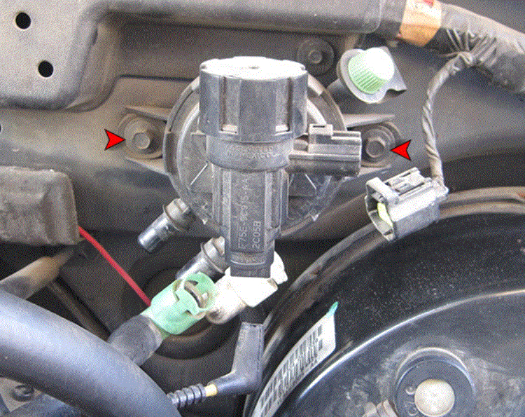

Changed the fuel injectors and after that it started stalling and shutting down and backfiring through the throttle body. It wont idle. Got a code for oxygen sensor so changed that. Still doing the same thing but then got a code for MAF. Changed that and no difference. Now got a code for the purge canister valve. I'm at a loss on what to do.

First, let me know what codes are present at this time. Next, were there any issues prior to the injector replacement? Were the correct injectors used for replacement?

The code is p0443. I don't have the pressure tester but when I check the pressure port on the fuel rail it's getting plenty of fuel.

The pressure needs to be regulated to a specific pressure. There is a chance it could be too high.
Is the P0443 the only code you found? That is related to the canister purge solenoid. Have you checked for a vacuum leak at that point or if something was damaged or left disconnected? It is located near the power brake booster on the firewall under the hood. See the attached pic.
Also, I need to confirm if this is a 5.4L or the 4.6L.
Monday, June 28th, 2021 AT 1:13 PM (Merged)
JOLENES13
It is a 4.6.L. I know that code is for the purge solenoid. Nothing is damaged or disconnected. There are no vacuum leaks that I can tell. I'm just at a loss because it will give me a 1 code and I will fix that and then that code goes away but gives me a different one so I'll fix that and it's like a never ending cycle.

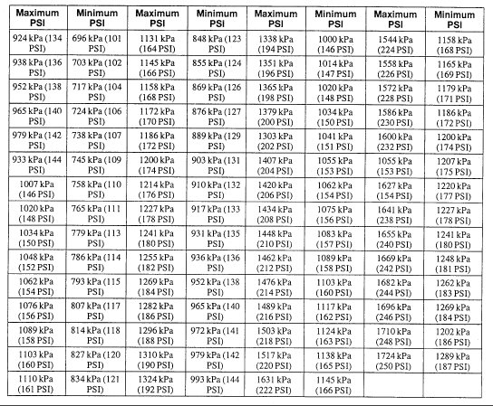

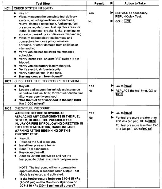

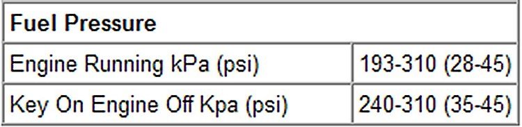

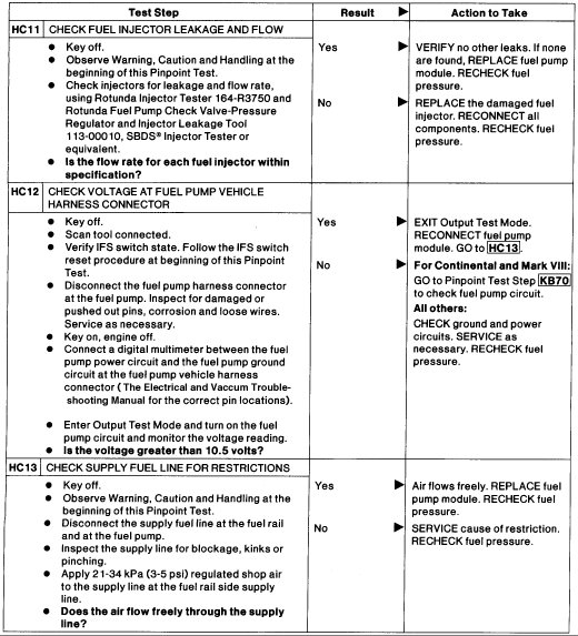

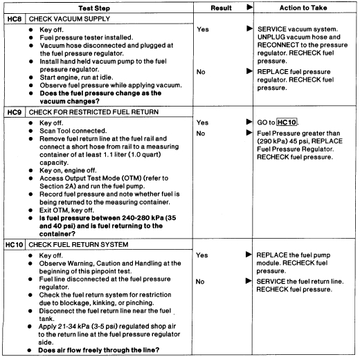

Truck will only start when the gas is held down and then will not stay running.

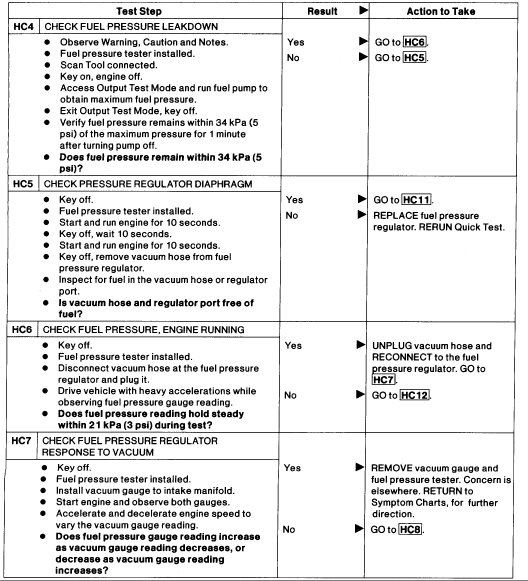

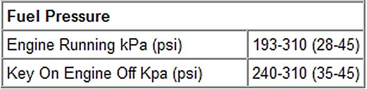

Hi and thanks for using 2CarPros.com. I will assume you mean you are catching the vehicle in gear. The first things we need to check are for a good spark to the plugs and fuel pressure from the pump. Here are general directions for checking for spark:
Here is a video showing how fuel pressure is tested:
https://youtu.be/peh7-pFycyc
As far as the fuel pump pressure specific to your vehicle, the first picture I attached indicates the fuel pressure specifications. The next four pictures are of flow charts if you find a problem with pressure.

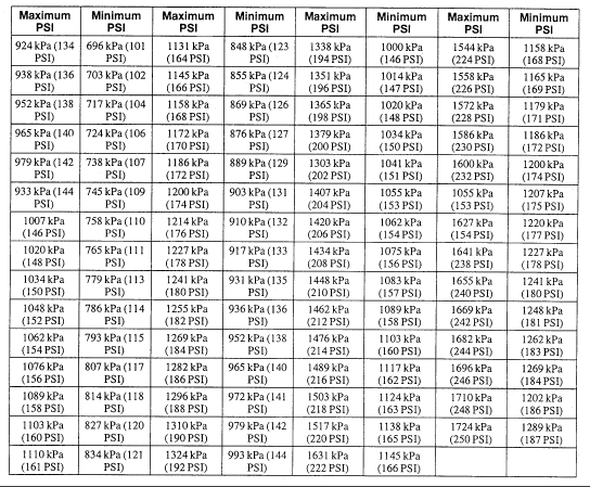

If you find that fuel pressure and spark are not an issue, the next thing you will need to do is check engine compression. Here are general directions for that process:
Here are general reasons for low compression:
https://www.2carpros.com/articles/the-reasons-for-low-compression
Here are specific directions for your vehicle:
Gauge check
AllData Editors Note - Ford does not provide a cranking pressure specification, only an acceptable range.
Make sure oil in crankcase is of the correct viscosity and at the proper level and that the battery is properly charged. Operate the vehicle until the engine is at normal operating temperature. Turn the ignition switch to the OFF position, then remove all spark plugs.
Set throttle plates in the wide-open position.
Install a compression gauge such as Compression Tester in No.1 cylinder.
Install an auxiliary starter switch in the starting circuit. With the ignition switch in the OFF position, and using the auxiliary starter switch, crank the engine a minimum of five compression strokes and record the highest reading. Note the approximate number of compression strokes required to obtain the highest reading.
Repeat the test on each cylinder, cranking the engine approximately the same number of compression strokes.
Picture 6 is of the acceptable range of compression.If you find the compression to be lower than 110psi, that is most likely the problem.
