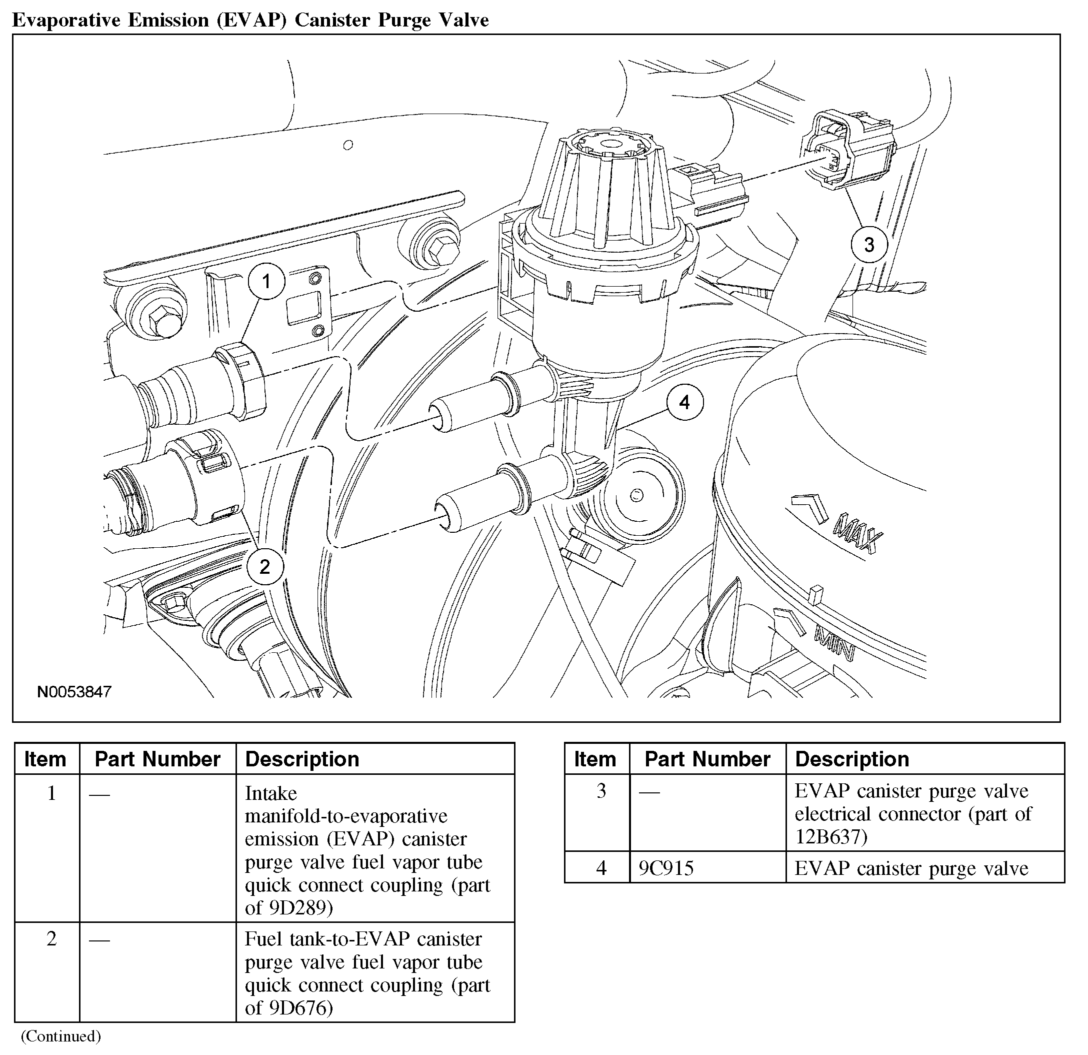

One thing I can say to check is the evaporative system purge valve, make sure it's not stuck open. These are notorious for sticking and I have several customers that keep an extra one in their glove box. Just disconnect the electrical connector and make sure that vacuum is available at only one of the ports. If vacuum is available on the fuel tank side, you have a stuck valve. This is just one possibility amongst many, but there was also a PCM reprogram for similar issues but there is no guarantee that it will completely resolve your issues.
Jun 28, 2021 at 6:12 AM (Merged)

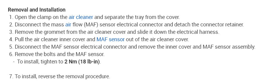

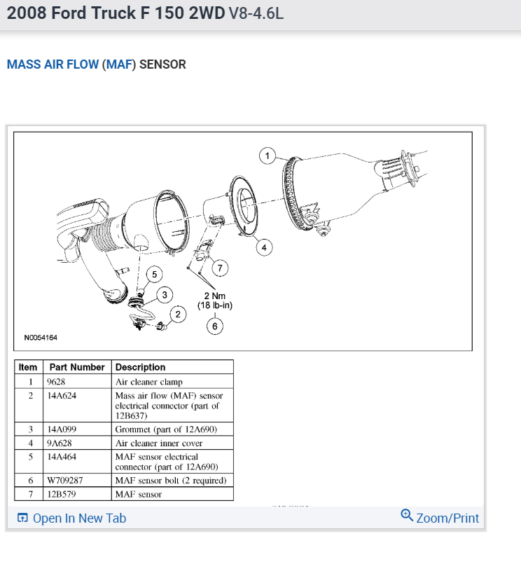

There are updates they need to be done which can solve your issue. But I noticed you cleaned the MAF which only works sometimes. I would try a new MAF OEM. Here is a guide to help walk you through and diagrams below to show you on your truck:
https://www.2carpros.com/articles/how-to-replace-a-mass-air-flow-sensor-maf

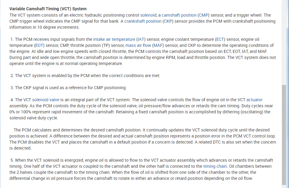

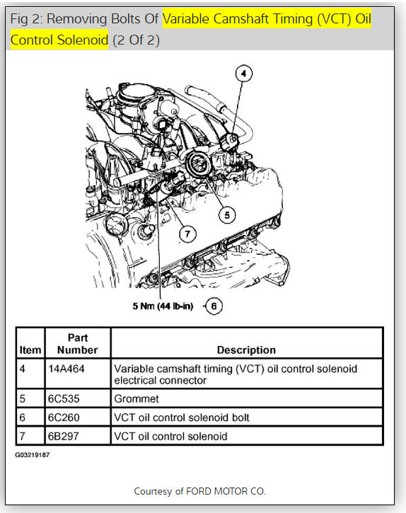

My engine (5.4l Triton) doesn’t want to run when in drive or reverse when it is warmed up. I just changed the oil in it and an hour after that when I was driving, it kept trying to shut off. When I put it back in park and rev it, it goes back to a perfect idle. But when I put it back in drive it goes to this terrible rough idle then shuts off.
Jun 28, 2021 at 6:13 AM (Merged)

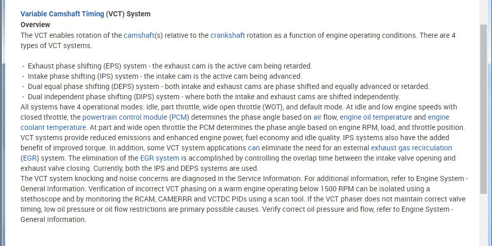

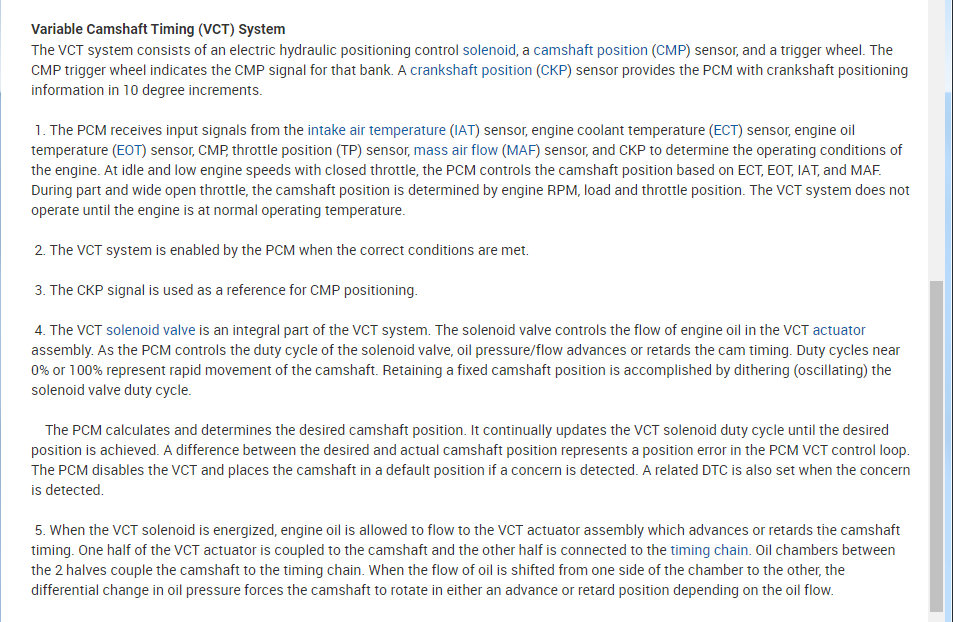

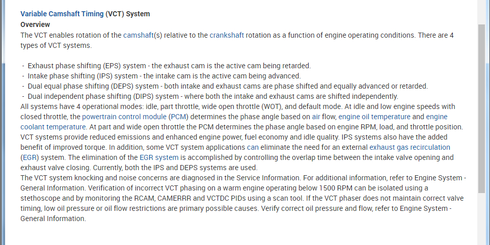

If all this happened after an oil change then we need to check the oil level and what type of oil you used.
You have a variable valve timing system. So this means there is an actuator that uses oil pressure to alter the cam timing to match driving conditions. They return to what is called lock pin when in park so that would make sense why it runs fine in park.
https://www.2carpros.com/articles/how-camshaft-variable-valve-timing-works
I attached info below as well for this system. Please let us know what oil you used and we can go from there. Thanks

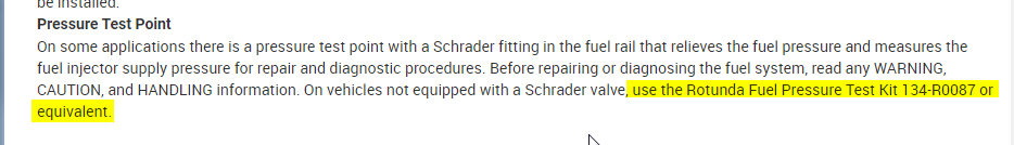

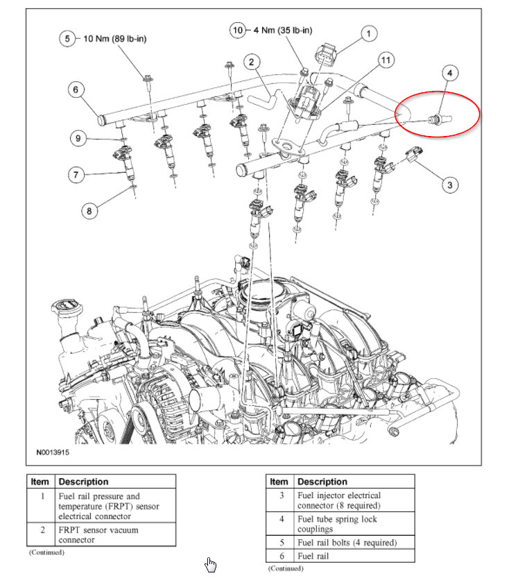

Okay, I’ll start with the fuel pressure. I looked for that valve thing where I hook a pressure gauge but could not find it on the fuel rail.
CDNOVA77
Do I need to remove the throttle body to clean the throttle plate and iac hole? Where is the iac hole located? Thanks!
You are correct. Your engine does not have a valve for this. So that means you need use the tool kit that is supplied below. Sorry I didn't give this prior but most all Ford's have this valve on the rail but yours doesn't.

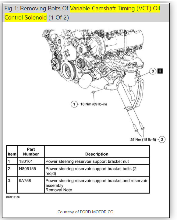

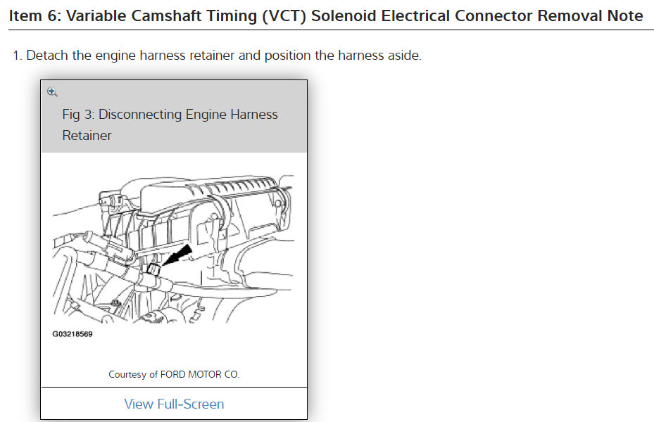

for the P0010 a camshaft position actuator circuit/open bank 1 9 times out of 10 it's the actuator that needs to be replaced. here is the location so you can check it out:

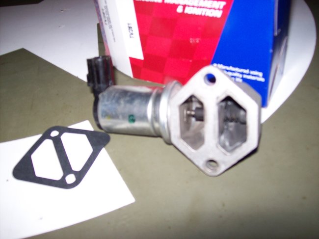

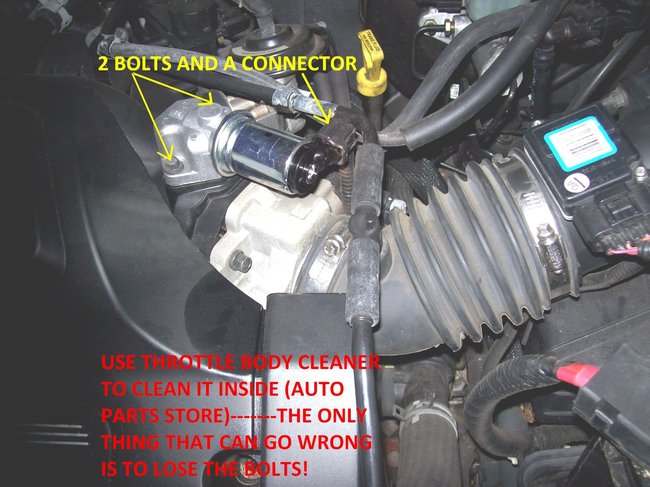

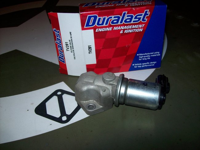

CJ MEDEVAC
  • 11,004 POSTS
This sound similar.
This may not be the answer, but you can easily rule it out! This will sort of guide you to what you have to do, it is really easy to do!
My wife's is on the top and has two bolts. Our Escape would idle low, then it got to point it would die when you stopped.
Revving and holding brake was only way to keep it running.
Took it to fellow R/C airplane pilot, he doubles as a S.C. State Highway Department mechanic. When I got to his house, he was repairing a tractor.
Told him my sob story. Escape was still barely running, I raised the hood.
He said, (and I quote)."It could be the idle air control (IAC)", as he pointed to it, and emphasized it with a sharp rap using the wrench in his hand.
It straightened right up, and ran good!
That was a 15/16 Craftsman wrench, box end, kind of a medium rap.
We removed and cleaned it, it may have gone on being Fine, for a lot longer.
Since it was my wife's, I took no chances, with my well-being. Yes, I visited parts store and replaced it, figured it had 100,000 miles on it, and constantly was a moving part, replacement of this component, was just preventative maintenance in my eyes.
Hope this helps.
Hope I am dead on! Cleaning would be free! (less a can of throttle body cleaner), and at least maybe eliminate this factor out of the equation. You can go on and replace it later, if you have the same feelings about it as I did. It is not really expensive.
Please let me know how this goes.
The Medic
