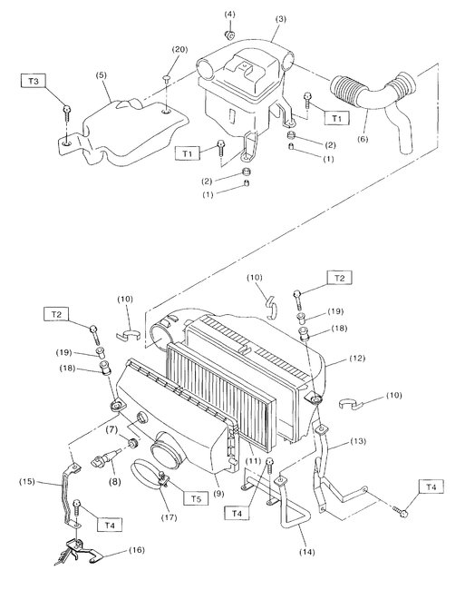

Hi, I recently changed spark plugs with new iridium plugs. Engine runs great throughout the rpm range, slightly more power than before, as expected. However now when I open the throttle/gas pedal above 3/4 (full throttle), regardless of rpm the engine makes a loud humming noise rather than adding power. It seems as if it is choked for air or fuel... I have since also changed the plug wires, ignition coil, air filter and fuel filter, and the fuel pump is relatively new, but the issue persists. Could this be the TPS? MAP? A bad cat? Trying to decide what to do next.

Also, the noise you hear could be a vacuum leak. Make sure the air box and intake tube are fully connected and tight. If either is loose, the humming sound could be what is heard. Also, the sound would get louder the more throttle you give it.

If you look at the attached pic, it shows what I am referring to. Please make sure none of the connections are loose, cracked, or disconnected.
