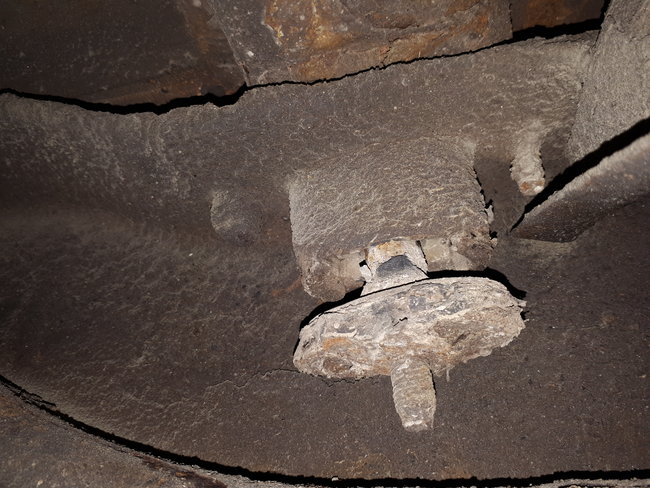

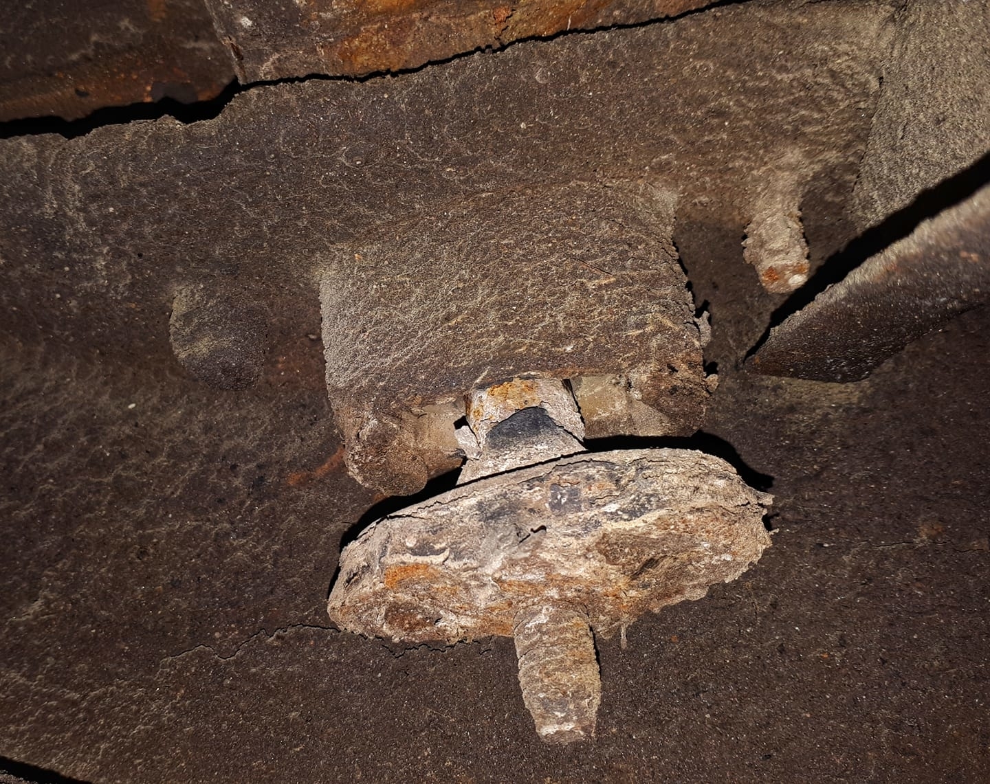

The van body mounts are totally shot. I don't even have a photo of what they should look like. I want to fix it up good or better than new. I cannot find new mounts anywhere. I thought we should jack the van up, remove all the bolts and replace one mount at a time. Any information would be greatly appreciated. The mounts seem about 4 1/2 inch by 1 1/2 inch with rounded ends. Please Help.

Hi Danny: Unfortunately these just won't fit. They are round and the original ones are not. The original ones are 1 3/8 by 2 ¾. Sort of rectangular with rounded ends. As shown in the photo I sent the bottom mount fits inside a fitting bolted to the frame.

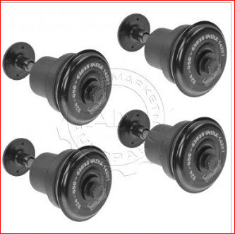

These are from Dorman as well. Do these look like the ones? I've attached a photo. Hope this helps and thanks again for using 2CarPros.

It kind of looks like it might fit but it doesn't. I bought the set from Rock Auto and had to send them back. The four back mounts on my van are 1 3/8 by 2 3/4 inch, sort of a rectangle with rounded ends. The back four mounts fit into a sleeve sort of thing bolted to the frame.
