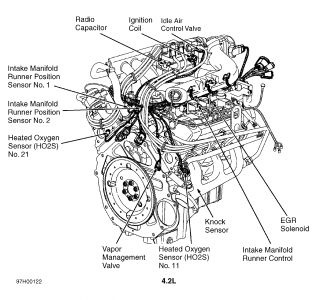

P0401 is EGR insufficient flow, do this: Yep! Pull the egr off, clean the port under it all the way to the throttle plate, I use a length of steel coat hanger...put it all back together, reset the codes, if light comes on again, replace the EGR position sensor, that's the one the two small hoses from the exhaust plug into! P1537= Intake manifold runner control, not the IAC Here is a diagram for component location is case you needed it. 10/31/2008
https://images.2carpros.com/forum/automotive_pictures/62217_imrc_1.jpg
This is the only picture I could find for you....
