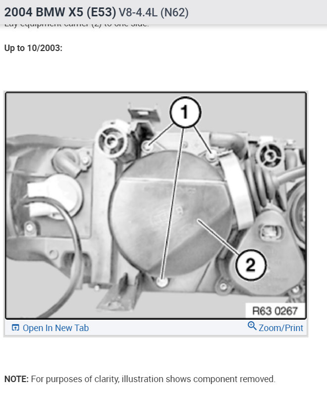

Hi. The outside passenger side bulb on my car listed above stopped working and before I buy a new bulb I wanted to remove the old bulb to be sure I was ordering the right part. I twisted open a 4” wide circular easy to reach black cap, unplugged a black cap to the back of what looks like a round halogen bulb but now I can not twist it or jiggled it free. I am stuck. There was no ballast connected to it. It is not a Xenon light. Can I pay someone to do a zoom meeting to look at it and tell me what is wrong and what part to order?

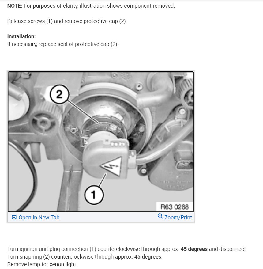

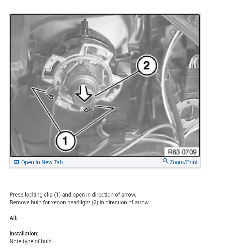

Are you talking the headlight or the parking light? Upload a pic. Some bulbs are held in with a spring wire that acts as a clip but if you upload a pic I can tell you. Let me know. Check out the diagrams (below). Please let us know if you need anything else to get the problem fixed. Tom
Jul 9, 2020 at 8:56 PM
BRANDON BAKHTIAR
You were right Tom. Thanks. Just got the bulb out. It was a clip with wings that had to also be twisted a tiny bit. Bulb is a Osram 64210ST 12V 55W H7U DOT E1. I think it is a warm in the Kelvin color scale (lower, bluer or whiter is higher) and only 1600 Lumens. Can I replace with a brighter lumen bulb or does it have to be exact exact? Thanks again.
