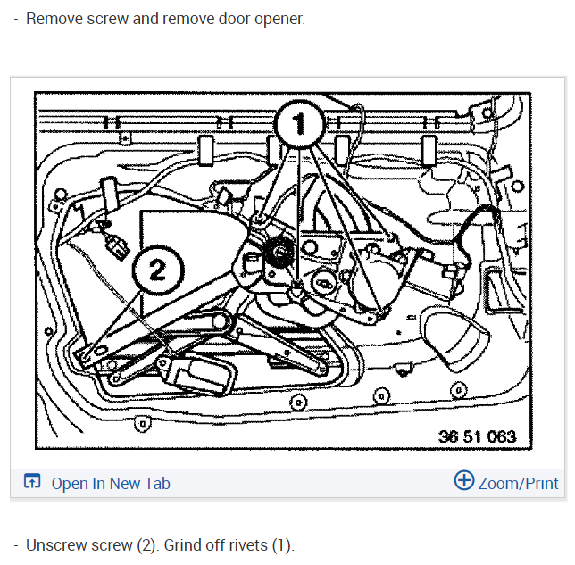

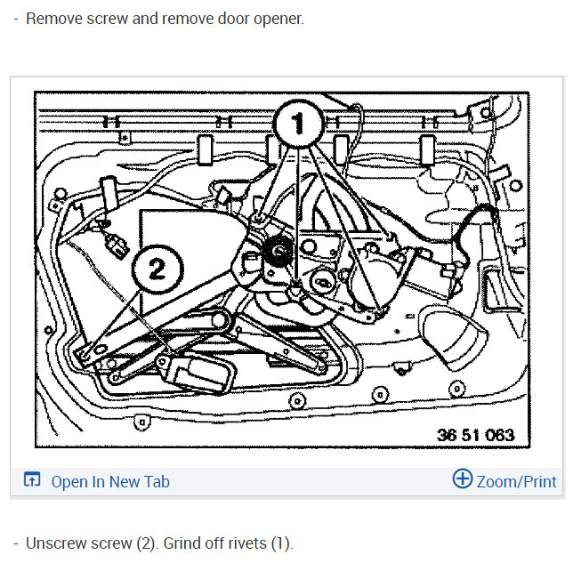

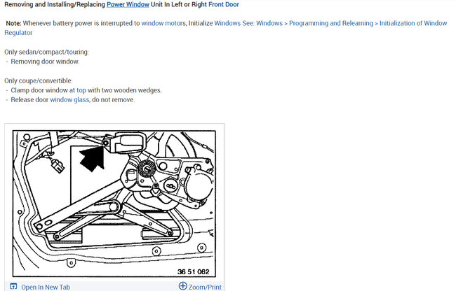

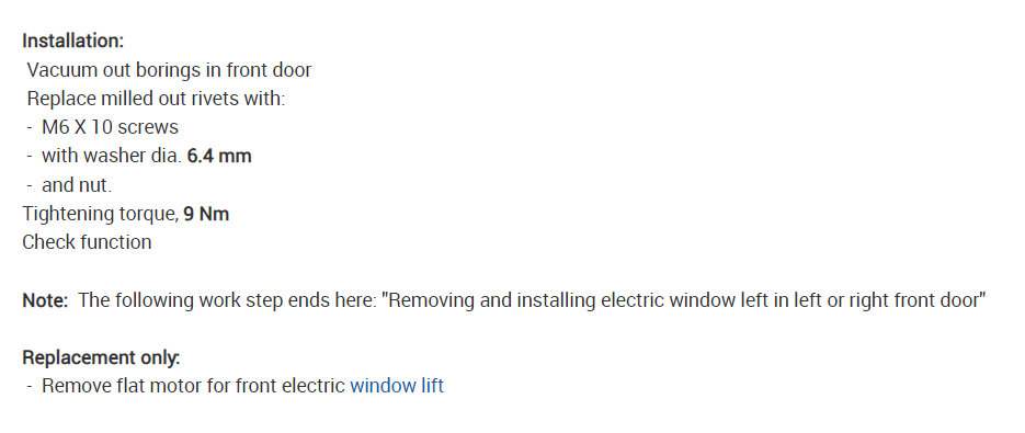

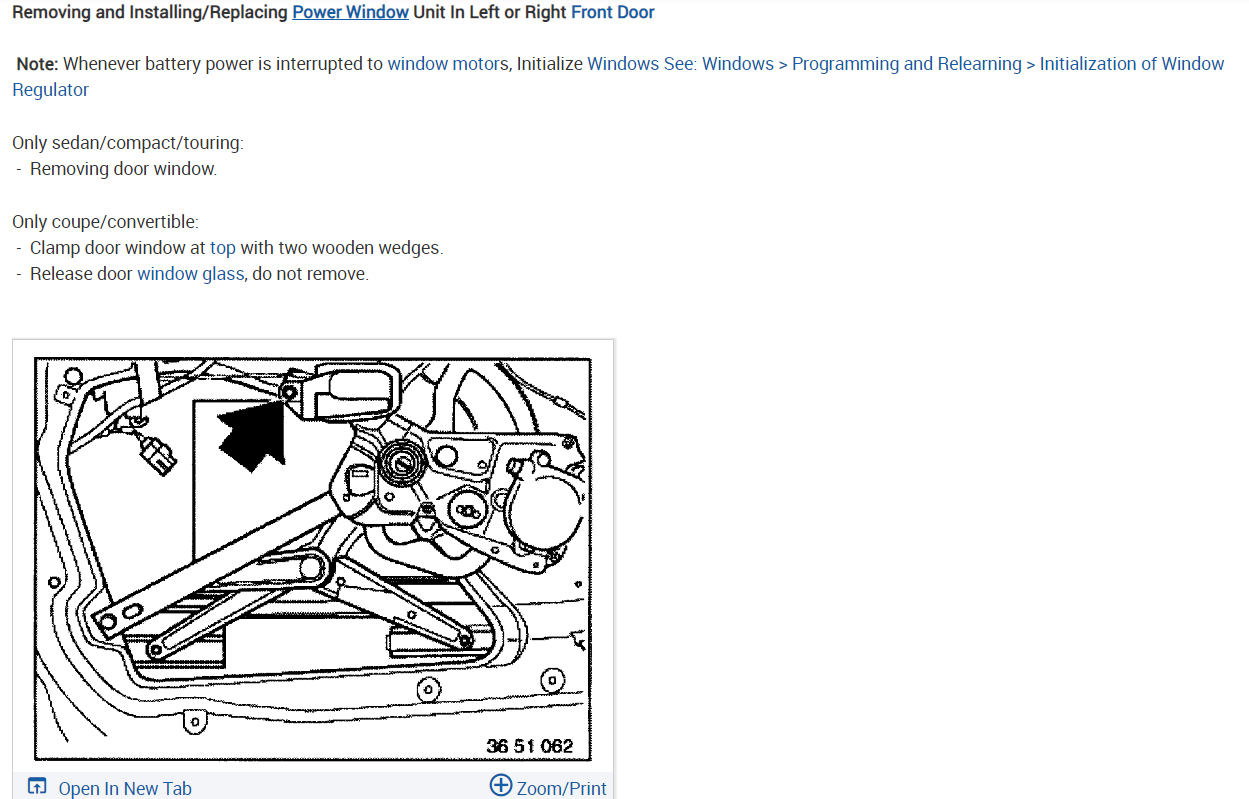

I have a 1995 BMW 318i and the driver's electric window goes down fine but you have to push on it to go up. What is wrong?
Dec 8, 2007 at 7:47 AM
DOCHAGERTY
  • 9,606 POSTS
The window regulator and/or the channel the glass runs in are suspect and will require disassembly to know for sure.
Dec 8, 2007 at 9:17 AM
  • 55,658 POSTS
Most of the times the window regulator/motor is to blame. Here is how to change it out. Check out the images (below). Let us know if you need anything else.
