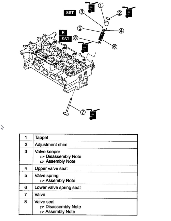

Thanks, I left out on thing it likes to do this on cold starts. If its warm out no smoke. Just started when it started getting cold. Other issue I just looked at the PVC valve and the rubber seal it fits into is bad. Get back to you after checking cylinder compression.
Nov 7, 2019 at 1:09 PM
Okay. This doesn't change the causes of blue smoke but it could point more to a rubber component which would be the valve seals. Again, if this it then I suspect the compression will be fine. Let me know what you find. Thanks

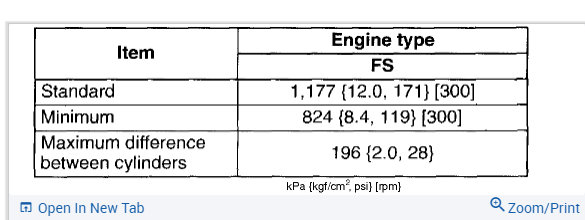

Hey I checked the piston compression.
Cyl1. 115 psi dry 125 psi wet
Cyl2. 110 psi dry 123 psi wet
Cyl3. 110 psi dry 124 psi wet
Cyl4. 115 psi dry 123 psi wet
Nov 12, 2019 at 3:13 AM

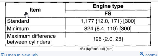

Okay. Compression is low but it is even. Standard compression on this engine is 171 PSI. Minimum is 119 PSI.
You may not like this recommendation but you are about to open a can of worms with this issue. You are burning oil and have low compression. This points to ring issues. I would suggest just checking the oil on a regular basis and make sure it stays full and drive it until it starts making noise or fails. The reason is, you are going to end up with an engine rebuild or replacement trying to fix this smoking issue. However, the car runs and is doing its job but just smokes a little so I would not chase that issue. Basically just start setting some money aside each pay check until you have enough saved for an engine replacement/rebuild and then just drive it until it needs it. The longer it goes, the more it is paying you back. However, if it does fail, you have the money ready to just get it fixed.
