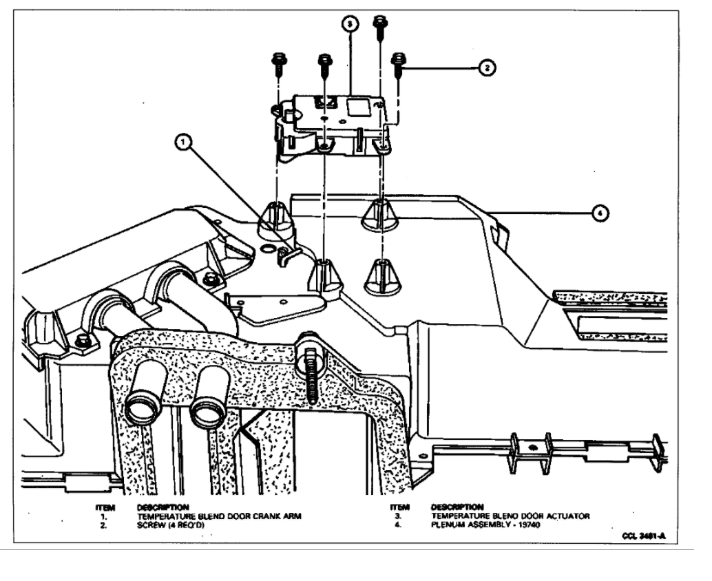

When the air is turning all the way down it still blows out very hot air.

It sounds like you have a temperature blend door actuator that is out.
Here is a guide that will shoe you what you are in for when doing the repair:
Below is what it will be like on your car.
You should be able to get to it from the glove box.
