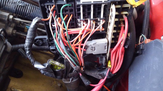

The red wire needs power. Did you check the 50 amp fuse under the hood?
Tuesday, May 21st, 2019 AT 12:20 PM
NATHANHANOVER
  • 23 POSTS
Yes of course: Multiple times. It's quite maddening.

So you have power at the fuse but not the wire? The fuse powers the wire so you must have a bad connection, l use the test light to see where the power stops.

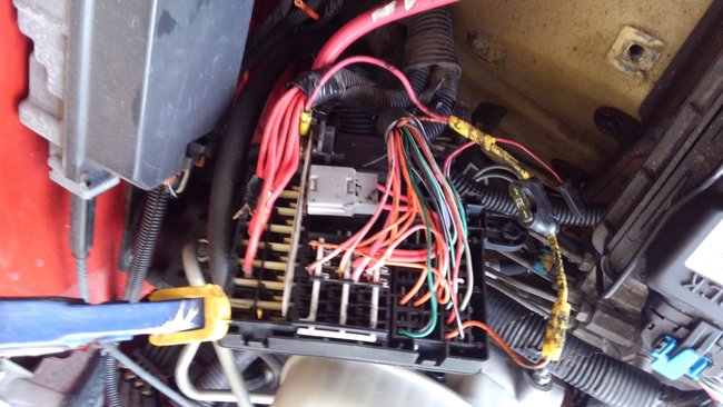

Ken: I found something really Bizzar, a rigged wiring fuse inside the fuse box with a 30 am fuse. Is there a way I can send you a picture of this?

Found it. This connection clip is faulty.
Tuesday, May 21st, 2019 AT 5:41 PM
NATHANHANOVER
  • 23 POSTS
The clip that connects the red wire, power wire under the dash is / was faulty.
