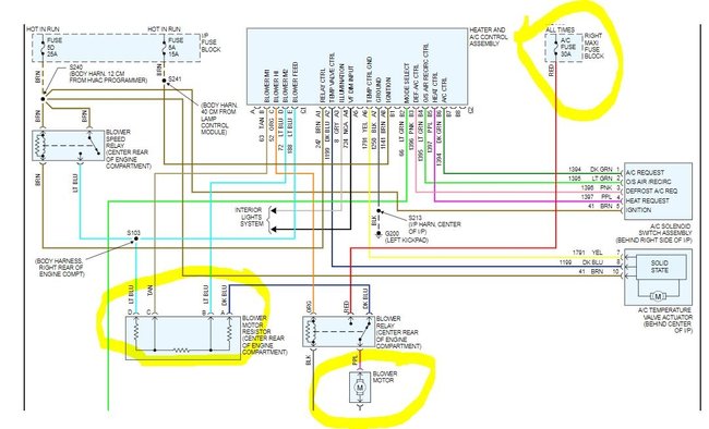

I hat to say it, but I'm not 100% sure. My manual shows a 20amp in one place and a 30amp in another. I would try the 20. If it's too small, the worst thing that can happen is it will blow.

I change the blower and it still does the same thing. It turns on but cuts right off. I am wondering if the blower motor resistor could be bad.
Monday, March 22nd, 2021 AT 11:43 AM (Merged)
STEVE W.
  • 13,573 POSTS
The blower motor is a simple single speed motor controlled by a PWM signal with a feedback line. The blower speed controller is not just a resistor pack in that car it is a pulse width control. In operation it pulses on/off to control the blower speed. The longer it is on the faster the blower turns. A common issue with them is the ground wire getting corroded so they do not have a proper reference to ground and the motor uses the same ground so they will stop working, and bad solder joints inside the module itself.

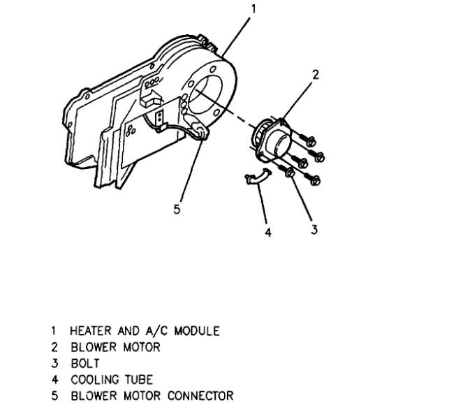

Try replacing the motor first. (plenty available at the junk yards) While it's out check to see if it's good by hot wiring it to the battery. If it is perhaps, your blower module is bad which is an expensive part. Hopefully it's bad and that's all you need to replace.
This guide can help us test it

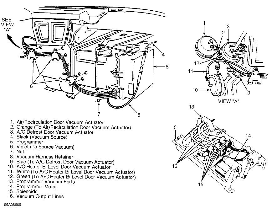

There should be vacuum lines all under the dash you'll have to check each one for being off the motor or leaking. It starts at engine and works it 's way back
+1
Monday, March 22nd, 2021 AT 11:56 AM (Merged)
HMAC300
  • 48,601 POSTS

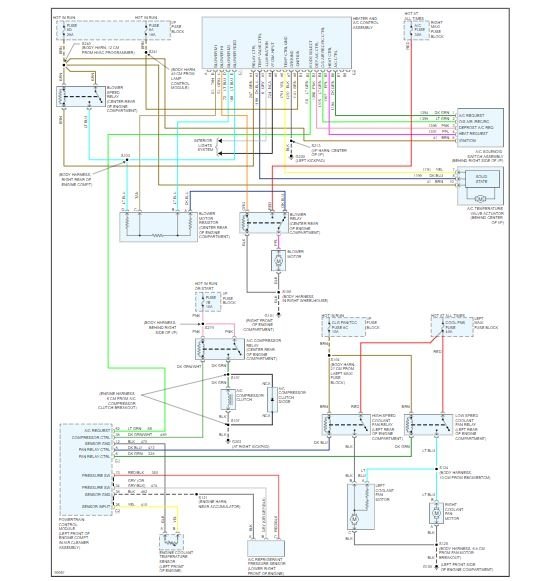

Here is a diagram motors will either be on pass or driver's sides.

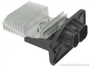

Blower motor will not work.I hook up a direct 12v. To it and it runs.I check relays and they click, fuse's are ok.I took out the blower resister and it shows no signs of excessive heat.I put it back together and the blower work for a short time on med. Speed and stop all together, this is a auto temp control unit. Its getting no power to the blower motor, what can it be? Thanks
Monday, March 22nd, 2021 AT 11:58 AM (Merged)
  • 75,992 POSTS
Your probable causes here could be the blower motor control module at center rear of engine compartment or the Heater/AC programmer behind right side of instrument panel
+2
BILL49
Is this what you call a blower motor control module? It was the problem
https://www.2carpros.com/forum/automotive_pictures/531871_getimagephp_1.jpg
