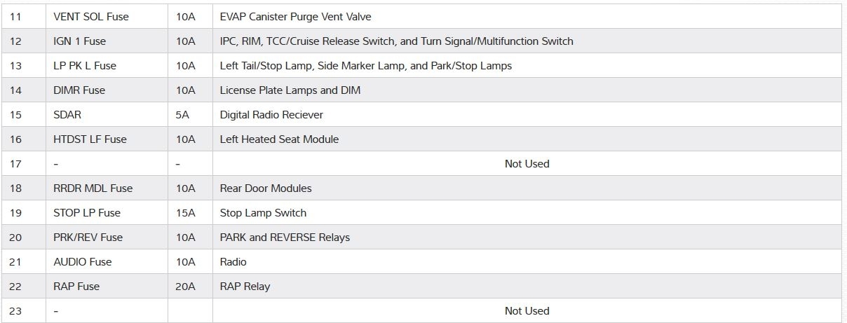

The interior blower fan is not working when you turn it on
2005 BUICK LESABRE
186,357 MILES • 2WD • AUTOMATIC
MLOYD13

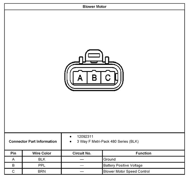

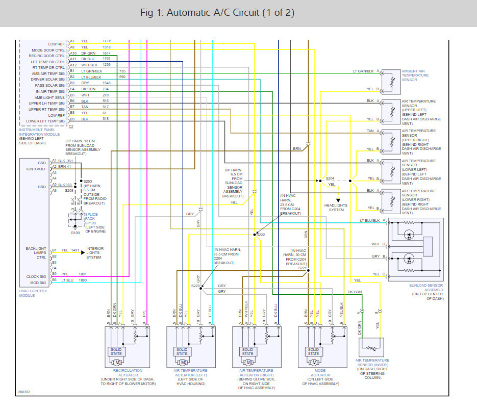

The interior fan is not working when you turn it on. I've checked the fuses and the blower motor. When I removed the blower motor and reattached it to the power supply it worked perfectly but when I place it back into the case it won't work. I've looked for obstructions but found nothing. How can I fix this?
Jul 2, 2019 at 7:37 AM
  • 110,241 POSTS
Welcome to 2CarPros.

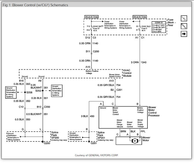

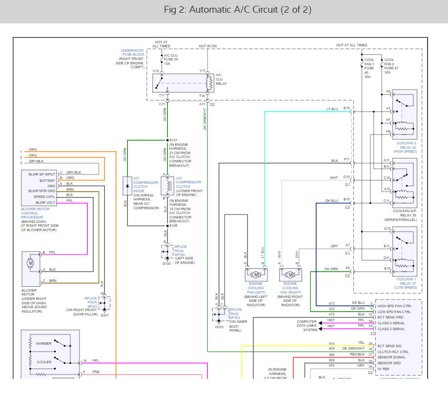

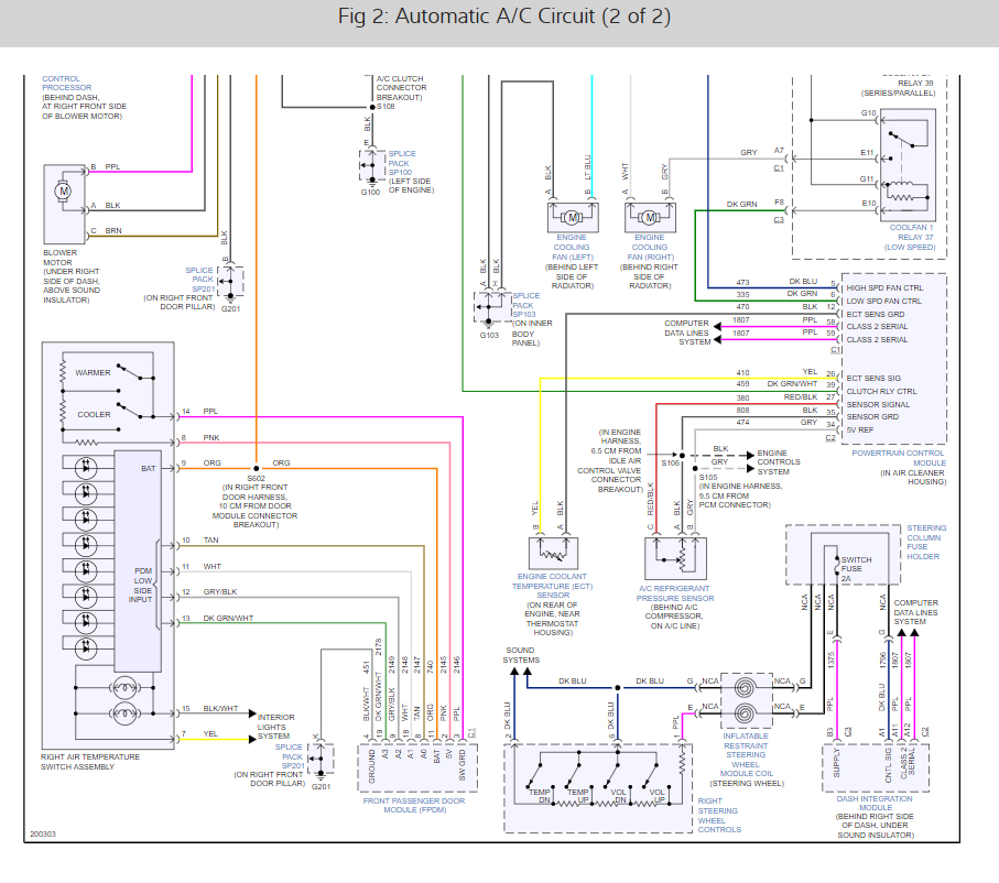

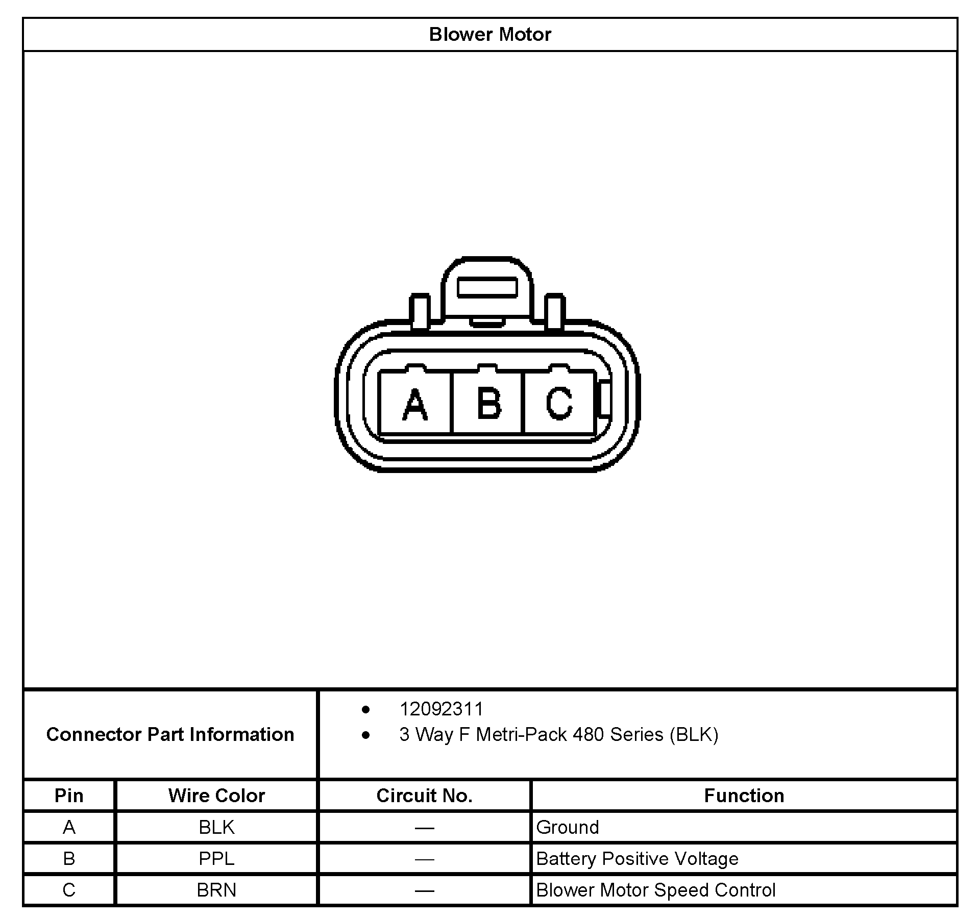

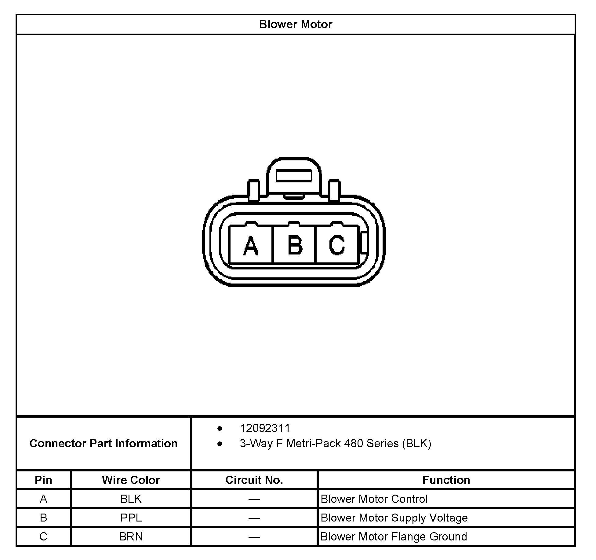

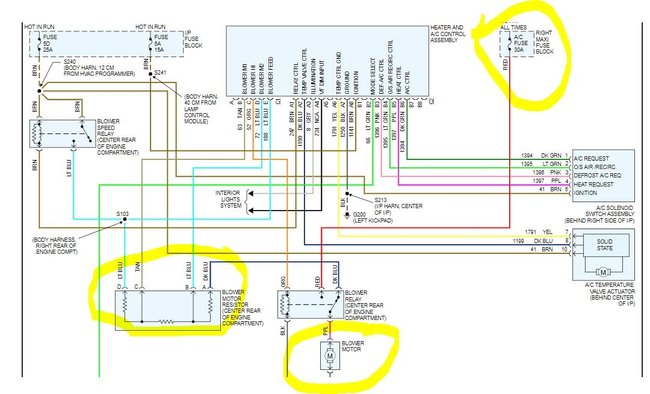

It sounds like a bad connections in the wiring. If you turn it on while installed and move the wiring around to it, does it begin to work? Was the connector in good condition and none of the pins were pushed in? What I would recommend is to disconnect the connections at the fan motor and see if there is power to it. See if moving the wiring around to different positions cause power spikes or loss of power.

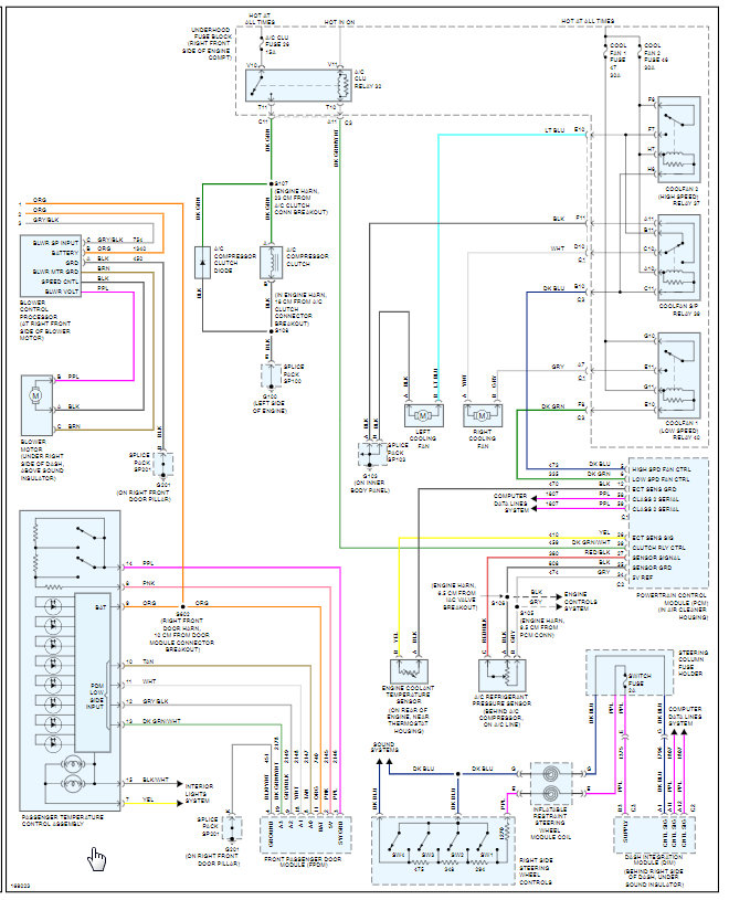

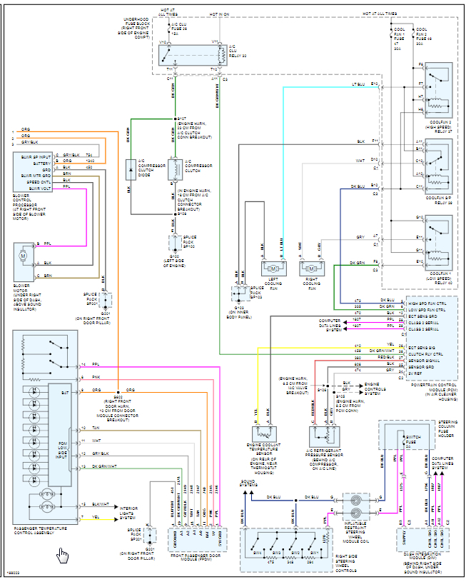

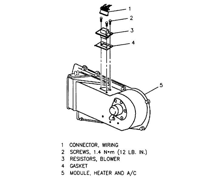

One other thing, if the blower motor only works on high, then suspect the blower motor resistor. I have included the blower motor wiring diagrams so you can see how the system works Let me know.
this guide can help us
https://www.2carpros.com/articles/blower-fan-motor-works-on-high-speed-only

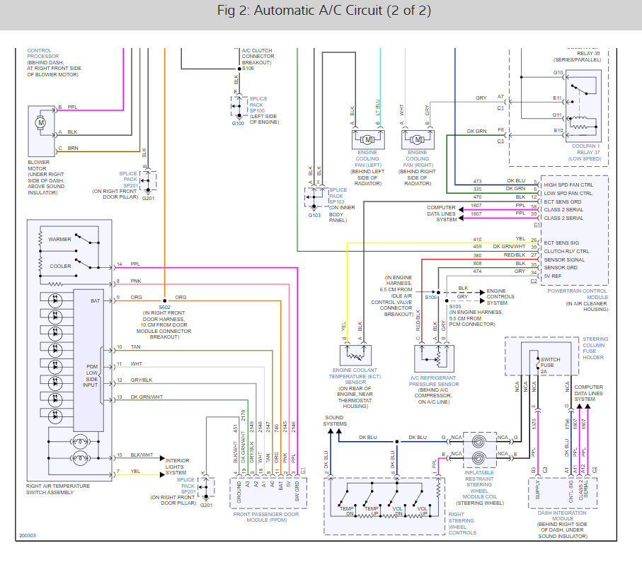

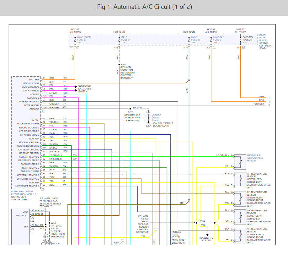

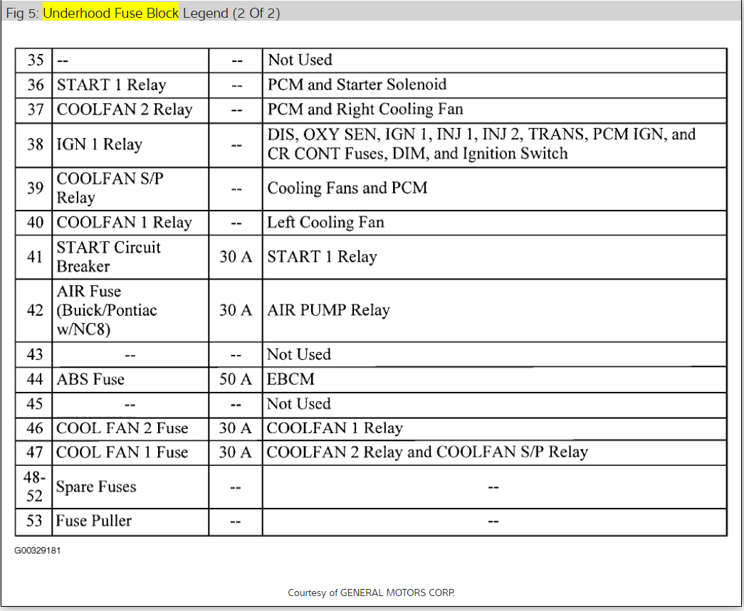

If moving it does nothing, I need you to check for a good ground and power. I attached two pics below. Pic 1 is for manual climate control and pic 2 is for automatic. Check the pins shows (based on your system) for power and ground.
Here are a few links you may find helpful:
Check out the diagrams (Below). Let us know what happens and please upload pictures or videos of the problem.

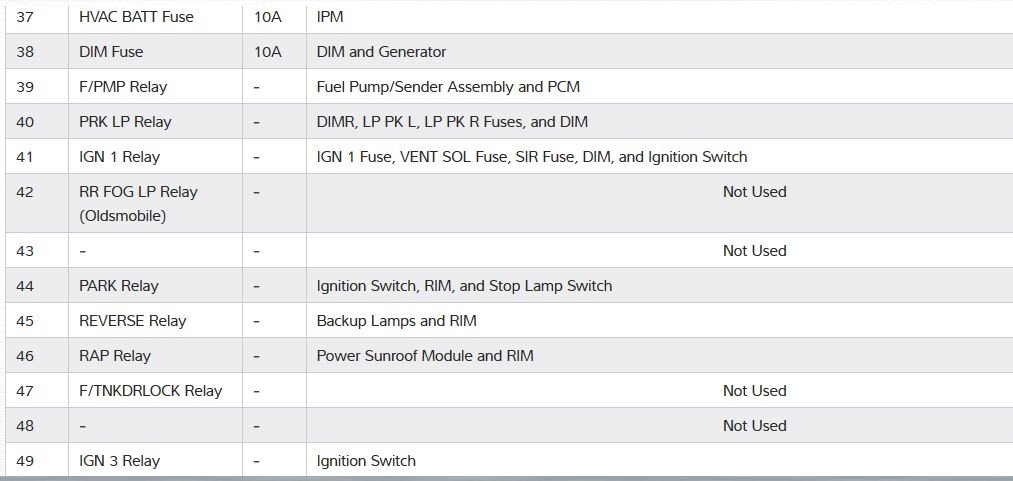

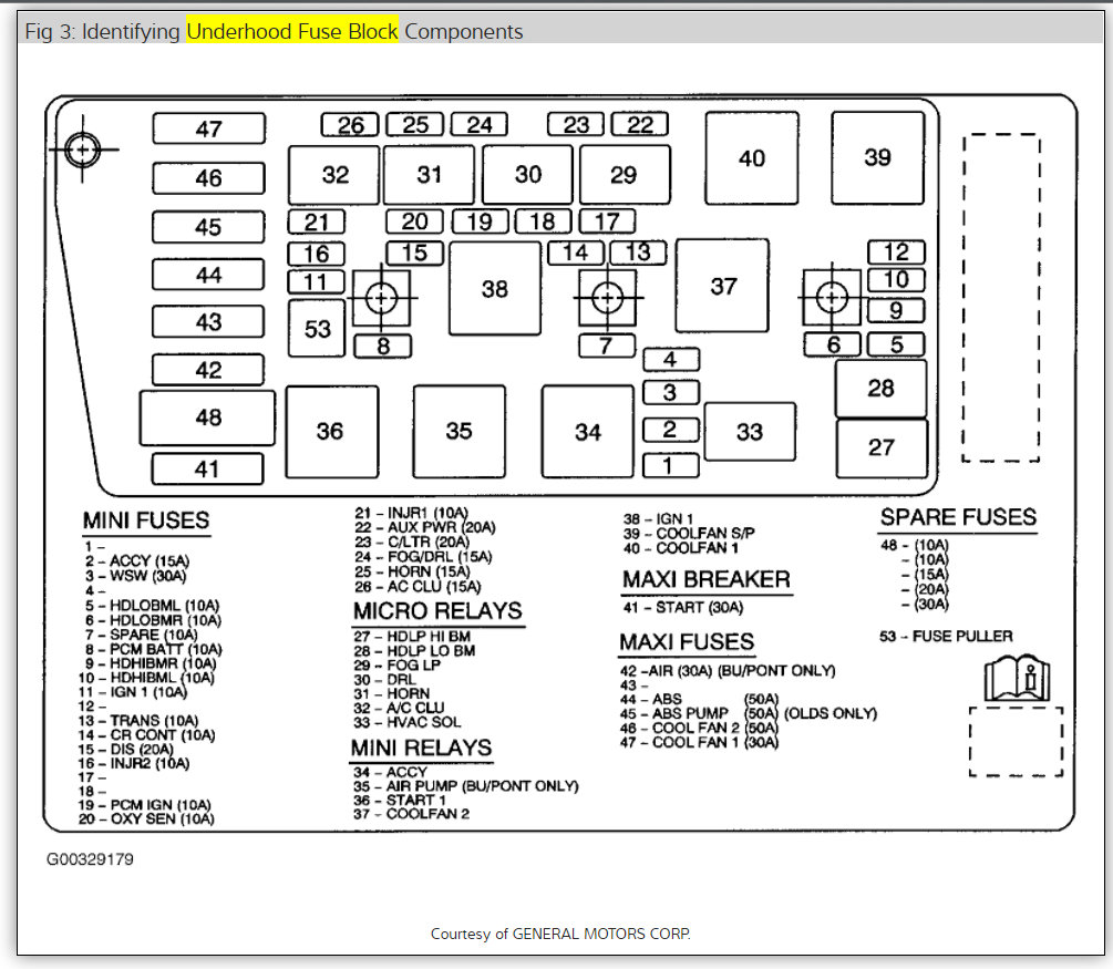

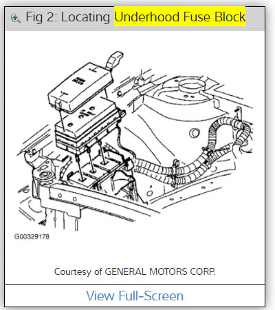

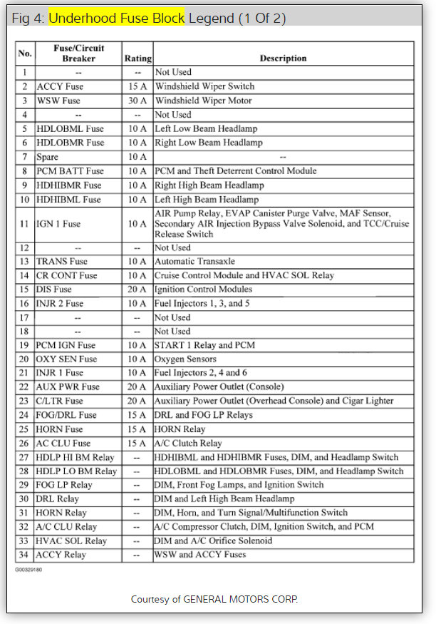

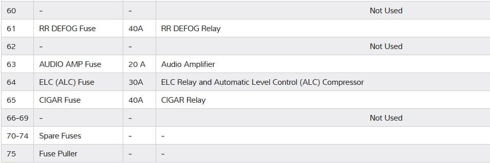

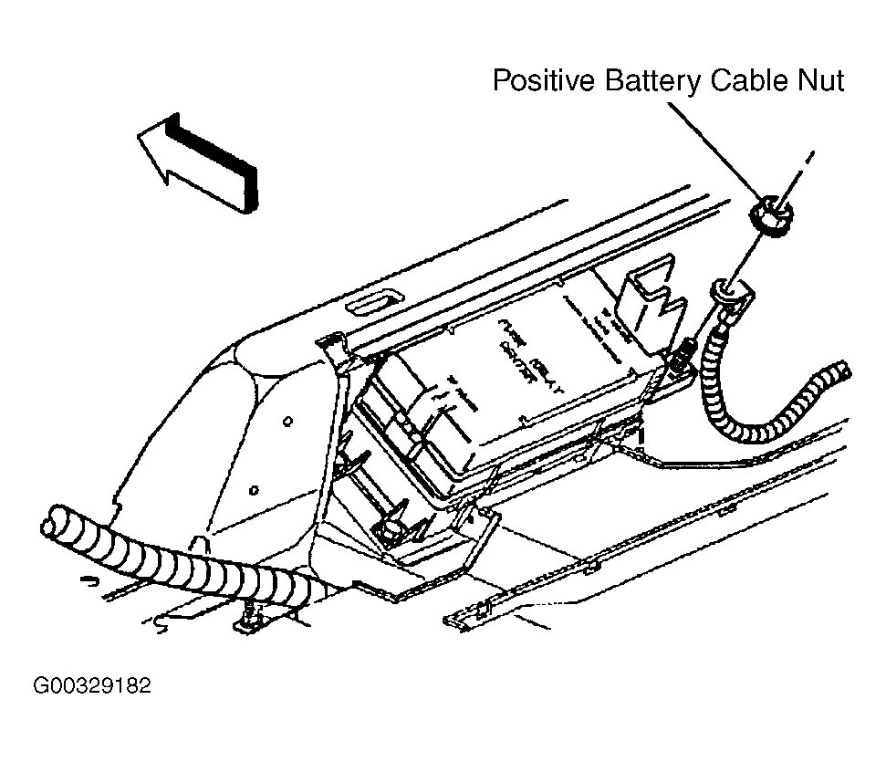

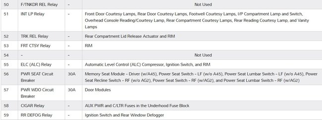

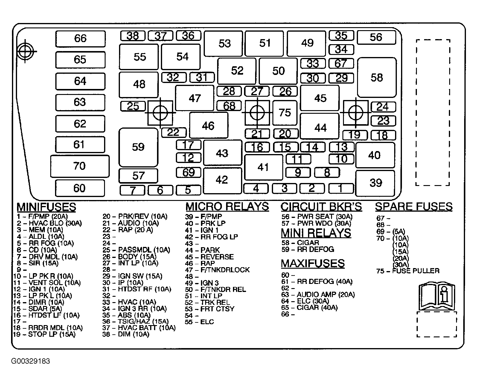

Where are the fuses for the heater-fan located?
Mar 22, 2021 at 4:38 AM (Merged)
HMAC300
  • 48,601 POSTS
your heater blower fuse may be in the underhood electrical center. But there should be a relay as well for it so check that by jus t replacing it with another. if it works then get a good realy and replace it. if not, then have the car checked for a bad switch or resistor. Here is a guide to help you check the fuses with the fuse location is the diagrams below.

JDL
  • 16,098 POSTS

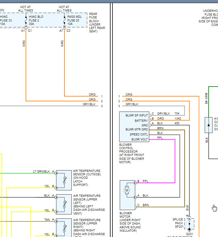

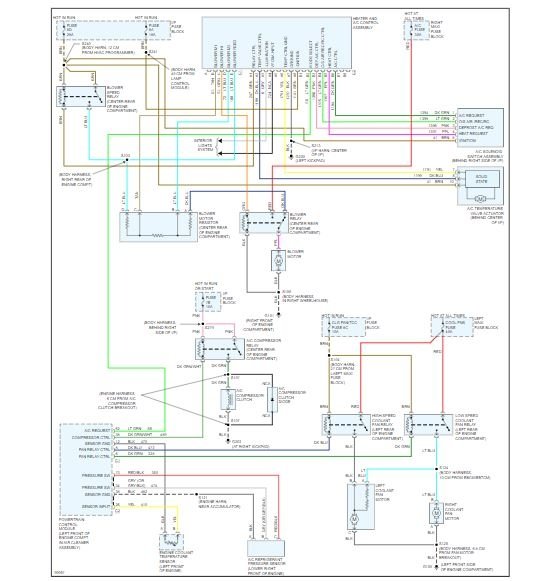

Check for voltage and ground at the blower motor wiring, if good voltage and ground with no blower action, suspect the blower motor.
Checking applicable fuses is good. Also, check for voltage at the fuse.
Here are the locations and a guide to help you test
All fuses and relays are below with the wiring diagrams to help you test
Please run this test and get back to us.
Cheers
Mar 22, 2021 at 4:39 AM (Merged)
WILLIE N
Yep it was the blower motor I found this guide which helped
Once I replaced the blower motor everything is now working thanks for the diagrams.

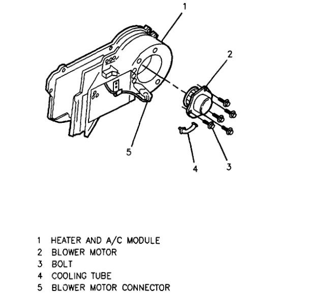

It sound's like you could have a bad blower motor or loose connection.On the passenger side under the dash remove the hush panel that cover's the a/c box.Then put the fan on high when the fan doesn't work try wiggling the connector around that goes to the blower motor see if the fan come's on.

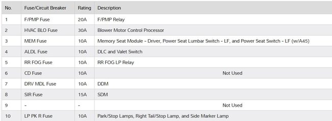

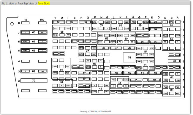

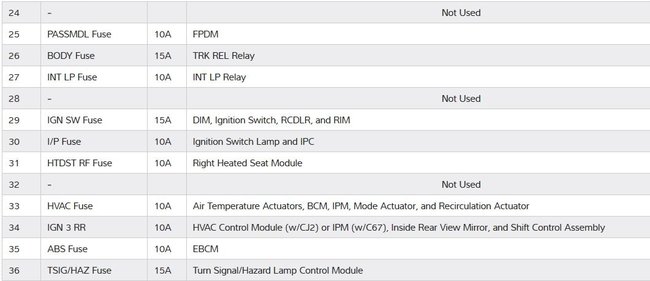

HARRY P
  • 2,292 POSTS

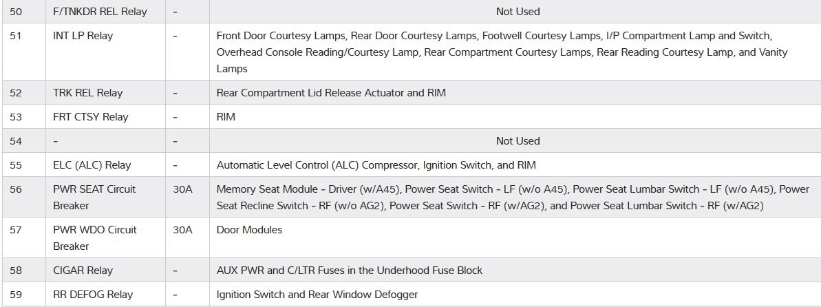

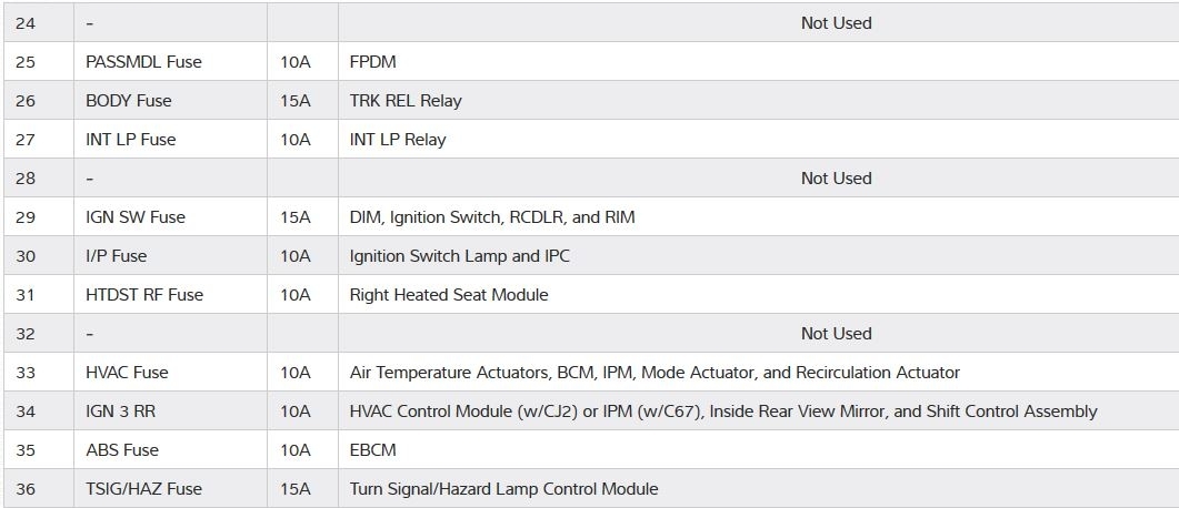

I would start with checking he fuses. Here is the fuse box information for the rear fuse box. Prodemand is not real specific on where it is, so you might have to look in your owner's manual for more specifics. I would check every HVAC related fuse.
Mar 22, 2021 at 4:43 AM (Merged)
PATENTED_REPAIR_PRO
  • 1,853 POSTS
The rear fuse block is under the left rear seat.

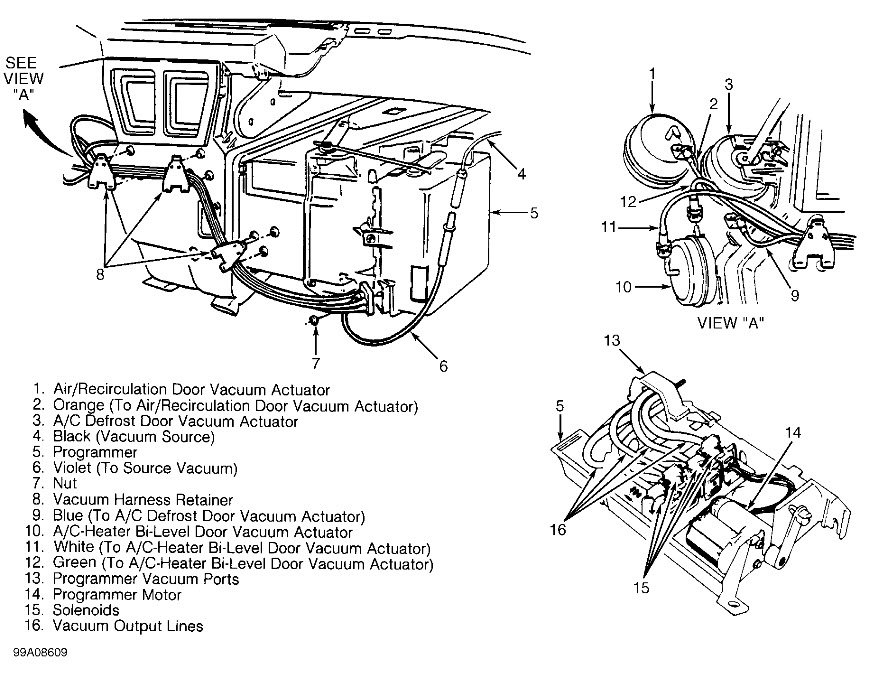

where is the vacuum located?
Mar 22, 2021 at 4:56 AM (Merged)
HMAC300
  • 48,601 POSTS
there should be vacuum lines all under the dash you'll have to check each one for being off the motor or leaking.it starts at engine and works it 's way back
HMAC300
  • 48,601 POSTS
here is a diagram motors will either be on pass or driver's sides.

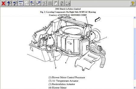

BILL49
blower motor will not work.i hook up a direct 12v. to it and it runs.i check relays and they click,fuse's are ok.i took out the blower resister and it shows no signs of excessive heat.i put it back together and the blower work for a short time on med. speed and stop all together,this is a auto temp control unit. its getting no power to the blower motor,what can it be? thanks
Mar 22, 2021 at 4:58 AM (Merged)
  • 75,992 POSTS

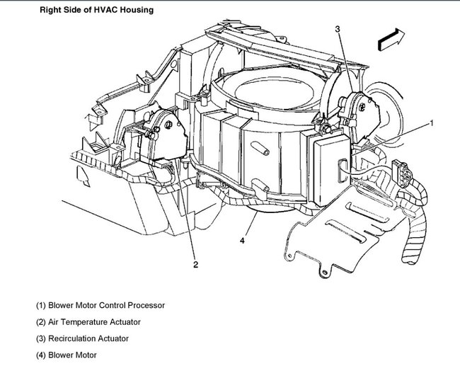

Your probable causes here could be the blower motor control module at center rear of engine compartment or the Heater/AC programmer behind right side of instrument panel
BILL49
Is this what you call a blower motor control module? It was the problem
https://images.2carpros.com/forum/automotive_pictures/531871_getimagephp_1.jpg

It could be many things. Start by checking the blower motor itself. When it isn't working, see if there is power to it. If there is and it isn't working, chances are the motor is going bad. Also, check for bad grounds. Finally, you may need to have the head unit itself checked. Since it has an automatic climate control, it works like a computer and can go bad. You could check to see if there are trouble codes stored in the computer that may identify the problem.
