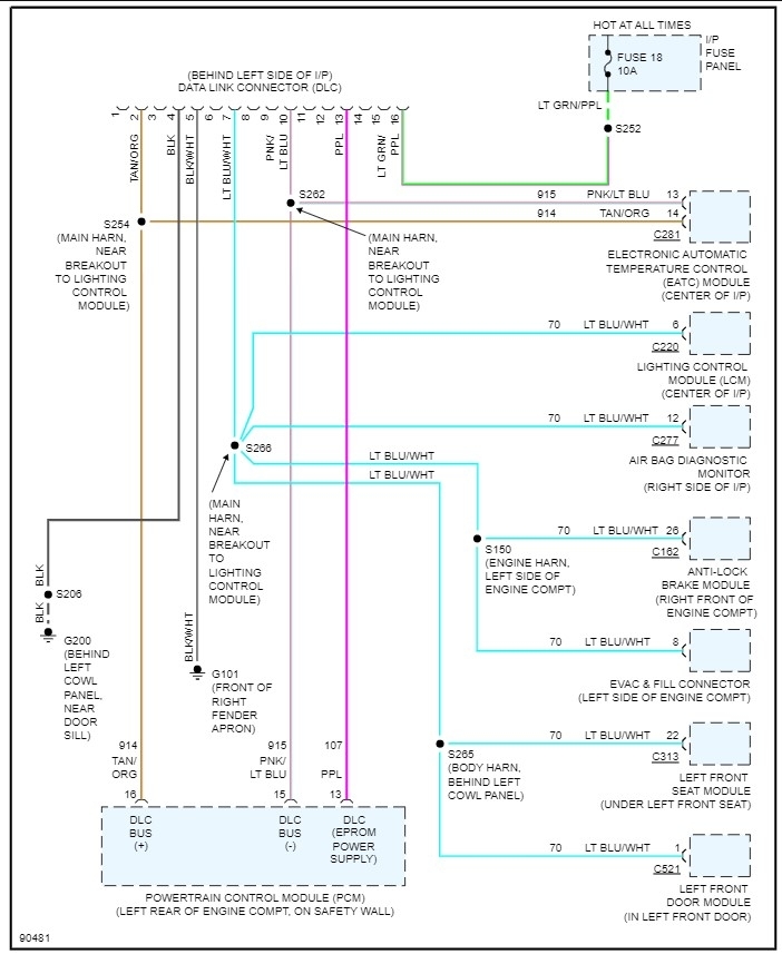

It is possible that the speed control module that was replaced was a defective part. There also could be a fault within the Electronic Automatic Temperature Control (EATC) module or between the connector and the module that may be causing the erratic operation.
If any fault codes have been stored, you may be able to display them by pressing the “off” and “floor” buttons on the EATC module at the same time, then releasing them and within 2 seconds pressing the “recirculate” button. Please take note of any codes stored. If you press “front defrost” this should clear the codes but not necessarily remove the fault.
You could also check the connector at the back of the EATC module for any corrosion or bent pins.
If you check resistance on the circuit between the data link connector, tan wire with orange stripe, and the EATC module connector, pink wire with light blue stripe, there should be less than 5 ohms of resistance.
Next, you can check resistance between the data link connector, pink wire with light blue stripe, and the EATC module connector, tan wire with orange stripe. There should be less than 5 ohms of resistance in this circuit as well.

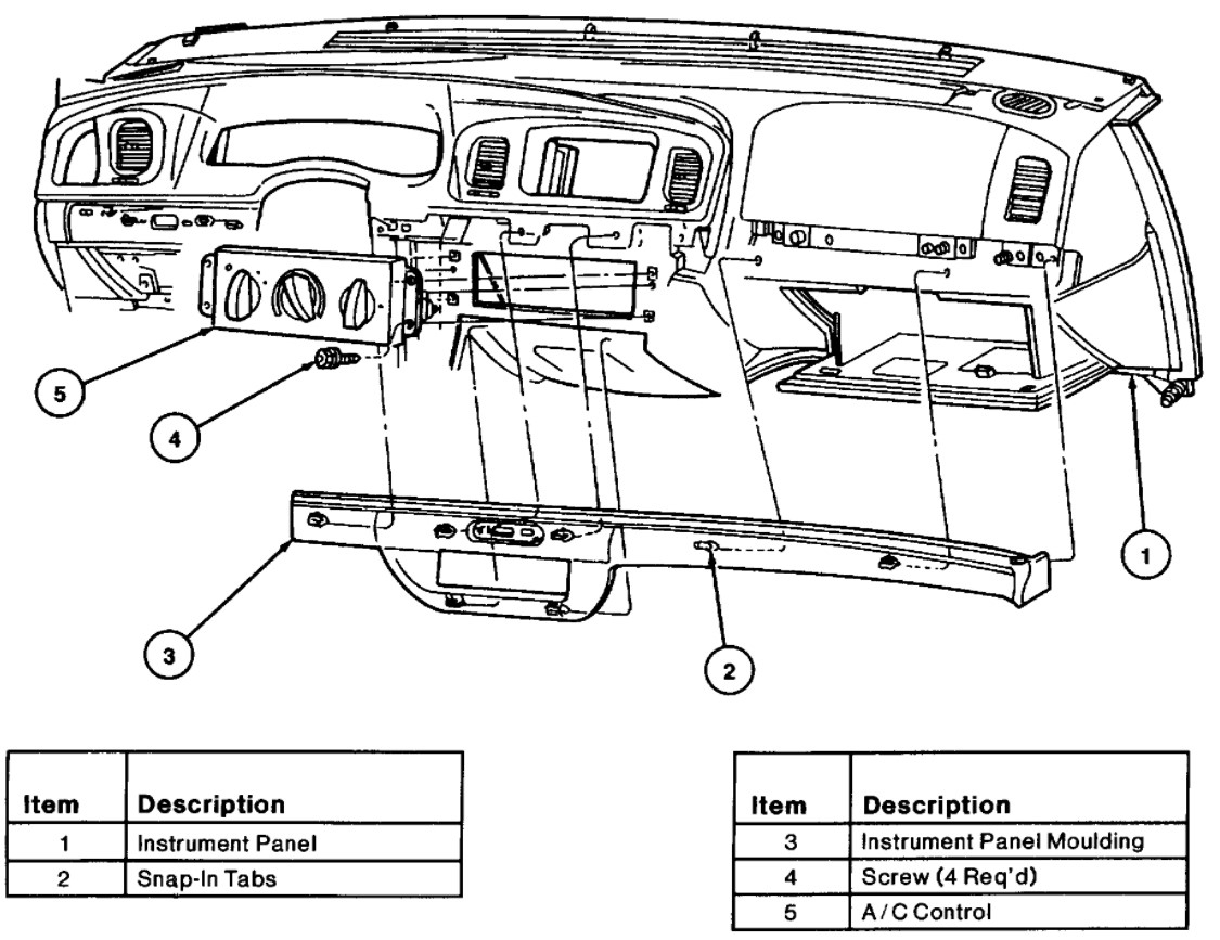

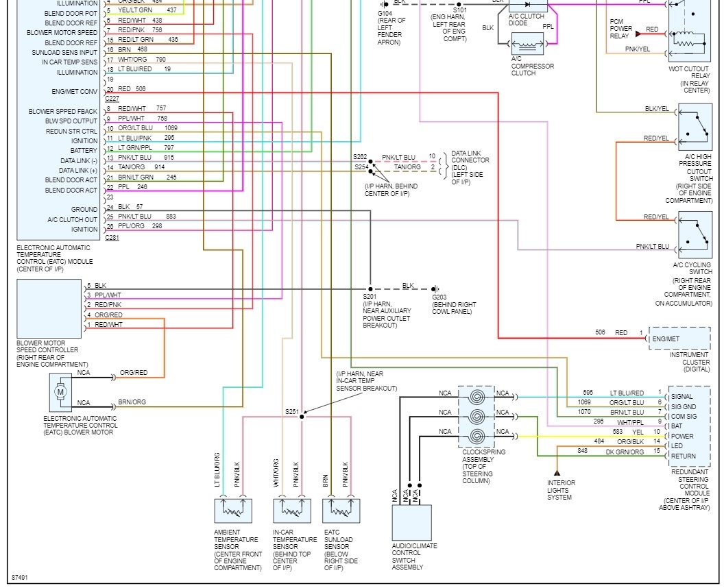

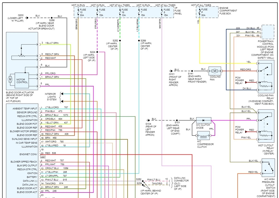

Please check out the diagrams I've attached (below) for the air conditioning system. It's in two parts to help make it easier to read. I've also attached a schematic for the computer data lines and diagram that may help if the EATC module needs to be removed.
