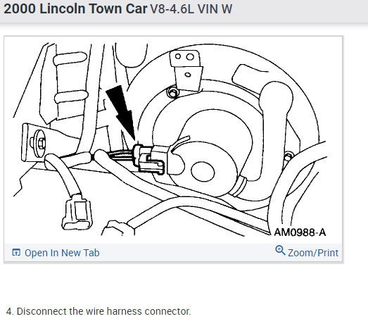

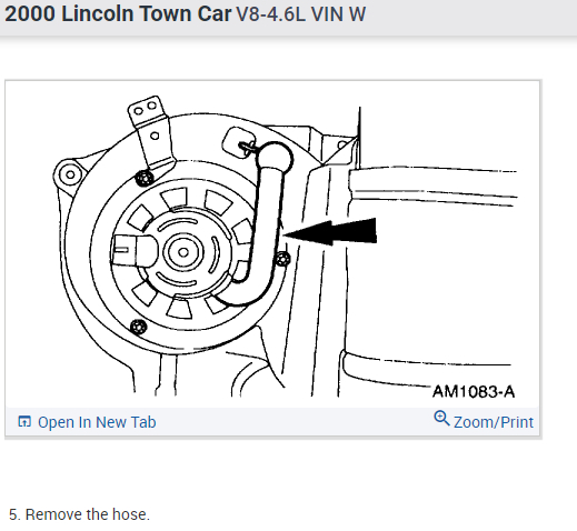

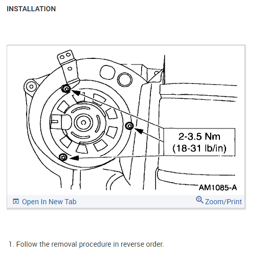

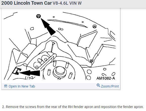

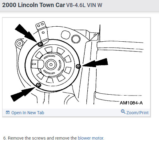

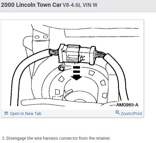

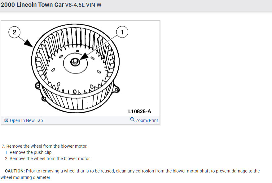

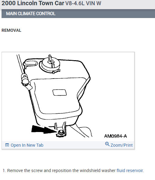

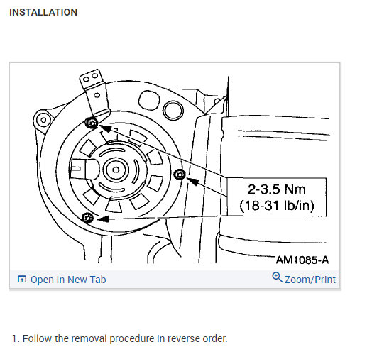

Please see the attached replacement procedure for the blower motor.
