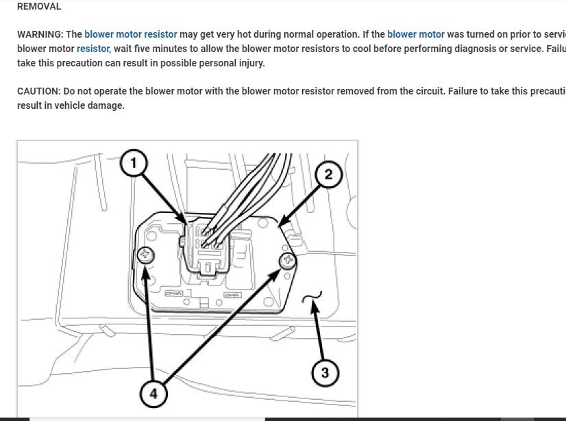

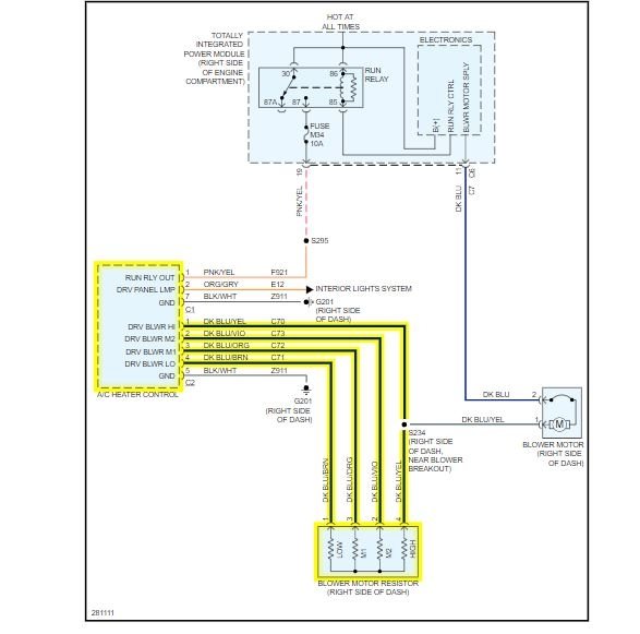

The blower resistor is what controls the speeds. I attached a picture and a procedure for you. It is behind the glove box. Check out the diagrams (Below). Please let us know if you need anything else to get the problem fixed.

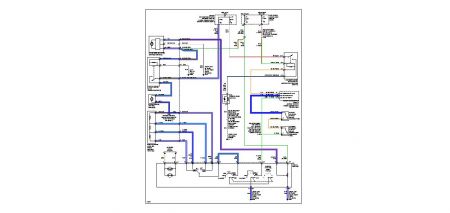

If you can do 2/3 why not the blower motor-go find it and splice into the dark green wire on it-and power it from the battery positive terminal see if it comes On-make sure the fan switch is on. Let me know If unreadable give me your email addy
https://images.2carpros.com/forum/automotive_pictures/12900_blower_motor_7.jpg
Dec 30, 2020 at 3:35 AM (Merged)
BLUEDOG222
Hey thanks for the response!!
Cant read the image though, try sending it to msullivan222@gmail.com.
Thanks again!
  • 75,992 POSTS
Will do sending it now
