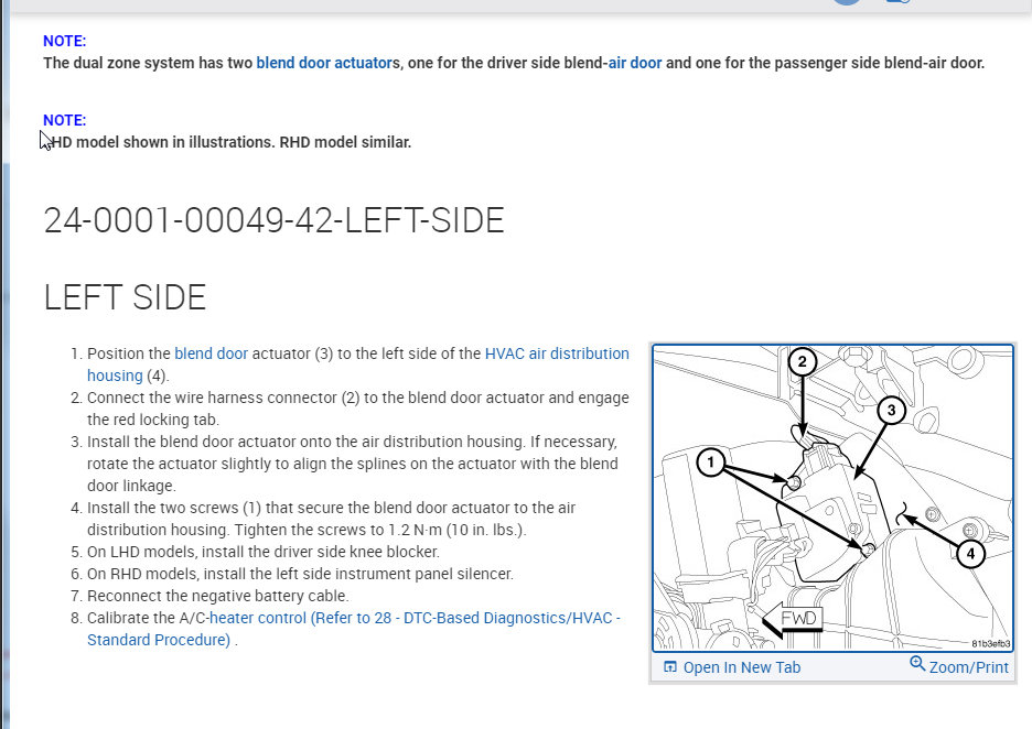

i replaced drivers side blend door and when done the blinking started every time i cold start car. i now know it's running a cal. test. but after 3 months of this i now am hearing clicking like before and it is running test twice now. is there any way pushing different buttons i can stop this tests? where should the controls be when i put new one in? all posts i see have different dash controls than mine they say turn key on and press recirculate button and power button same time but on my car they are both on middle dial power and recirculate if pushed so do i just push ? please help this is my 88 year old mothers car and is needed and can't afford to go to dealer. thanking you in advance, Mike

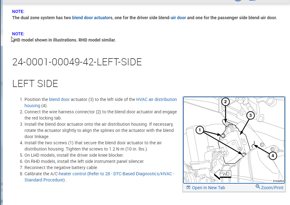

Okay, from your description you replaced the blend door actuator and it started doing the self test, now that blend door actuator is bad again and it is now cycling the test. Those are both likely due to the system not being calibrated to the new actuator when it was installed. That process requires a scan tool to erase the stored information and the system then learns the information from the replacement actuator. It runs the test because it is getting the wrong signals from the replacement part. With it clicking now I think it will need to be replaced again as the clicks are commonly caused by the plastic gearing inside failing.
Here is a guide to help you step by step with instructions in the diagrams below to show you how on your car.
Once it is replaced and a scan tool used to calibrate it, and erase any stored trouble codes from the HVAC module all of the clicking and lights should cease. Unfortunately there is no way to do the calibration on that system without a scan tool. Some others can be done without one but not that system. Check out the diagrams (Below). Let us know what happens and please upload pictures or videos of the problem.
Aug 25, 2020 at 12:13 AM
A clicking by the actuator is due to the plastic gears slipping. This is typical of one that has failed. The calibration is due to it needing to find its location so I would suggest putting the temp to full hot or full cold with the new actuator plugged in but not installed yet. This will cause the actuator to go to its full travel. Then manually hold the door in this position when you install the actuator and they will be aligned. Otherwise you may have them out of sync and it can cause them to wear out.
Otherwise you will need to have the calibration process run with a scan tool. The process that you are talking about doesn't actually run the calibration. It is just a reset process that people have had success in getting the light to stop flashing due to it running a calibration during the reset process. However, it does this every time you start the vehicle which is what the flashing button means. So that means we need replace the clicking actuator and then install as described above and when it runs the calibration it should learn the position and stop flashing.
Let us know what questions you have. Thanks

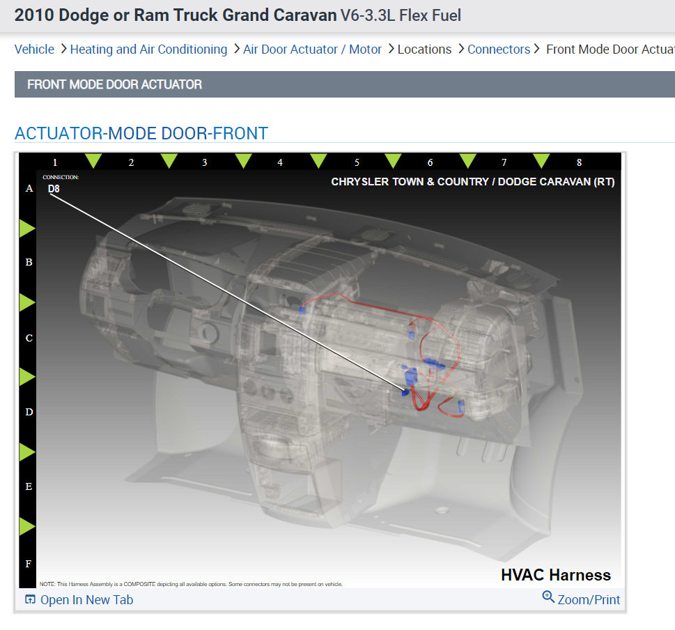

Every time I unlock the vehicle it knocks behind the glove box. I was wondering how many air door actuators there are and if they are easy to change.

Good afternoon,

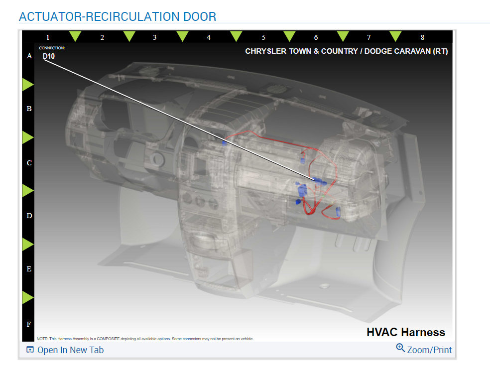

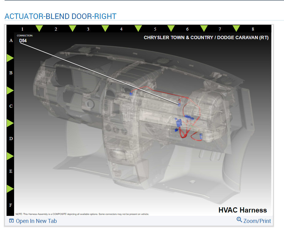

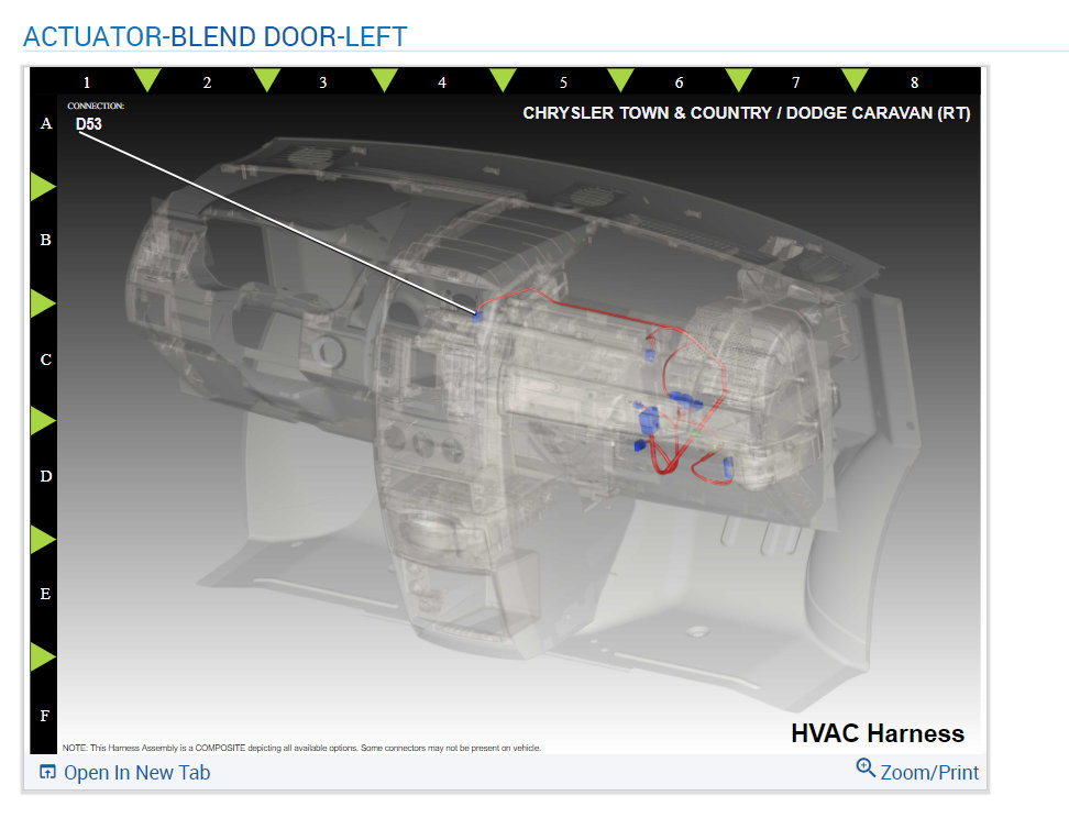

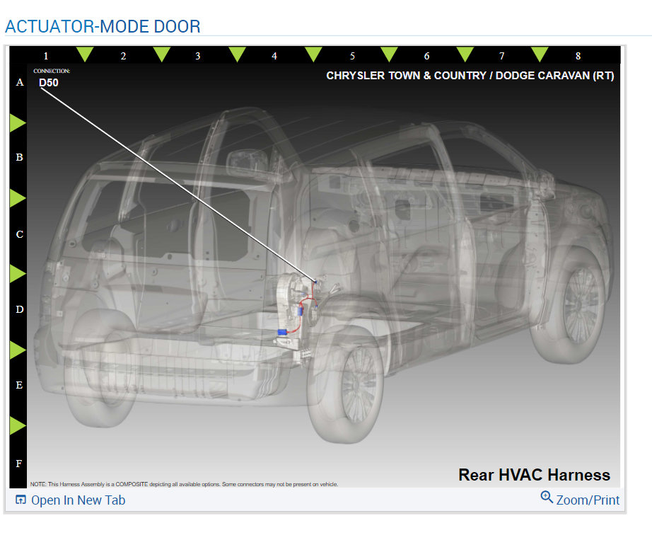

Does this happen with the ignition off? There should be no power to the actuators without the key on. There are three. A blend door, mode door and re-circulation motor. Check out the diagrams (Below). Let us know what happens and please upload pictures or videos of the problem.

Hi Roy, so when I unlock the doors it starts knocking like it needs to be in a certain position I just can in and got it to do it. I think it’s the one behind the heater core.
Jan 15, 2021 at 3:59 AM (Merged)
ZIGGEE66
  • 8 POSTS
Yes, it does it with the ignition off such as when I unlock the doors.
Can you check under the dash and see if you can feel it to see if it is an actuator?
Do all the controls work correctly?

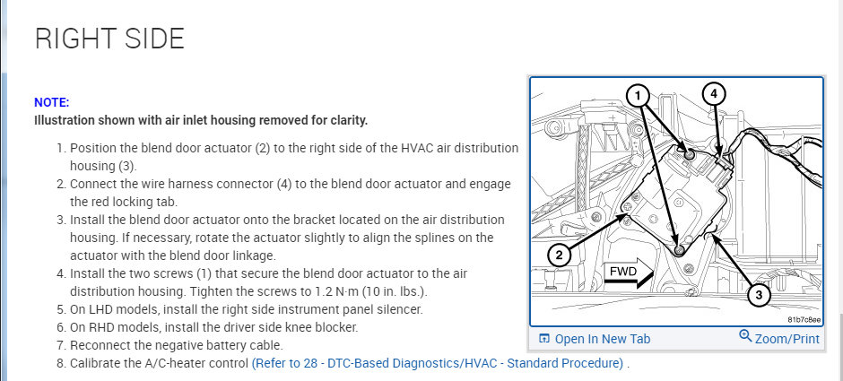

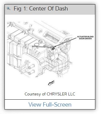

TDUFFYIOWA

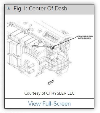

Where is the drivers side door blend actuator located, how much dash has to come out?
THIS IS MIKE
  • 686 POSTS
The blend door is under the dash. You will have to disconnect the negative side of the battery before you start. Then remove any silencers or covers. The dash will not have to be removed. The blend door actuator is located on the left side of the HVAC unit under the dash.

Got it.

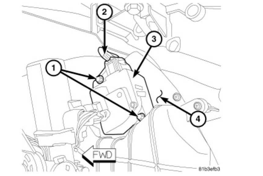

Below is the procedure with a picture attached for the actuator.
1. Disconnect and isolate the negative battery cable. See: Battery > Service and Repair
2. Remove the driver side knee blocker. See: Dashboard / Instrument Panel > Service and Repair
3. Remove the two screws (1) that secure the blend door actuator (3) to the driver side of the HVAC air distribution housing (4) and remove the actuator from the housing. See: Air Door Actuator / Motor, HVAC > Service and Repair
4. Disengage the red locking tab and disconnect the wire harness connector (2) from the blend door actuator and remove the actuator from the vehicle.
