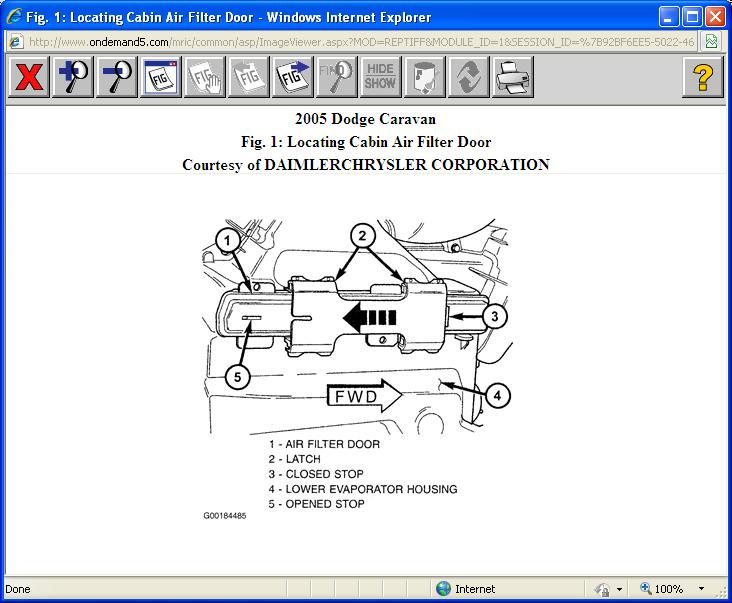

Locate door at evaporator housing slide door to rear till it engages opened stop.Pull downward .pull out filter (note: This is an option and some cars don't have a cabin filter.)
https://images.2carpros.com/forum/automotive_pictures/198357_Graphic_7.jpg
https://www.2carpros.com/articles/how-to-change-an-air-cabin-filter Please let us know if you need anything else to get the problem fixed.

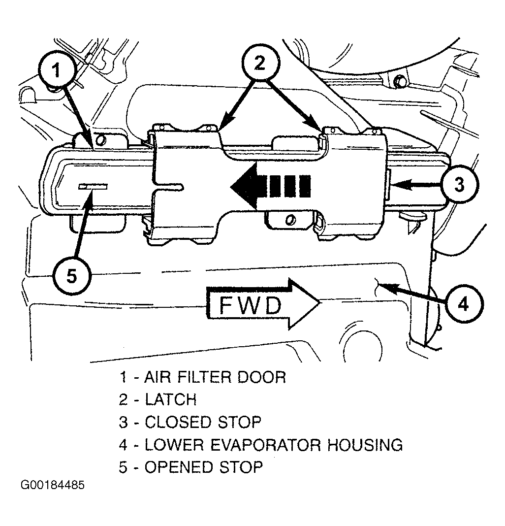

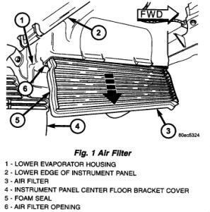

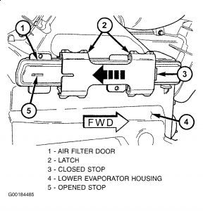

Here is what I found to show you how to replace your cabin air filter. 1.Locate the air filter door on the bottom of the lower evaporator housing just outboard of the passenger side of the instrument panel center stack. 2.Slide the air filter door latch toward the rear of the vehicle until it engages the opened stop on the door. 3.Pull the air filter door latch straight downward to disengage it from the air filter opening of the lower evaporator housing. 4.Use your fingers to reach through the air filter opening of the lower evaporator housing far enough to grasp the air filter. 5.Pull the air filter straight down and out of the evaporator housing.
https://images.2carpros.com/forum/automotive_pictures/99387_Graphic1_293.jpg
https://images.2carpros.com/forum/automotive_pictures/99387_Graphic2_135.jpg
Here is a guide that should help as well. https://www.2carpros.com/articles/how-to-change-an-air-cabin-filter Please let us know happens so it will help others.

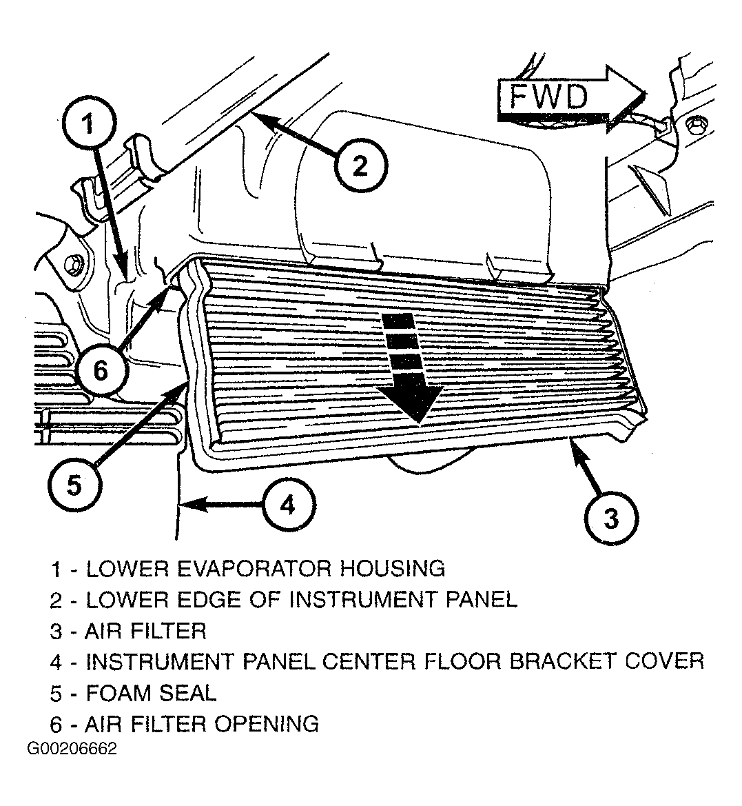

Hello - Removal
https://images.2carpros.com/forum/automotive_pictures/248015_Air_1_1.jpg

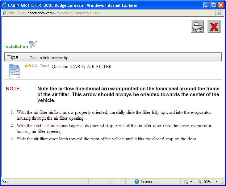

Locate the air filter door on the bottom of the lower evaporator housing just outboard of the passenger side of the instrument panel center stack. Slide the air filter door latch toward the rear of the vehicle until it engages the opened stop on the door. Pull the air filter door straight downward to disengage it from the air filter opening of the lower evaporator housing. Use your fingers to reach through the air filter opening of the lower evaporator housing far enough to grasp the air filter.
https://images.2carpros.com/forum/automotive_pictures/248015_Air_2_1.jpg
Pull the air filter straight down and out of the evaporator housing. INSTALLATION Note the "Airflow" directional arrow imprinted on the foam seal around the frame of the air filter. This arrow should always be oriented towards the center of the vehicle. With the air filter "Airflow" arrow properly oriented, carefully slide the filter fully upward into the evaporator housing through the air filter opening. With the latch still positioned against its opened stop, reinstall the air filter door onto the lower evaporator housing air filter opening. Slide the air filter door latch toward the front of the vehicle until it hits the closed stop on the door.

Locate air filter door pass side below evap case see diagrams
Mar 21, 2018 at 4:47 AM (Merged)
DOCFIXIT
  • 18,828 POSTS
diagram

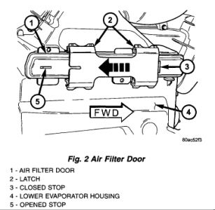

BMRFIXIT
  • 19,053 POSTS
Locate the air filter door on the bottom of the lower evaporator housing just outboard of the passenger side of the instrument panel center stack. Slide the air filter door latch toward the rear of the vehicle until it engages the opened stop on the door. Pull the air filter door latch straight downward to disengage it from the air filter opening of the lower evaporator housing. Use your fingers to reach through the air filter opening of the lower evaporator housing far enough to grasp the air filter. Pull the air filter straight down and out of the evaporator housing. Installation NOTE:Note the airflow directional arrow imprinted on the foam seal around the frame of the air filter. This arrow should always be oriented towards the center of the vehicle. With the air filter airflow arrow properly oriented, carefully slide the filter fully upward into the evaporator housing through the air filter opening. With the latch still positioned against its opened stop, reinstall the air filter door onto the lower evaporator housing air filter opening. Slide the air filter door latch toward the front of the vehicle until it hits the closed stop on the door.

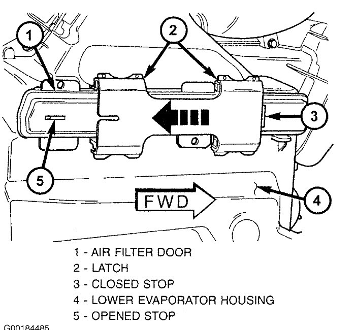

BMRFIXIT
  • 19,053 POSTS
Not all equipped with cabin air filter
