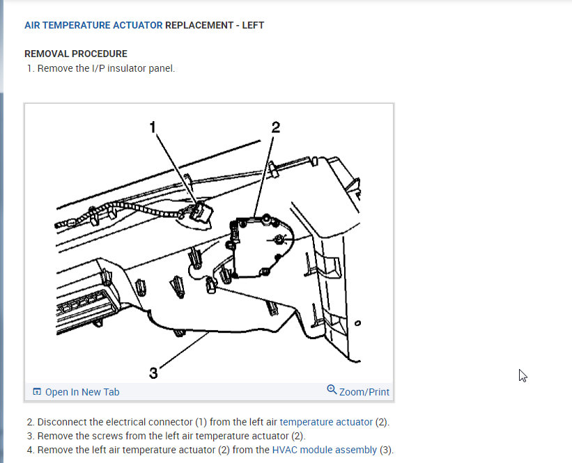

I found your video on YouTube on how to replace the actuator for the drivers side temperature control.
https://www.youtube.com/watch?v=Eqf-H3COtSo
This is the same as my GMC. It is on the passenger side lower dash by your feet.I had no problem replacing it and the new one worked fine for about three minutes. I changed it from hot to cold then left it on cold. Drove away and it switch back to hot without me changing the slider control for the temperature. It seems now I have burn up two of them. I put the original back in so I can manually change it as needed with a screw driver. Any idea? The slider switch maybe?
Feb 11, 2017 at 8:19 AM
I think you just got a faulty actuator. I would think something different if this exact same thing didn't happen to me. Straight out of the box it was fine, then my sister in law calls me 20 minutes into her trip home and says it is clicking. I would replace it again and I suspect it will be just fine.
I attached the manual process for your review or others if they visit the site.
Also, here is a guide that will help as well:
Let us know if you have other questions. Thanks

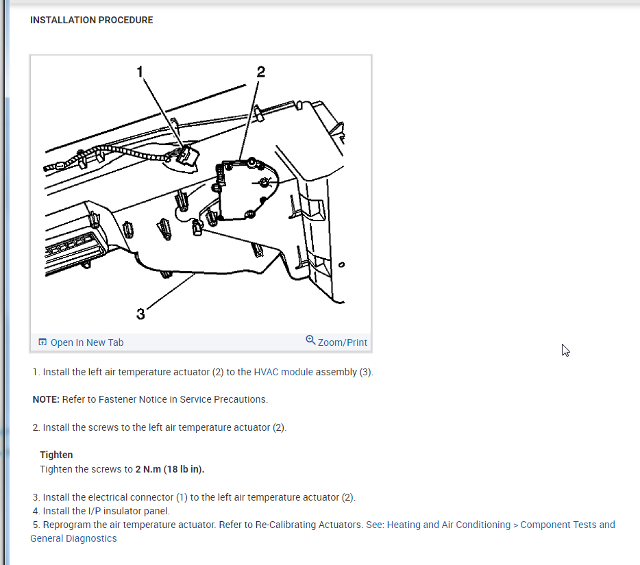

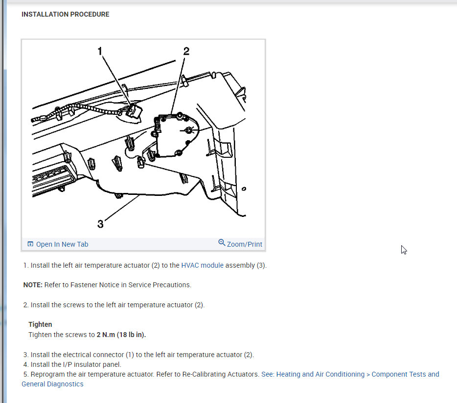

WLDBIL1
I just got a new A/C door actuator but when I hooked it up, it does'nt seem to work and I still get hot air out the middle dash vent and cold air out the passenger vent when the A/C is turned on.
Dec 18, 2020 at 12:24 AM (Merged)
BRIAN 1
  • 1,030 POSTS
because the actuator has to be re calibrated.try this first,Clear all DTCs.
Place the ignition switch to the OFF position.
Install the HVAC actuator.
Connect all previously disconnected components.
Remove the HVAC/ECAS fuse for a minimum of 10 seconds .
Install the HVAC/ECAS fuse.
Start the vehicle.
Wait 40 seconds for the HVAC control module to self-calibrate.
Verify that no DTCs have set as current DTCs.
This guide should help us fix the problem as well.

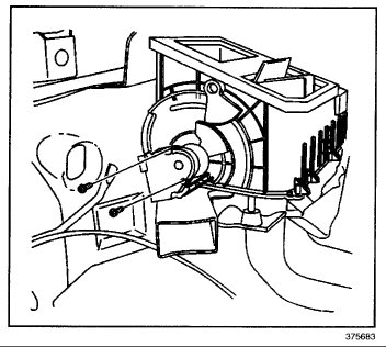

I need to figure out what the blend door on passenger side of truck, accessible by removing lower plastic cover that sits directly above feet when sitting in passenger seat, actually does.
I removed mine, then plugged the new one in before mounting it. I turned on the ignition and watched as the metal cylinder rotated to far left or right position. I turned off the ignition then turned it on again then moved temperature dial but got no movement of the dial/cylinder. Then i tried the vent mode and adjusted it to feet, mid vent, then defrost but no movement, then tried AC, all speeds on the fan, and still no movement of the cylinder. It's either stuck in the far left position or could it be damaged/malfunctioning?
When i turn the knob/rod blend door motor attaches to i can hear opening and closing of a door. It basically clanks against the side of duct system.
While blend door motor is out or not functioning i am able to get hot or cold air depending on dial position so it doesn't seem to be for temp. Or am i wrong on this?
Could this door be for something else? Could it have been installed even though i do not have separate passenger and drivers heat controls. (only have one dial for entire vehicle)
I wonder if this is the same system installed into Denali SUV that has dual controls for temperature.
Any help would be much appreciated.
Also, how can i adjust cylinder position so i can re-install blend door motor? The cylinder is not lining up with the two sided shaft that goes into blend motor.
Dec 18, 2020 at 12:25 AM (Merged)
HMAC300
  • 48,601 POSTS
you should not have turned the key on with blend door actuator out try lining up now then turn key on and pull HVAC fuse inside truck for sixty seconds then reinstall it may reset if not then you need another actuator.

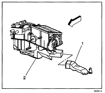

I have got the old one out and I am having trouble getting the new one in. Thanks.

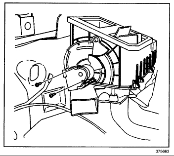

  • 110,241 POSTS

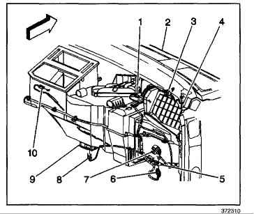

Here are the directions for removal and replacement of the component direct from Alldata. Let me know if it helps.
___________________________________________________
2002 GMC Truck C 1500 Truck 2WD V8-4.8L VIN V
Vehicle » Heating and Air Conditioning » Air Door » Air Door Actuator / Motor » Service and Repair » HVAC System - Manual » Mode Actuator Replacement (W/ D07)
MODE ACTUATOR REPLACEMENT (W/ D07)
REMOVAL PROCEDURE
Remove the floor air outlet duct extension (1) from the floor duct (2).
Remove the center console.
Remove the screws from the center console duct.
Remove the center console duct.
Disconnect the electrical connection from the mode actuator (10).
Remove the mode actuator mounting screws from the HVAC module.
Remove the mode actuator as an assembly with the actuator cam.
INSTALLATION PROCEDURE
Install the mode actuator as an assembly with the actuator cam.
Line up the heater/defroster valve lever with the mode actuator cam slot.
Line up the A/C valve lever with the mode actuator cam.
NOTE: Refer to Fastener Notice in Service Precautions.
Install the mode actuator mounting screw to the HVAC module.
Tighten
Tighten the screw to 1.6 N.m (14 lb in) .
Connect the electrical connection at the mode actuator (10).
Install the center console duct.
Install the screws from the center console duct.
Tighten
Tighten the screw to 1.6 Nm (14 lb in) .
Install the center console.
Install the floor air outlet dud extension (1) to the floor air duct (2).
I hope this is helpful. Let me know if you have other questions.

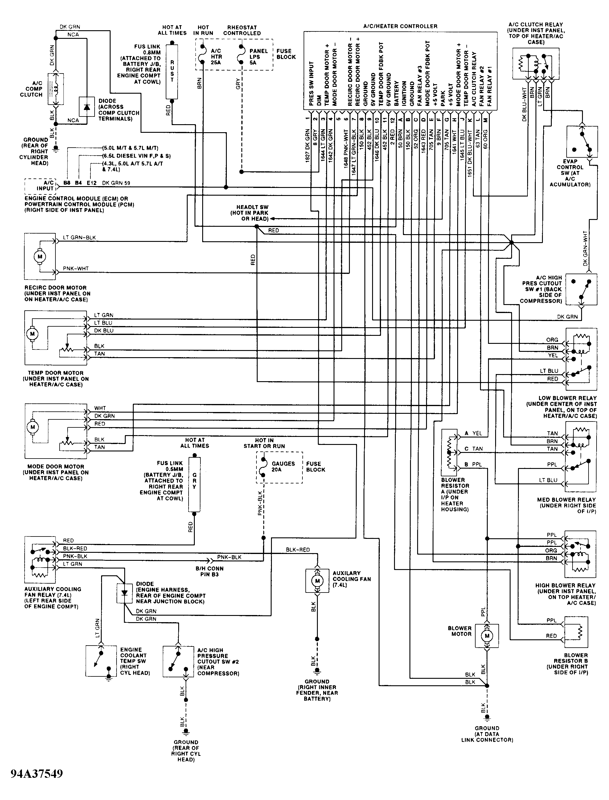

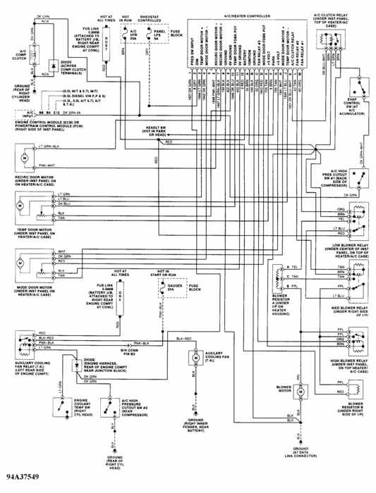

TRUCK000
  • 10 POSTS
i am replacing a bad actuator. it is in a veryyyyy tight spot i finally got it on but the door shut and stayed shut.did not open when the temp was swithched to a/c.pushed on door also wud not open. when i took the old actuator off i cud turn the **** and open and shut the door.. what am i doing wrong?
Dec 18, 2020 at 12:26 AM (Merged)
  • 110,241 POSTS
Okay... check to make sure there is power to the actuator first. Make sure the plug is properly connected.
TRUCK000
  • 10 POSTS
yes. with the old actuator the door wud open and shut but it clicked really loud and the heat wudnt work sometimes. with the new one it is completely shut and the heat works but the door doesnt open when changed to a/c. plugged in and replugged.
  • 110,241 POSTS
That is odd. Am I correct in assuming there are two wires to the actuator?
TRUCK000
  • 10 POSTS
yes
TRUCK000
  • 10 POSTS
i cud tell the small cylinder that the door hinge slides onto had changed positions too. there r 3 lines above it and a notch in the cylinder, it started in the middle and when we took it back off it was on the line to the left.
  • 110,241 POSTS
Take a look at the attached wiring schematic. If I recall, the two wires work like this. In one position, power is fed through one wire to direct the door one way. When you switch it, the power goes through the other wire (changes polarity) causing the door to go the other way. Let me know if the schematic helps. To me, it sounds like it is either out of adjustment or the power isn't coming through the opposite wire.
