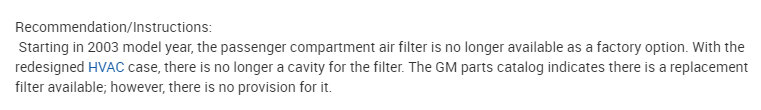

MAJOSHANGELA
How do I change the cabin air filter? Everything I have seen says to undo one screw & I'll be able to get to it but I can't figure out how to get into the housing to get the filter out. Thank you
Apr 30, 2019 at 5:47 PM (Merged)
BLUELIGHTNIN6
  • 16,542 POSTS
your vehicle doesn't have a cabin filter, they discontinued that in 2003 for the sierra...

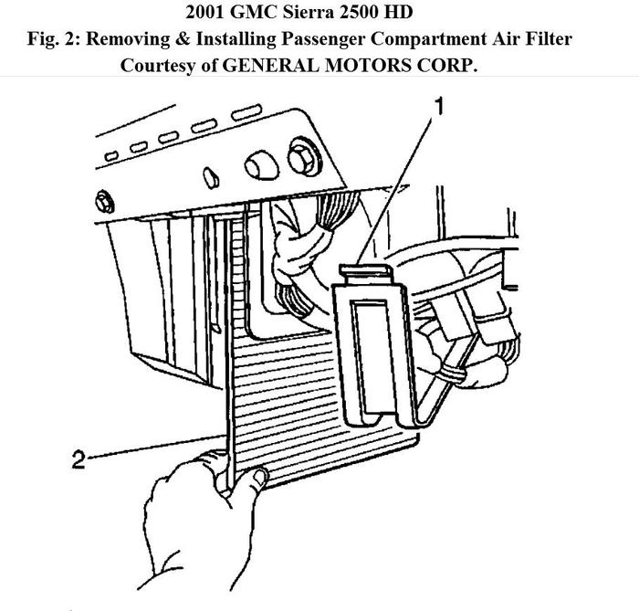

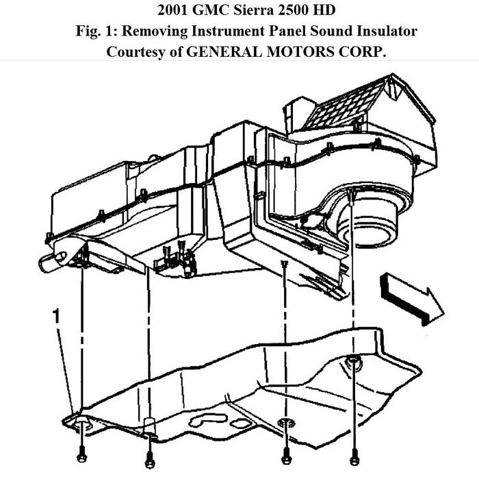

KHLOW2008
  • 41,814 POSTS
Yes there is one.
CABIN AIR FILTER
Removal
NOTE: Numbers in parenthesis refer to numbers in figures.
1. Remove the instrument panel sound insulator from under right side of instrument panel. See Fig. 1. Remove the retaining bolts. Remove the insulator (1) from the HVAC module by pulling downwards.
2. Remove the filter access door screw. Remove the filter access door (1) from the HVAC module. Remove both passenger compartment air filters (2). See Fig. 2.
Installation
1. Install the both passenger compartment air filters (2). Install the filter access door (1) to the HVAC module.
2. Install the filter access door screw and tighten to 14 INCH lbs. (1.6 N.m). Install the instrument panel sound insulator.
ICORALXXX
does a 2005 GMC Yukon have a cabin air filter?
Dec 17, 2019 at 3:54 PM
DANNY L
  • 5,648 POSTS
Hello, I'm Danny
No, there is no cabin air filter in your truck. I've attached an article below.Thanks for using 2CarPros.
