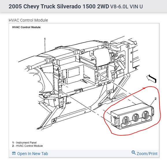

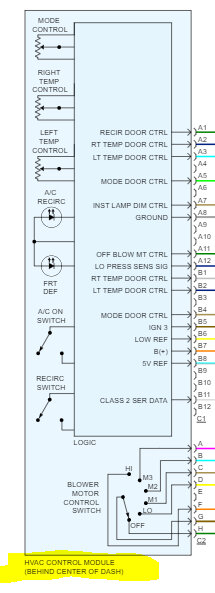

I’m confused a bit, should I be looking to replace the module that controls the temperature, fan speed or am I replacing where the wires connect on the right-side passenger?
Saturday, May 13th, 2023 AT 6:02 AM
  • 109,885 POSTS
The control module is in the center dash and is what you control things with. See the attached pics below.
Let me know if this helps.
