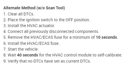

Do me a favor. Try the relearn procedure listed below in pic 1. If that does nothing, we need to move on to testing.

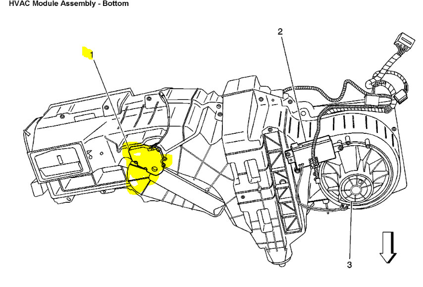

If the left side isn't working, it should be further to the left of the glove box. The one for the passenger is on the right and behind the glove box.
Take a look at the attached pic and let me know if that is the one you are working with.
See pic below.
Apr 24, 2023 at 6:12 PM

Yes so, it’s the one on the left side under the glove box. I’ve already had the wire pulled exposed. I hooked up a new actuator or rotates once and it doesn’t move when I manually adjust the temperature.

Did you try the manual reset I attached above?
Apr 24, 2023 at 7:07 PM

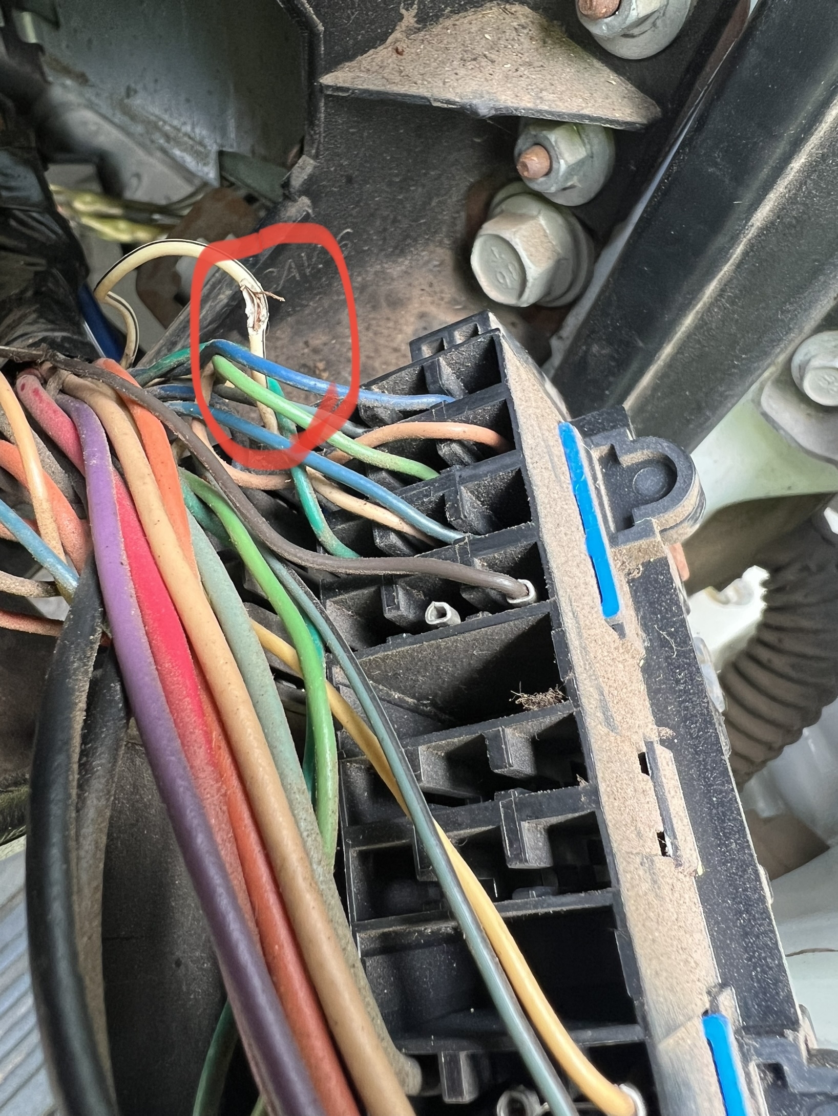

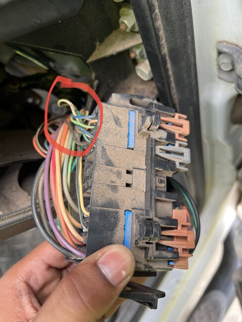

Good afternoon, I just got the truck back today. After just looking at the module I noticed this wire. Could this be the reason I’m having the issue?
May 8, 2023 at 12:57 PM
  • 110,194 POSTS

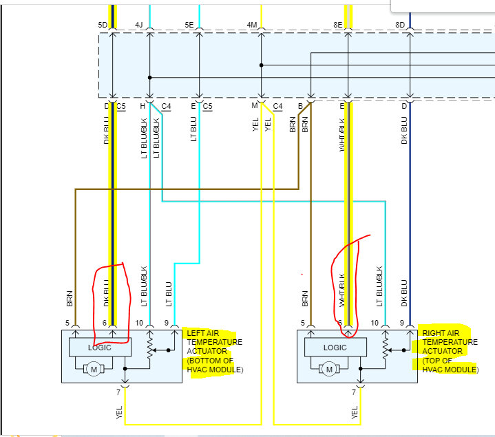

Interestingly, the white wire with a black tracer controls the passenger side (right side). See pic below.
However, if that wire is damaged, there are likely others. Check for a dark blue wire. See if there is damage. Also, there will be a light blue wire with a black tracer. That provides the 5v reference. Locate that and see if there is power. Also, there should be a brown wire that provides battery voltage. Check that as well. It comes from the HVAC 1 fuse in the interior fuse box.
See pic below.

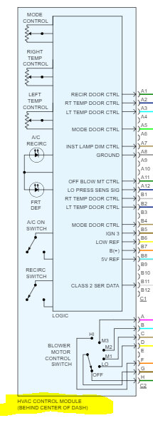

When the motor needs to turn in the opposite direction, the polarity needs to change direction. In other words, it has to travel in the opposite direction for the motor to turn in the opposite direction.
Also, does the voltage change as you move through the temperature slowly? If it doesn't, chances are the controller has an internal fault.

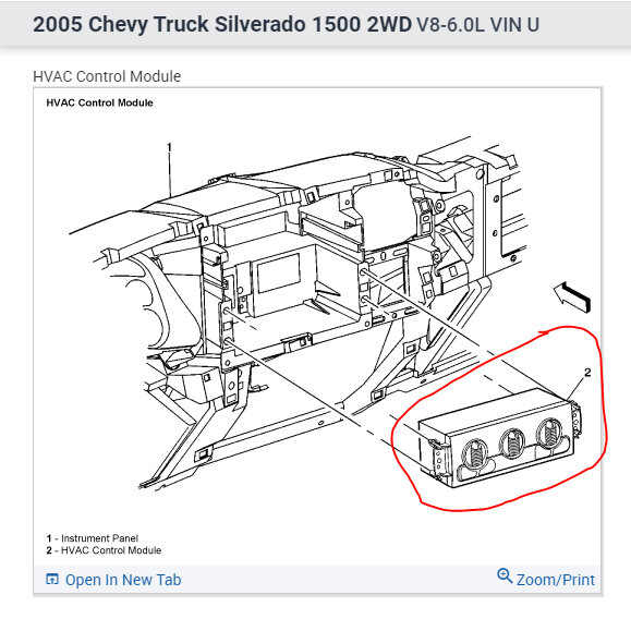

So, I checked the voltage from hot to cold slowly and the voltage did not change. Does that mean the module is bad?

That would be my first suspect since there is no change at the actuator. As far as the speeds are concerned, it is controlled by a blower motor resistor. However, if it is the module, that could be another symptom.

Okay, I will go to the pick and pull and get a new module tomorrow.

I’m confused a bit, should I be looking to replace the module that controls the temperature, fan speed or am I replacing where the wires connect on the right-side passenger?
May 13, 2023 at 6:02 AM
  • 110,194 POSTS
The control module is in the center dash and is what you control things with. See the attached pics below.
Let me know if this helps.
