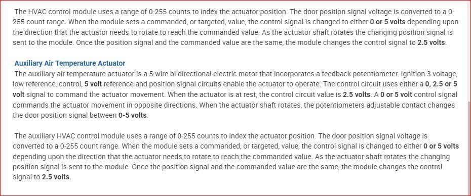

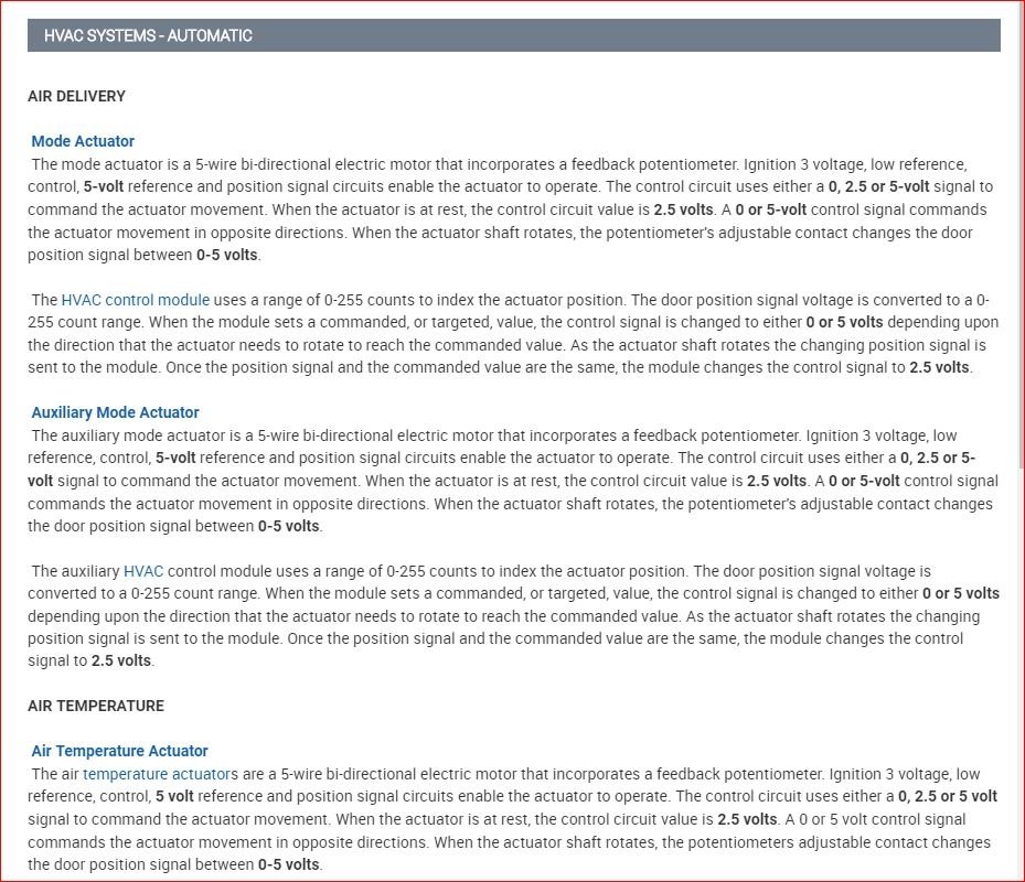

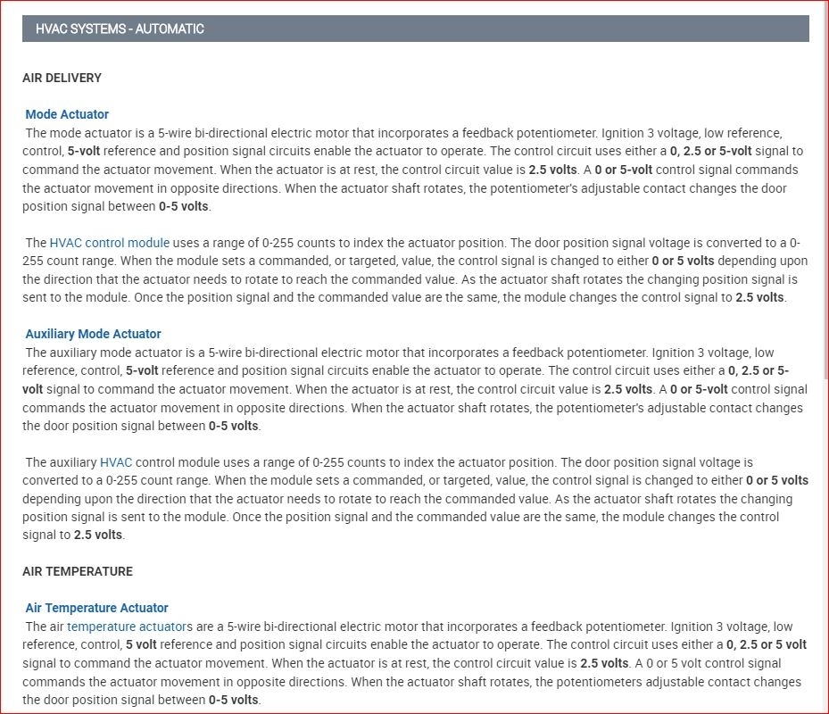

Okay. So we have two issues. One is the direction of the air and the other is the temperature. They could both be actuators because they are controlled by different actuators.
The air temperature is controlled by a blend door/air temp door and the direction is controlled by a mode door.
Let's address the mode or position first, As you will see in the attached documents, the actuator is controlled by the HVAC control module to move positions. If it is stuck on one setting then it is either the actuator or the module. Since this was already broken, I would suspect the actuator is the issue.
As for the temperature only blowing warm, we need to make sure the actuator is moving when you are commanding cold air. If not, then that will need to be replaced.
