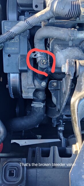

Could a partially screwed in and broken bleeder valve be causing it to overheat and no heat inside the car?

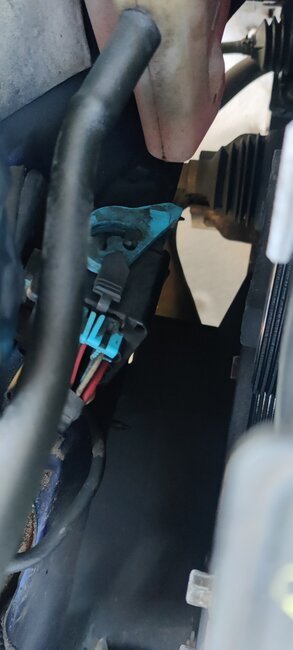

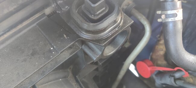

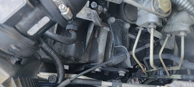

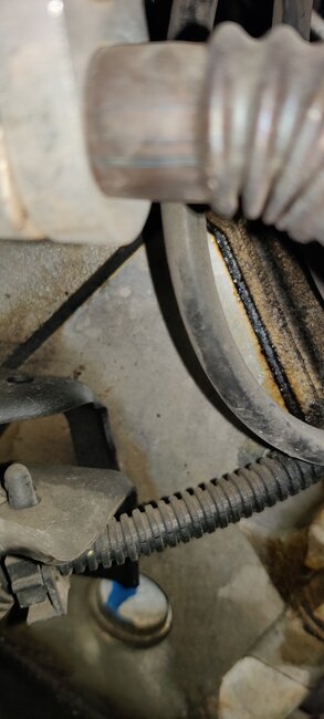

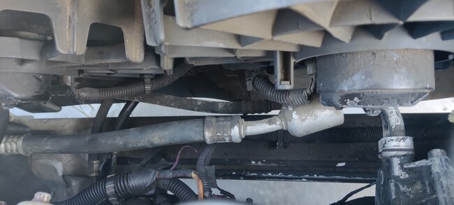

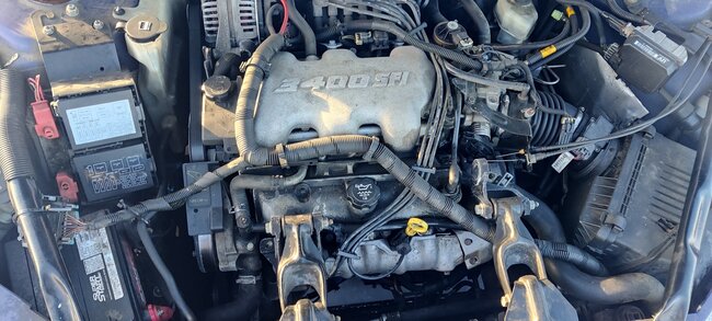

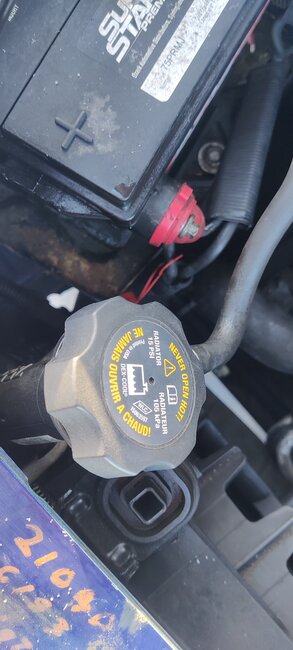

I'm not sure if any of these pictures will help but at least you're not relying on just my description of what I'm seeing under my hood because I know hardly anything when it comes to it.

Great pics. I don't see any evidence of a coolant leak. The bleeder shows dry coolant right where coolant would come out when bleeding. Have you ever noticed a leak at that point when the engine is warm?

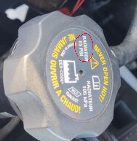

Here is what I'm going to suggest. First, if the coolant level is going down, there has to be a leak. Keep in mind, when it is overheating, there is a lot of pressure on the system. However, it shouldn't go beyond the rating on the radiator cap. In this case, 15 psi. See pic 1 below. I copied your pic.
Here is what I want you to do. When the engine is cold, remove the radiator cap in pic 1 below and confirm the radiator is full of coolant. If it is low, fill it with the correct type of coolant. These came with DexCool from the factory. If that has never been changed, do not add anything except DexCool or a universal type that indicates it is usable with DexCool. Reinstall the cap.

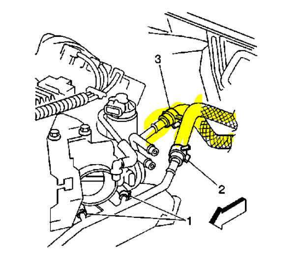

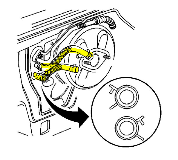

Next, turn the heater on high and start the engine and allow it to reach operating temperature. Check to see if you have heat. If you don't, turn the engine off. Feel both heater core hoses under the hood mounted at the firewall. Both should be hot. See pics 2 and 3 for the heater hose location. Note: It will be on the driver's side next to the brake master cylinder/vacuum booster.

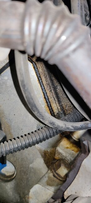

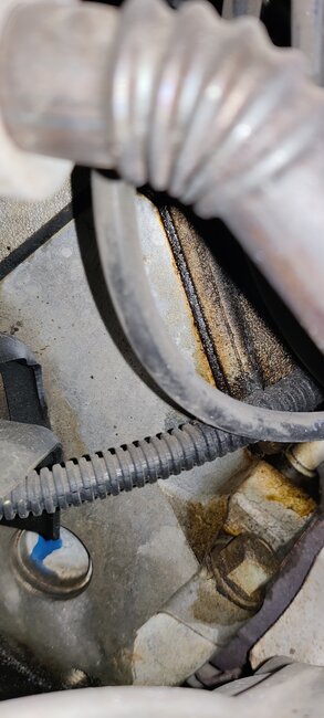

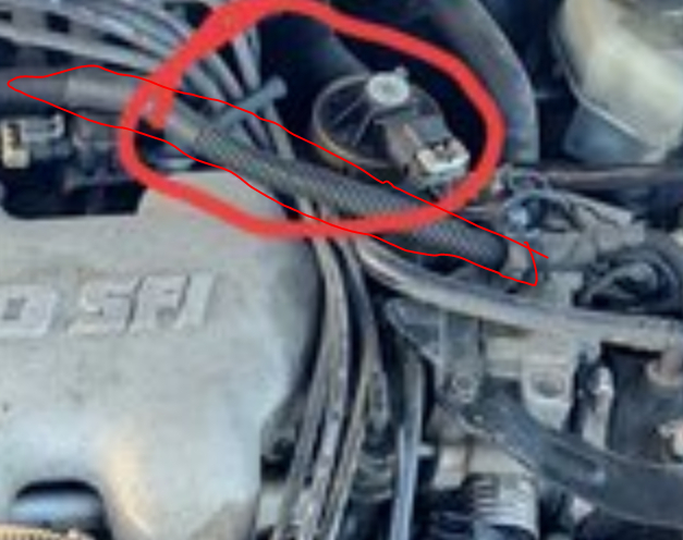

No, those hoses weren't hot and when I was checking to see if I had the right ones, I found this. It looks like a rubber thing between two parts of the engine. I circled the area I was looking at. I don't think I can get a better picture you can't see it from the top you have to actually kind of look down in.

I'm not sure what you are referring to in the first three pics. Could you circle it in one of those pics?
Also, is that the area that you feel the leak was coming from?

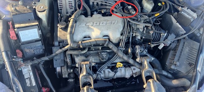

So, I showed the pictures and explained it to a couple other people, and they are guessing that what we're looking at is the valve cover gasket and I don't think that leaks antifreeze right? But the antifreeze is running down that and so there's got to be something leaking in that area, I think.
Dec 6, 2022 at 2:32 PM
  • 110,248 POSTS
You are correct. There shouldn't be coolant coming from the valve cover. However, I do see a hose above it. Check that hose for the leak.
See your pic below.
