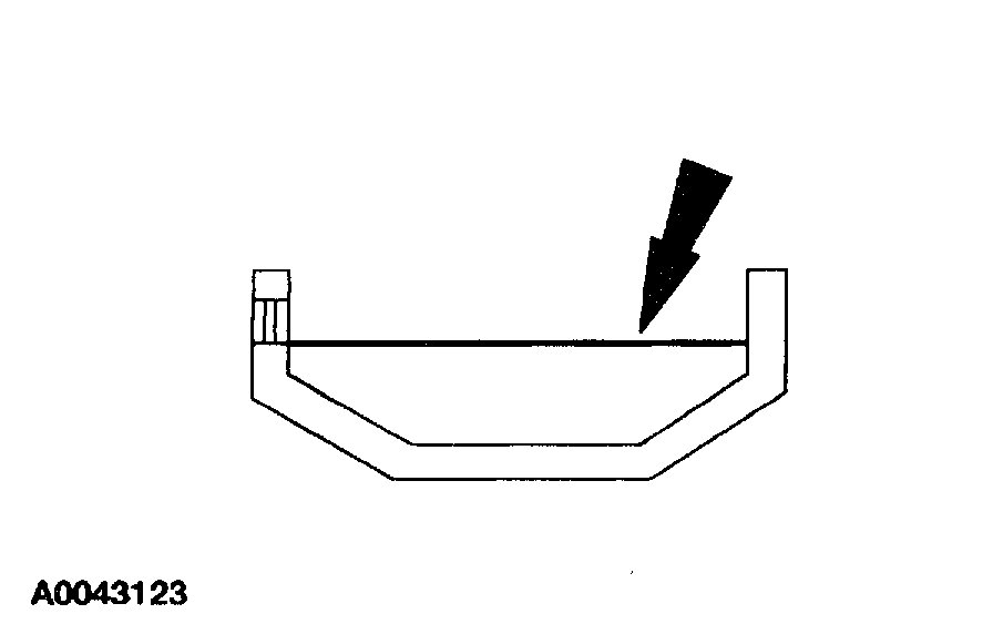

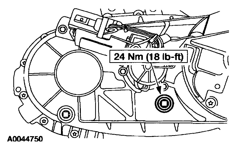

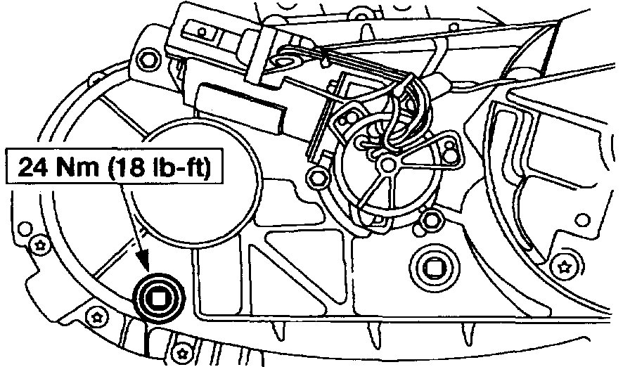

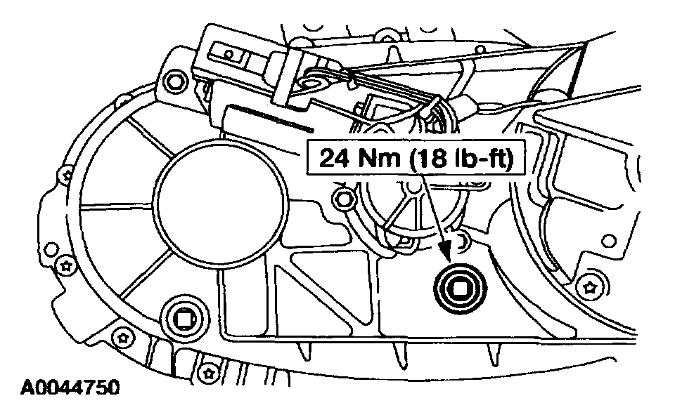

Here are directions for servicing the transfer case. It shows how to confirm the fluid level is correct. The three attached pictures correlate with these directions.
1. Remove the drain plug and drain the fluid. Clean and reinstall the drain plug.
2. CAUTION: Incorrect fluid fill can result in transfer case failure.
NOTE: The fluid level should be just below the fin plug.
NOTE: Clean the area around the fill plug.
Remove the fill plug, and fill the transfer case.
- The fluid must be just below the fill plug hole. Because you can reach the fluid with a finger does not mean the fluid is at the correct level. Make sure the fluid is level with the filler opening for the correct fluid level.
