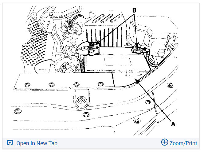

So, there must be two ground points off of the battery, one on the engine and the other to the chassis. The one to the chassis can be a smaller gauge wire while the one to the engine must be a large gauge. Looking at the image of the cable it looks like it might go over to the chassis and then loop to the engine block, I would make sure these cables are in good shape, I would find a good place such as a mounting bracket near the engine or transmission. If you upload images I can help you. Check out the images (below). Let us know how it goes.

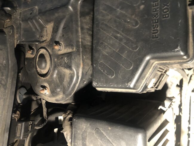

Sorry for the delay. The orig negative cable connected directly to the inner body panel under the TIPM/Fusebox. There were two bolts that were corroded. The cable is in great shape (I wire wheeled it) but the mounting hole stripped out meaning I need to find an alternative mount point. But there was only ONE cable/wire coming from the negative terminal.
I watched another video where the mechanic connected the replacement cable to the strut tower pictured in the attached photo. While he drilled and used a threadcert I do not have that. So, if I completely remove the paint from one of the strut mounting bolts on the same tower do you think that would suffice as a suitable ground?
Someone suggested use a transmission to engine bolt to hold it but those seem extremely difficult to get to.
Thoughts?
Jan 21, 2025 at 4:31 AM
  • 55,224 POSTS
Yes, you can use the strut tower, but you need another cable going to the engine or transmission, any bolt about that size should be good, and the wire must be battery cable size. They make them on Amazon, here it is for $18.
