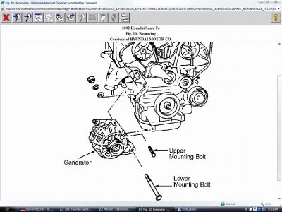

How do you get the alternator out.
May 10, 2008 at 11:20 PM
MERLIN2021
  • 17,250 POSTS
https://images.2carpros.com/forum/automotive_pictures/62217_Alter_1.jpg
No directions are available from Hyundai, but on 2.7 engines, it may be necessary to remove the right axle to access the lower bolt....
