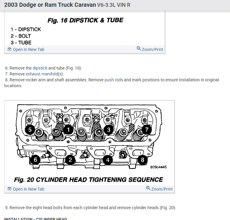

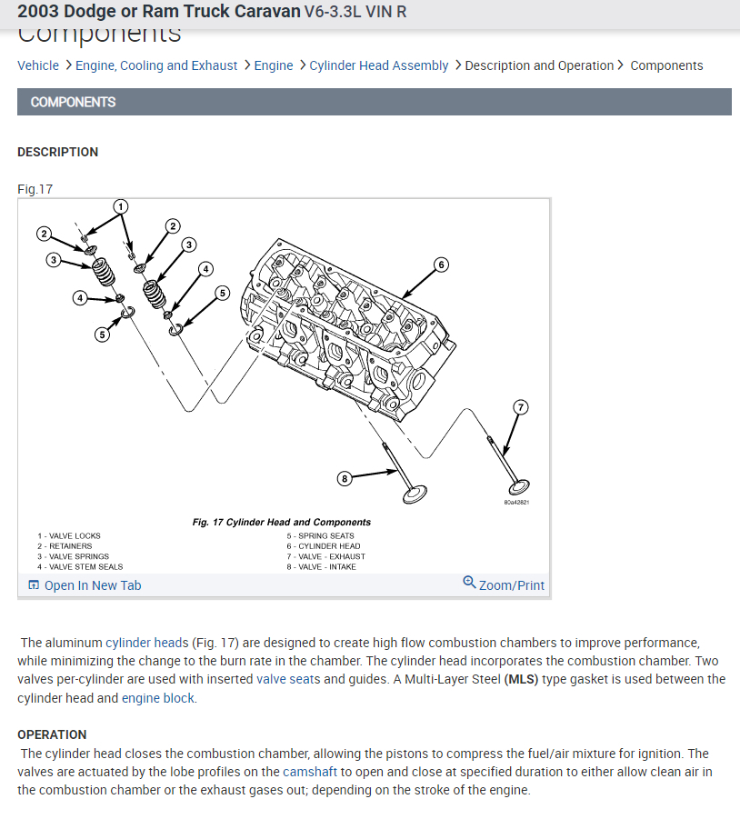

Is it worth it to do the head gaskets for my van listed above with 280,000 miles?

It all depends on your plan with that vehicle.
If you plan to keep it for a while it is always a good idea to keep up with the maintenance. As for the long run that is always a better value proposition.
Head gasket is not consider as a maintenance item, only should be replaced if needed.
Also is the head gasket leaking or do you have an overheating issue?

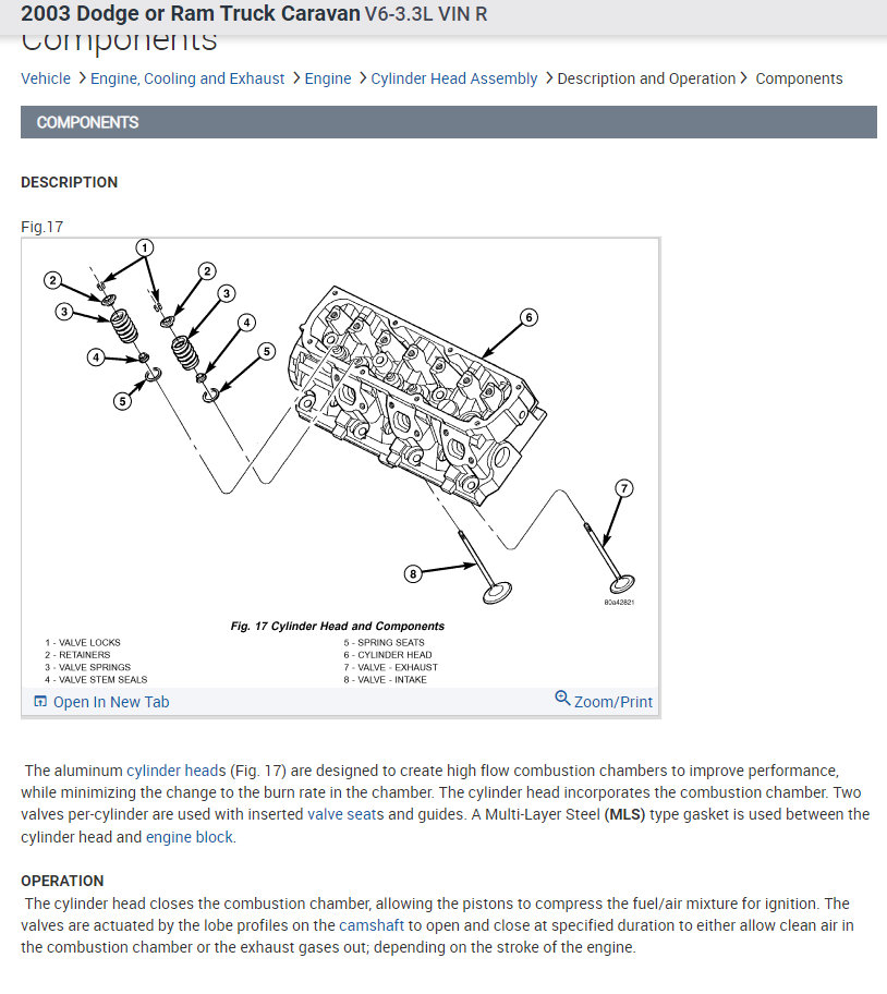

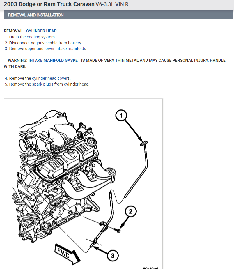

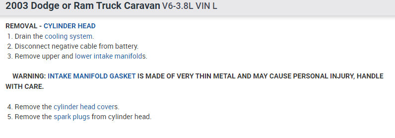

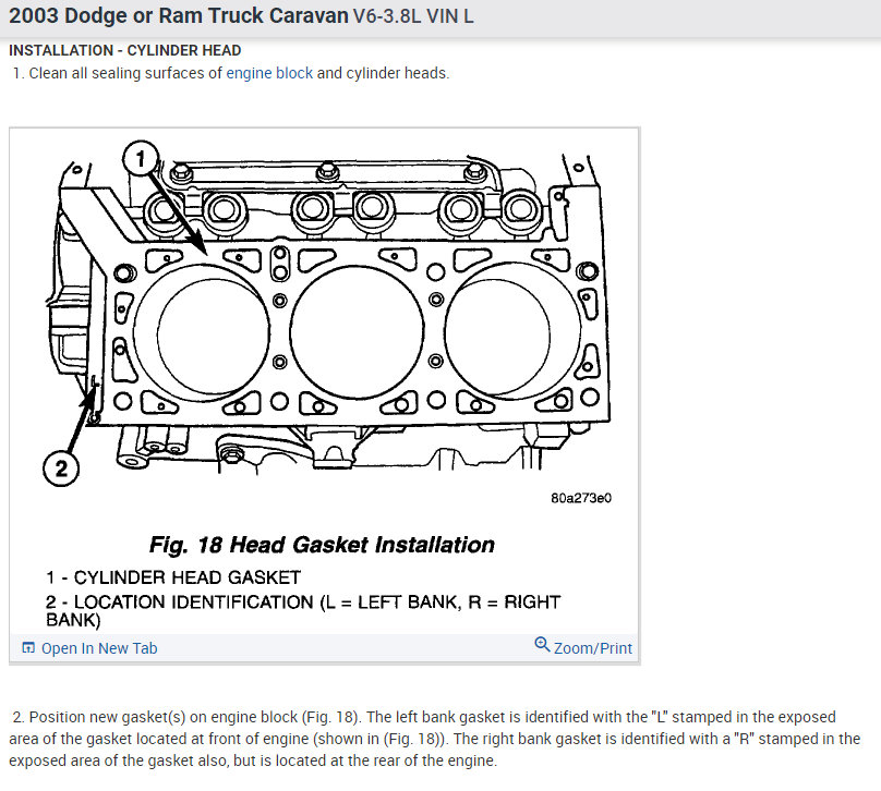

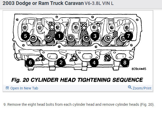

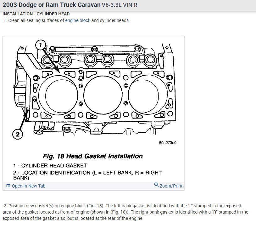

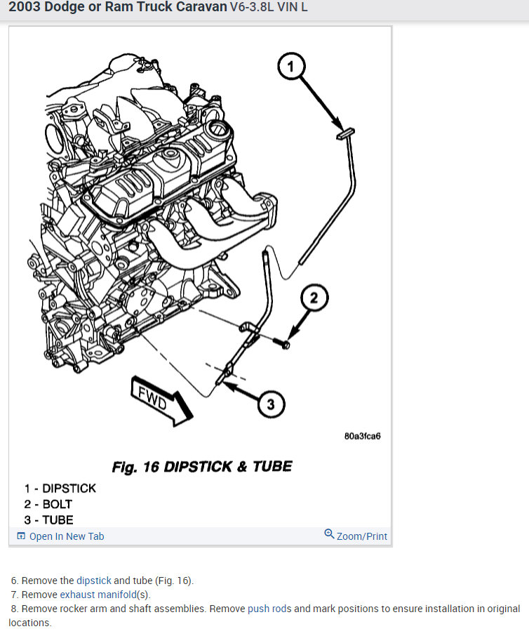

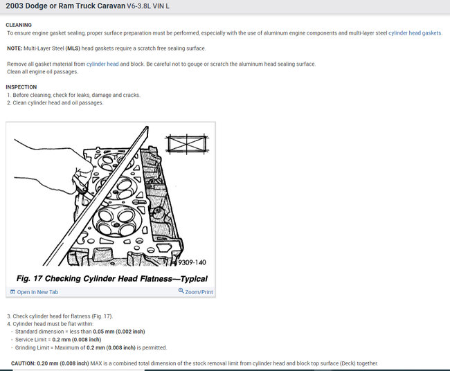

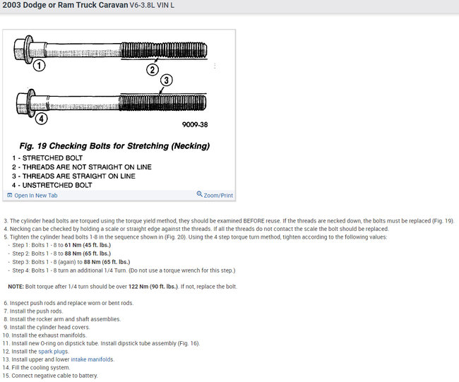

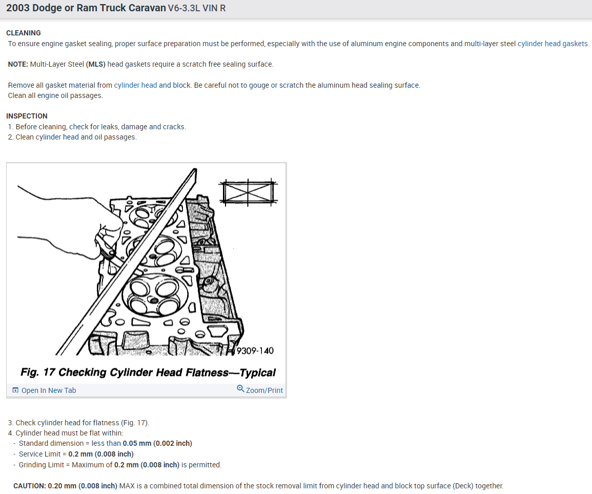

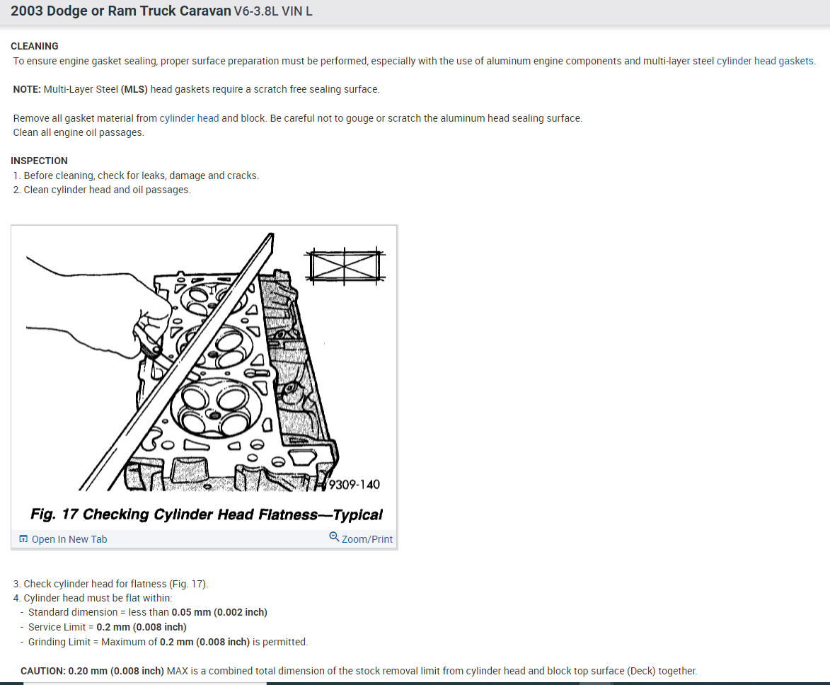

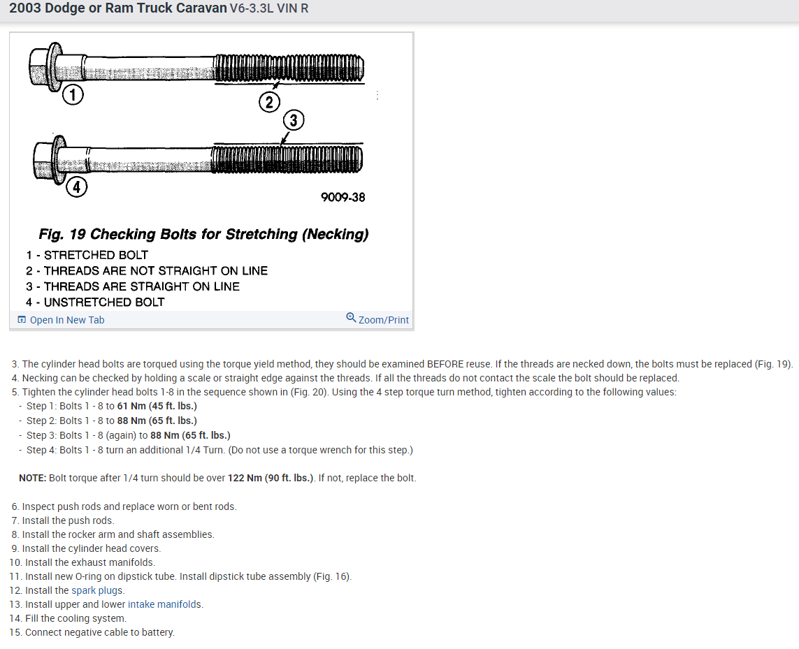

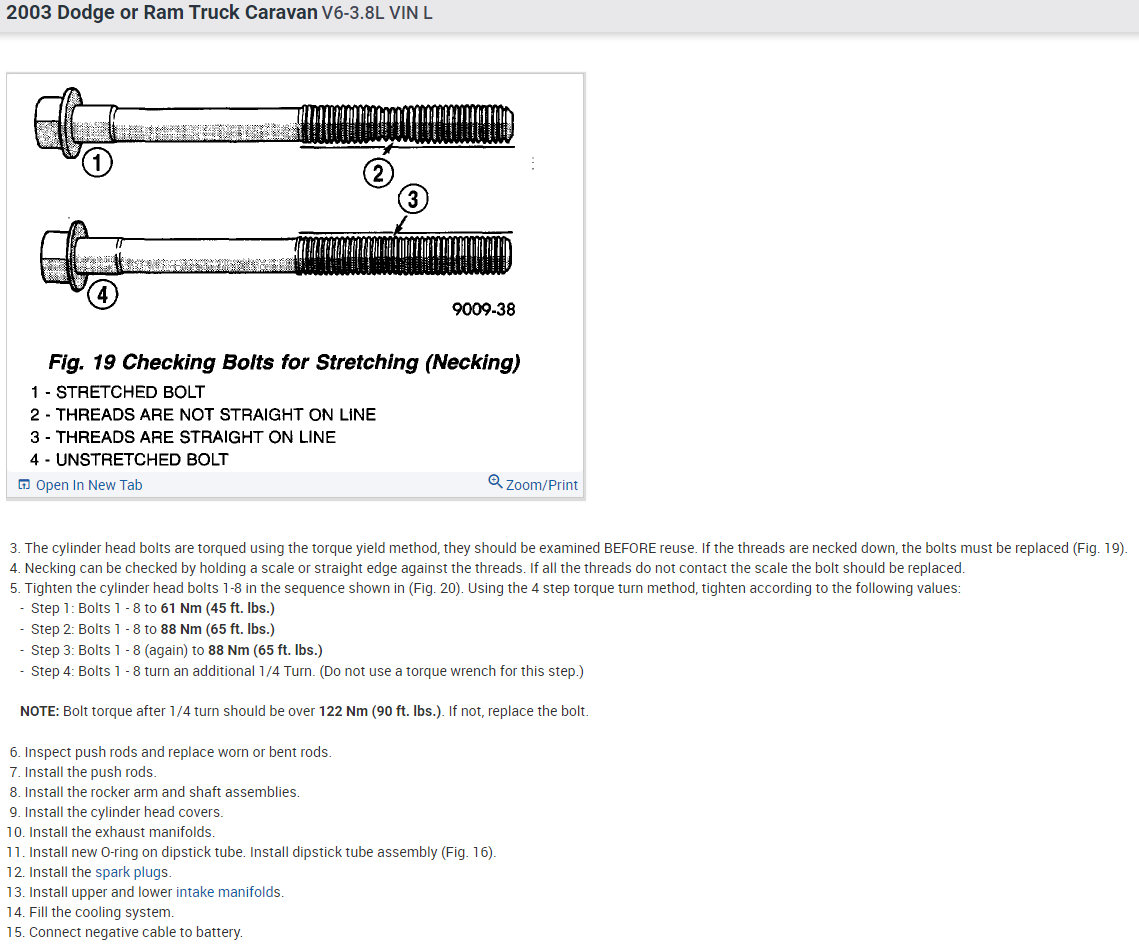

I have attached the head gasket replacement procedure including torque specifications and sequence for your reference, for 3.3L (non flex fuel) and 3.8L engines.
