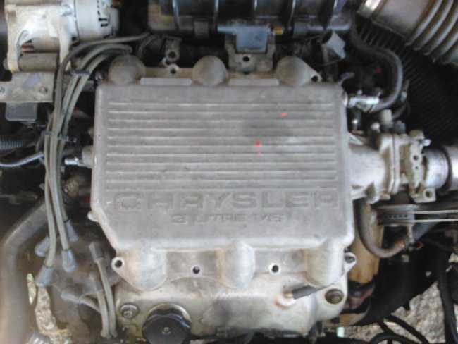

How many bolt are there? I have removed eight off the top cannot find any more.

That should be all of them. Make sure there are no brackets attached to the sides. I see you have not disconnected the throttle cables you. There will be a couple of coolant hoses attached also.
