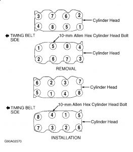

I am looking for the torque needed to replace the head after replacing the head gasket.

While I attempt to look it up, can you give me the exact engine size? Liters.

Posted wrong year, it is a 1995
believe engine size is 3.0 L

All I am finding is a four cyl, this is 2.6 liter. 2.4 should be the same.

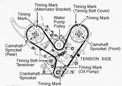

Tighten to 80 ft. lbs in three steps, order is as shown. also included timing mark set up.
