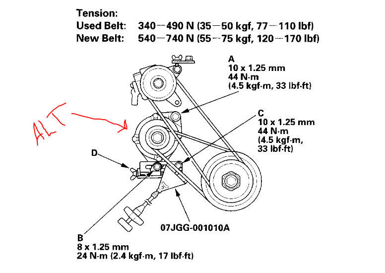

When I start my car (EX model) the belt screeches loudly unless I slam the accelerator. It does this when the transmission is in park, it's quieter in reverse and about the same in drive. Every now and then the belt will screech while driving. I'll have steady acceleration then suddenly if I give it any gas it starts to stall, and I have to wait a second or two and slap the gas pedal and it will stop. Then it will happen again for a while. So stalling, slap the gas to get speed, gas pedal starts to stall the car, let off for a second, slap the gas, repeat. Please help!

The noise is likely the result of a loose belt. I need you to try something. When you start the vehicle, does the noise change if you turn the AC on? Also, does it get louder or change if you place a heavy load on the alternator? For example, is it different if you have the headlamps on, wipers, blower motor, and other electrical components?
Here is my theory. I have a feeling the alternator belt is loose. I feel it is allowing the battery voltage to drop. That could be the cause of the drivability issue. So, I need you to check all belts to see if they are tight. I'm specifically interested in the alternator belt. See pic below.
joe
See pic below.

Okay, so, I had just tightened the serpentine belt and it took the squeak away which I should have known better, I just changed my water pump and timing belt so I should have double checked the tension. But unfortunately the stalling while giving it gas, waiting a second, revving it up and coming out of it for it to big down again is still there. I'm thinking maybe my mass airflow sensor or possibly fuel filter, or injectors? I'm at a loss and I don't have money to throw at something it's not ya know?
