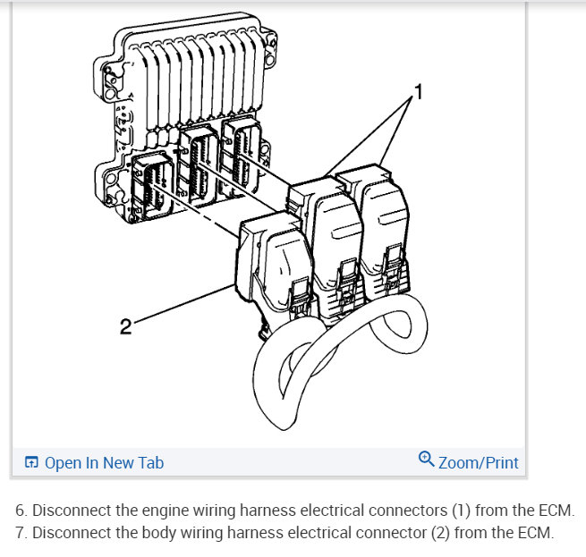

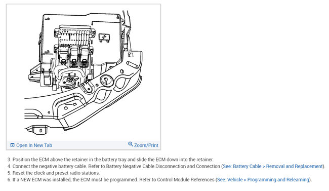

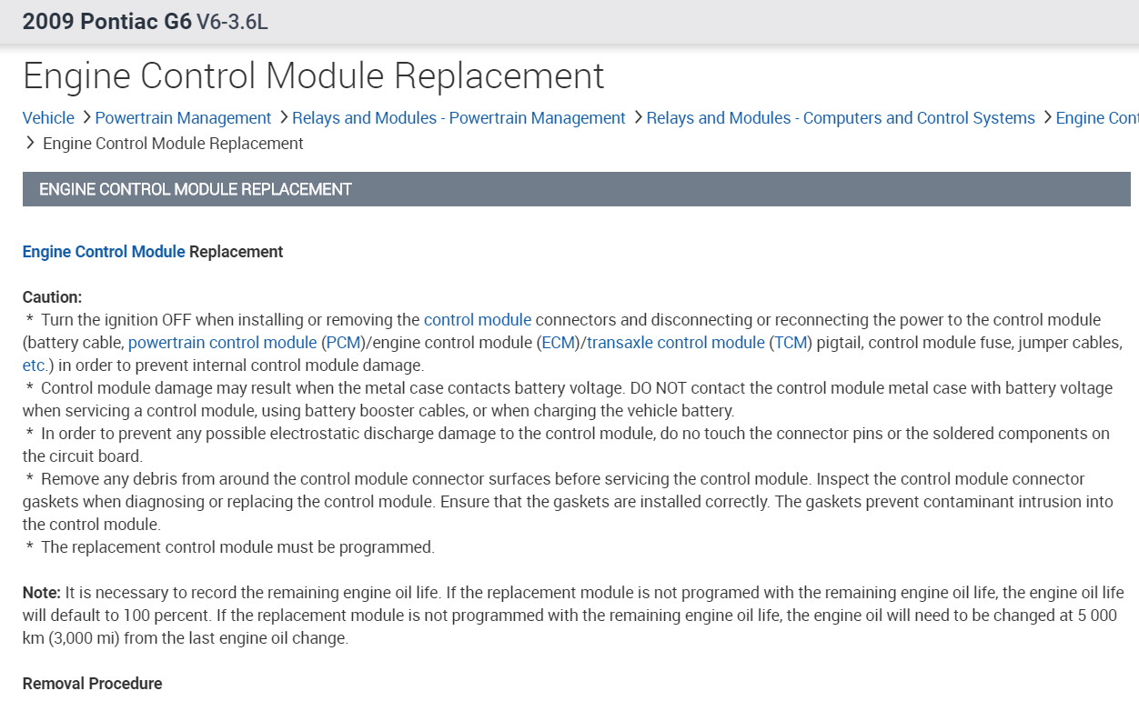

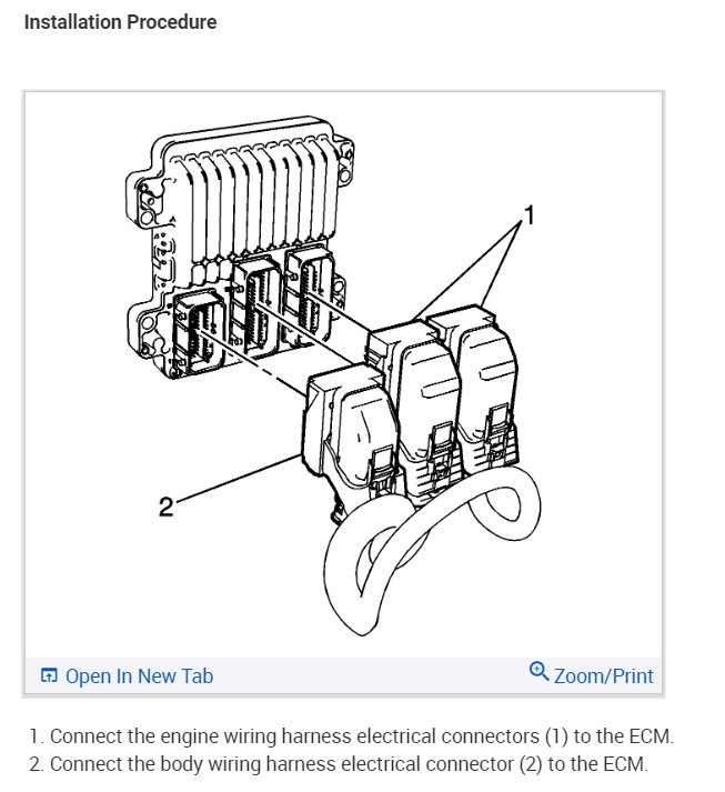

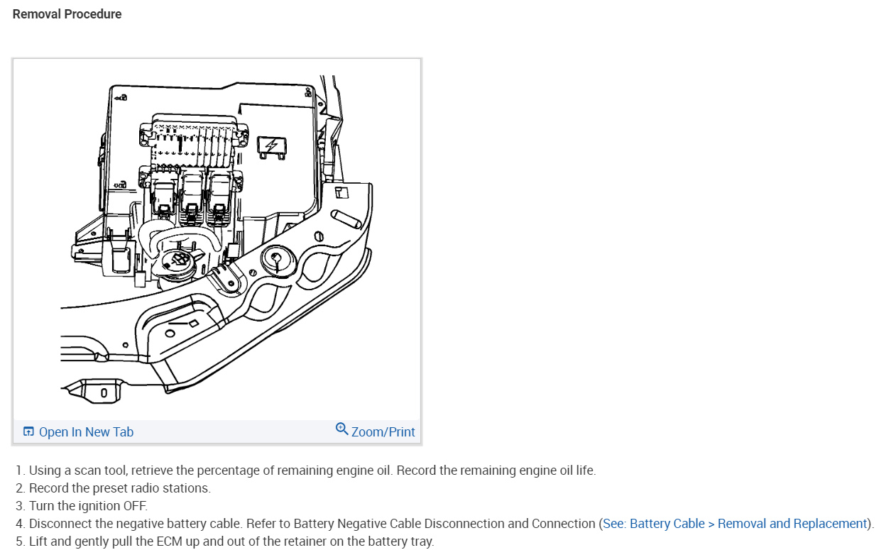

When I go to turn on the car I get dash lights, ABS fault, stability control off and contact dealer it doesn't read fuel. I try to start and get nothing. I have put a scan tool on and get error code U0100. Also if I disconnect the negative terminal on battery for 2 minutes than reconnect it and turn on the ignition I get same thing but it reads the fuel and cranks goes to start than stops. Ve omega
Dec 7, 2019 at 9:01 PM
  • 55,721 POSTS

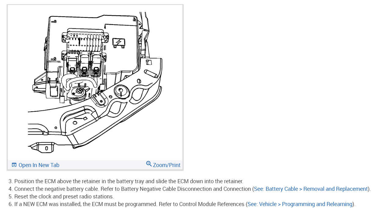

This is common when the PCM goes out here is the replacement and reprogramming procedures with diagrams below to show you how.
Engine Control Module Programming and Setup
The following service procedures require either a programming or a setup event performed for a complete repair.
ECM Replacement
If the engine control module (ECM) is replaced, the following procedures must be performed:
1. ECM Reprogramming-Refer to Service Programming System (SPS) (See: Vehicle > Programming and Relearning).
2. The CKP System Variation Learn-Refer to the following:
* Crankshaft Position System Variation Learn (See: Crankshaft Position Sensor > Removal and Replacement)for the 2.4L engine
* Crankshaft Position System Variation Learn (See: Crankshaft Position Sensor > Removal and Replacement)for the 3.5L engine
* Crankshaft Position System Variation Learn (See: Crankshaft Position Sensor > Removal and Replacement)for the 3.6L engine
* Crankshaft Position System Variation Learn (See: Crankshaft Position Sensor > Removal and Replacement)for the 3.9L engine
3. Engine Oil Life Remaining-When available, use a scan tool to reset the Engine Oil Life Remaining back to the original percentage recorded before the module was replaced.
4. Transmission Fluid Life Remaining-When available, use the scan tool to reset the Transmission Fluid Life Remaining back to the original percentage recorded before the module was replaced.
5. Theft Deterrent-Refer to Immobilizer System Component Programming (See: Vehicle > Programming and Relearning).
ECM Reprogramming
* If the ECM needs to be reprogrammed, refer to Service Programming System (SPS) (See: Vehicle > Programming and Relearning).
* Engine Oil Life Remaining-When available, use a scan tool to reset the Engine Oil Life Remaining back to the original percentage recorded before the module was reprogrammed.
Important: After programming, perform the following to avoid future misdiagnosis:
* Turn the ignition OFF for 30 seconds.
* Turn the ignition ON with the engine OFF.
* Use the scan tool in order to retrieve history DTCs from all modules.
* Clear all history DTCs.
