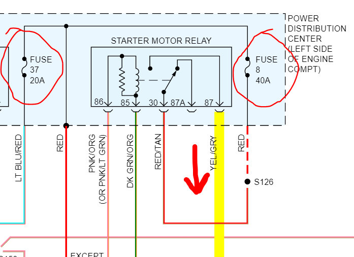

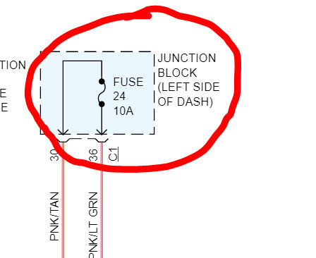

I need you to check 3 fuses for me. I attached two pics below and am not sure how they would have blown, but I'm not sure which wires touched. Check these and let me know what you find. In the first pic, the arrow shows which wire is going to the starter solenoid (S Terminal). It should only have power when the key is in the start position. If you have a helper, see if there is power to that wire at the starter when the key is in the start position.
Let me know what you find.
