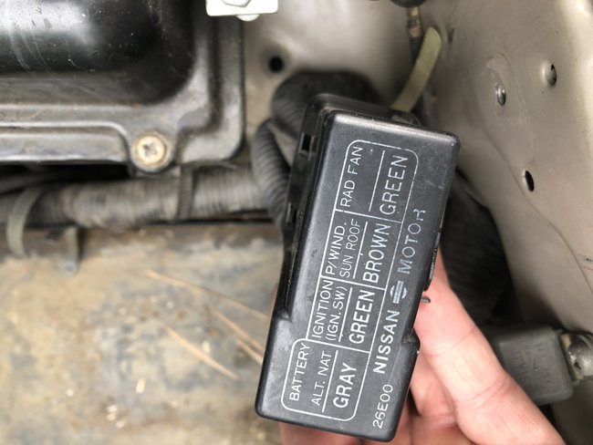

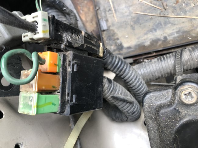

Next to the battery is a cluster of four fuses. One is battery and the other three are ignition, power windows, sunroof.
The plastic fuse holder for the battery fuse cracked and is shorted out. I can not find a replacement so I need to find a solution.
So my questions are-
1) What is the amperage of the battery fuse?
2) Is there any place to buy a new fuse and fuse holder?

The battery fuse is usually 40 amp you will not find an exact replacement you will need to wire in an aftermarket fuse holder which you can get at AutoZone.

Thank you Ken that helps a lot. Nate
