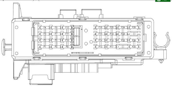

Battery draw?
2010 FORD EXPLORER
800,000 MILES
MARY MENARD
Pulled #2 fuse in passenger compartment fuse box and problem went away. what is my next step?
Aug 29, 2016 at 12:10 AM
HMAC300
  • 48,601 POSTS
put fuse back in and check for a parasitic draw to see what fuse is connected to fuse 2 powers smart junction box which may be bad have a look at this guide to help us find the problem
https://www.2carpros.com/articles/car-battery-dead-overnight
Aug 29, 2016 at 2:49 AM
MARY MENARD
Sorry,what is the smart junction box...and where is it?
Aug 29, 2016 at 3:38 AM
HMAC300
  • 48,601 POSTS
that is the fuse box inside the car it has some electronics that run different things. see pic it powers the horn relay which is an integeral part of the smart junction box. I don't see any tsb's or recalls on this but check with a mechanic he may be able to fix it without getting a new junction box.
Aug 29, 2016 at 3:50 AM
MARY MENARD
This is the fuse box we pulled #2 out of. What is next?
Aug 29, 2016 at 4:10 AM
HMAC300
  • 48,601 POSTS
The relay for the horn is internal so it has to have the whole fuse box replaced or a mechanic will have to wire a separate relay in if there is no short in wiring keeping the draw going.

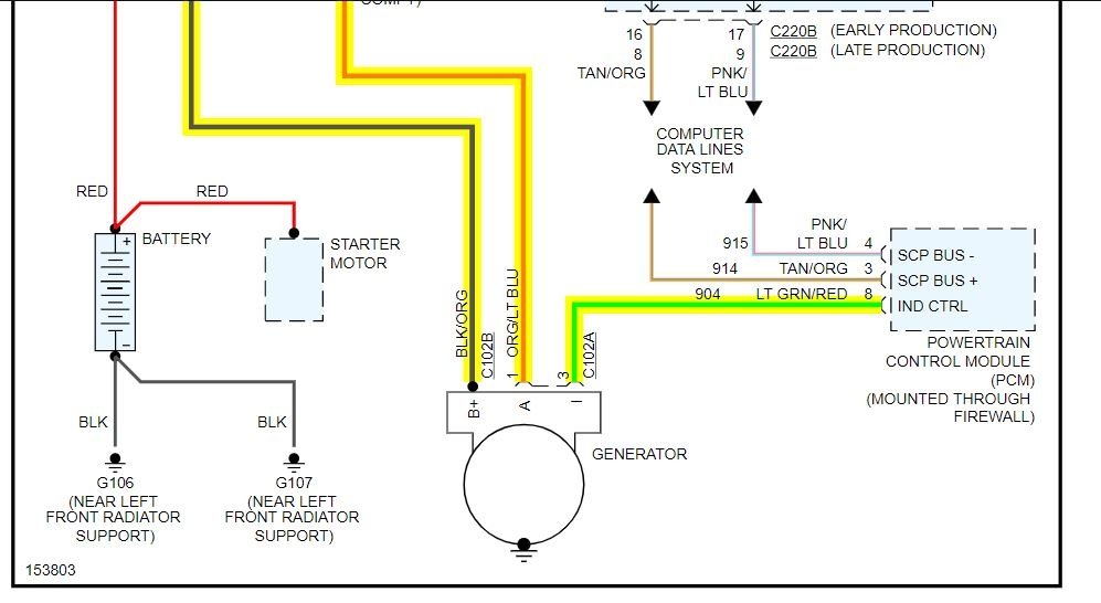

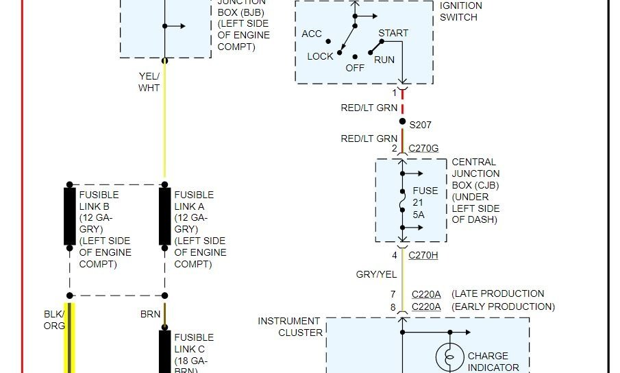

TBICE3095
I have replaced my car battery, i also replaced the starter and alternator. I took out the #40 fuse and the battery light finally went off. What does that mean? Also before i put the new battery in yesterday i had to keep jumping it off and i changed the wires on the battery. Also the driver door electrical system does not work. On the dash it keeps saying door ajar and the overhead lights stay on. What could that be?
Dec 21, 2020 at 2:48 AM (Merged)
Good morning,
If you install the fuse, does all the other accessories work again?
Can you verify that fuse number? It does not show on my diagrams.
I attached a wiring diagram for you to view. Make sure you have power to the alternator with the key in the on position.
