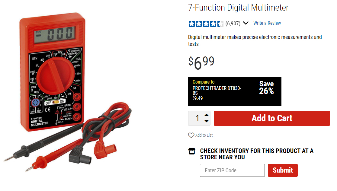

If you buy a very basic multimeter from Walmart, they are around $20. This one is from Harbor Freight and is only $7. You would just set the meter on DCV 2000m, and with the truck off and the doors all closed, I can walk you through checking the fuses to see which one has current flow through it, this will lead us to the circuit that is draining your battery, and get the issue figured out for you. Since this is an older Ranger, most likely it is just a relay that is stuck on causing this issue. There are not a lot of complicated computer modules in it.
