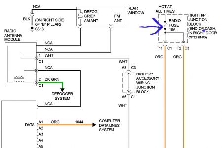

This is the fuse you are going after:
https://www.2carpros.com/forum/automotive_pictures/30961_imp1_1.jpg

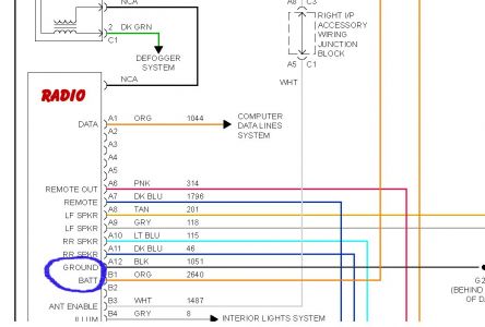

If the fuse is good check for power getting to the radio connector and verify the ground is good.
https://www.2carpros.com/forum/automotive_pictures/30961_imp3_1.jpg

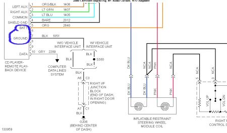

CD player: IF needbe.
https://www.2carpros.com/forum/automotive_pictures/30961_imp2_1.jpg

It was the fuse on the radio - so at least we're able to have some noise in the car again!
Thanks for your help!

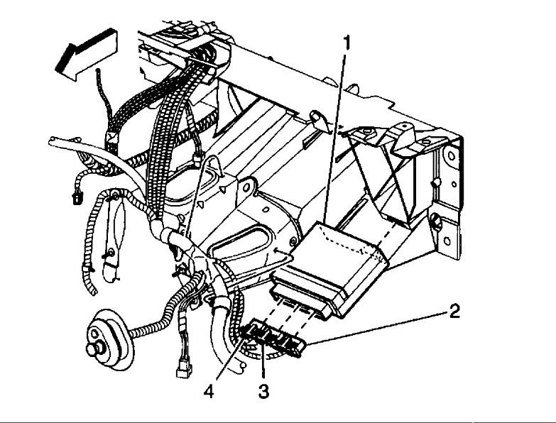

REMOVAL PROCEDURE
IMPORTANT: You must perform the new body control module (BCM) setup when replacing the BCM. Refer to BCM Programming/RPO Configuration.
1. Disconnect the battery ground (negative) cable.
2. Remove the left instrument panel insulator.
3. Disconnect the BCM electrical connectors (2, 3, 4).
4. Remove the BCM (1).
INSTALLATION PROCEDURE
1. Install the body control module (BCM) (1).
2. Connect the BCM electrical connectors (2, 3, 4).
3. Install the left instrument panel insulator
4. Connect the battery ground (negative) cable.
5. Perform the new BCM setup. Refer to BCM Programming/RPO Configuration. See: Vehicle > Programming and Relearning
