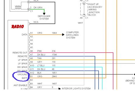

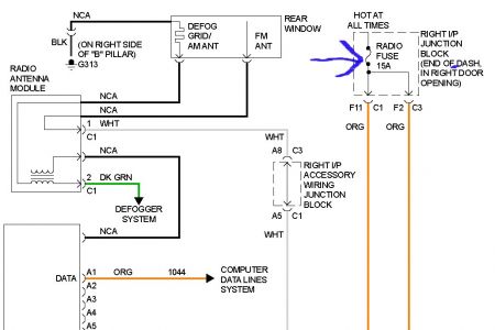

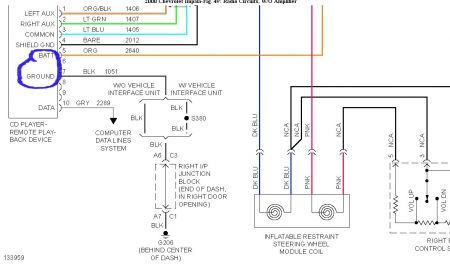

SERVICE WRITER
  • 9,123 POSTS
Well since you had pulled the one fuse that only left the system with a one Ma draw, then we know the most this circuit can have is 1 Ma. So no, it can't be an excessive draw. This is the fuse you are going after:
https://images.2carpros.com/forum/automotive_pictures/30961_imp1_1.jpg
If the fuse is good check for power getting to the radio connector and verify the ground is good.

CD player: IF needbe.
https://images.2carpros.com/forum/automotive_pictures/30961_imp2_1.jpg

HEAVVYREVVY
  • 8 POSTS
It was the fuse on the radio - so at least we're able to have some noise in the car again!
Thanks for your help!

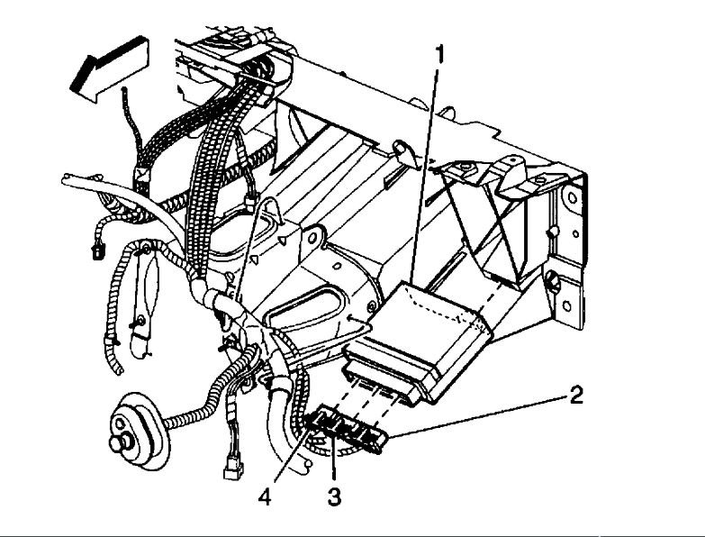

AMBROSIA51
Changed alternator and battery but still not charging.Tested all fuses and when i removed the cluster/BCM fuse the tester dropped. where is this module located?
Jan 20, 2021 at 11:37 AM (Merged)
Good evening,
Are you measuring amp draw? voltage draw is not the way to check for a drain. current flow drains a battery, not voltage. the voltage will always be present but you need to measure current flow. it should be 50 to 75 milli amps as a spec.
https://www.2carpros.com/articles/car-battery-dead-overnight
REMOVAL PROCEDURE
IMPORTANT: You must perform the new body control module (BCM) setup when replacing the BCM. Refer to BCM Programming/RPO Configuration.
1. Disconnect the battery ground (negative) cable.
2. Remove the left instrument panel insulator.
3. Disconnect the BCM electrical connectors (2, 3, 4).
4. Remove the BCM (1).
INSTALLATION PROCEDURE
1. Install the body control module (BCM) (1).
2. Connect the BCM electrical connectors (2, 3, 4).
3. Install the left instrument panel insulator
4. Connect the battery ground (negative) cable.
5. Perform the new BCM setup. Refer to BCM Programming/RPO Configuration. See: Vehicle > Programming and Relearning
