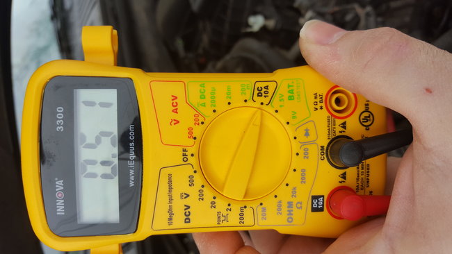

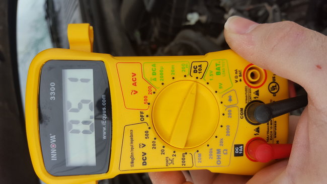

i check everything today and its putting out 0.53 on my Innova tester when turn off over night , is that normal ? if not what number am i looking for this?

That is 1/2 amp. Way too high.
When the reading is correct it will read .050.

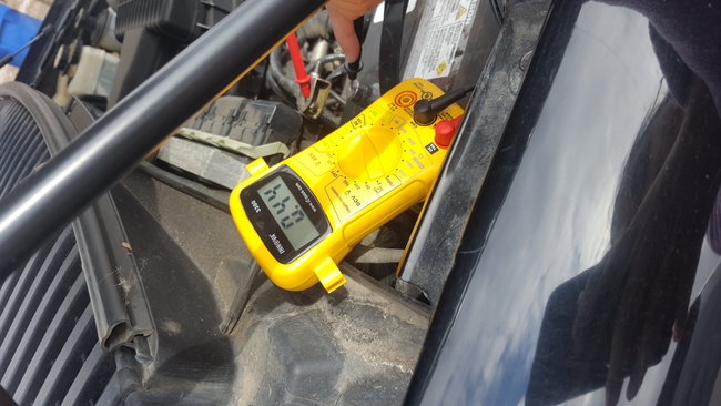

Okay. Thanks guys for all feed back!! i re did all fuses again and had 1 fuse that made it drop to .42 and was mirror lights etc.. what else can i check under hood with tester to see why there is .42amps putting out? maybe a bad diode? did alternator test already and was good 14.3 when running .

hi , i recheck all fuses and relays and stay the same .42 with 1 fuse out and wondering if .42 is good because i used innova 3300 and it said it's a multi-reader device. past 2 days i checked fuses and came to .52 with all fuses in . what do you think ?
Apr 11, 2020 at 10:00 AM
No, again, it should be .050. You have 1/2 amp reading.

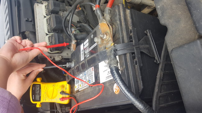

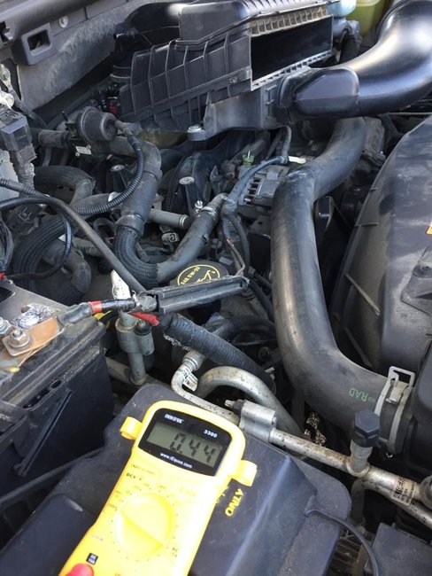

Can you take a picture of how you have you meter hooked up?
Apr 11, 2020 at 10:05 AM
TERRY L MENESES
  • 33 POSTS
It's called multi-reader I guess?
Apr 11, 2020 at 10:06 AM
I need to see where the leads are connected.
Apr 11, 2020 at 10:08 AM
TERRY L MENESES
  • 33 POSTS
Here's a good picture:
Apr 11, 2020 at 10:53 AM
TERRY L MENESES
  • 33 POSTS
No, this one sorry.
Apr 11, 2020 at 10:54 AM
Good. Now leave them attached and remove each fuse one at a time and see if the draw drops.

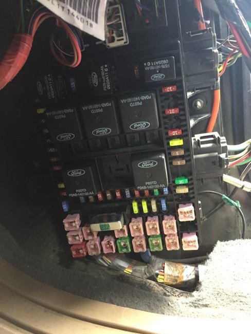

yes, i did that 3 times in 2 days bud and not one fuse made it drop . stayed the same and pulled out . only fuse box i found was on the passenger side on my SUV. is there more fuses elsewhere i can check? I will take picture of box and was a lot.

Here box bud, thanks for your patience.
Apr 11, 2020 at 11:23 AM

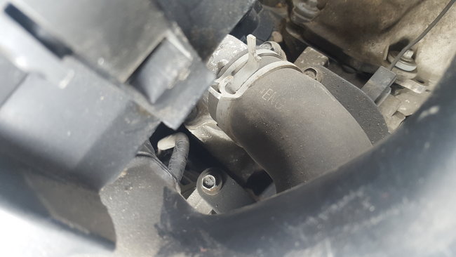

You have 3 relay panels but no other fuse boxes.

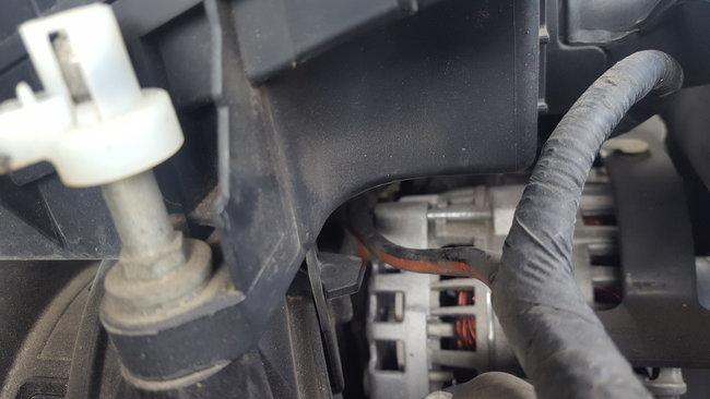

Did you disconnect the big wire on the back of the alternator?
Apr 11, 2020 at 11:32 AM
TERRY L MENESES
  • 33 POSTS
no, i didn't disconnect the wire on alternator. what do i do?
Apr 11, 2020 at 11:43 AM
Remove the wire from the back of the alternator. It should be held by a nut.
Then check the draw.
Apr 11, 2020 at 11:48 AM
TERRY L MENESES
  • 33 POSTS

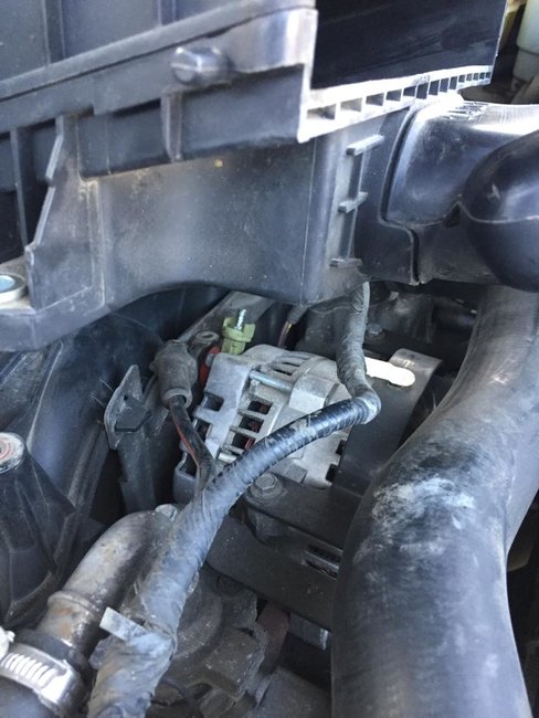

There's 2 wires going to alternator , 1 has black and red wire going to back in a plug in plug style no nut . And 1 black plug going to right side back of alternator with plug on plug style too. Which one I unplug? Thanks
Apr 11, 2020 at 12:14 PM
The black/red wire is the one to disconnect.

i can't get at alternator so going buy socket for it tomorrow. could i just unhook 1 cable that is coming to positive on battery that runs to the alternator? will that work ?
Apr 11, 2020 at 2:26 PM
No, that turns off the test.
You need to disconnect the alternator.
Apr 11, 2020 at 2:28 PM
TERRY L MENESES
  • 33 POSTS

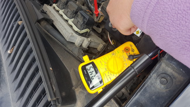

I check again with alternator unplug and still at .44 and I have a actuator that clicks under dash board but I think that has nothing to do with anything.

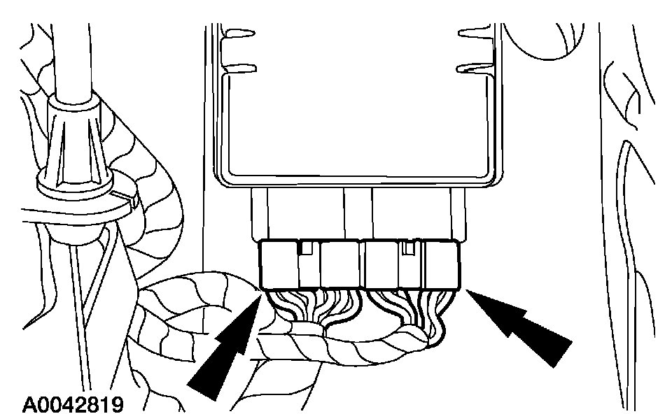

I wrote this and then after submitting it, realized I had the sequence mixed up. There are three things I need you to try. I indicated order at the start of each check. Sorry about that.

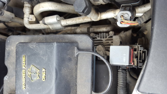

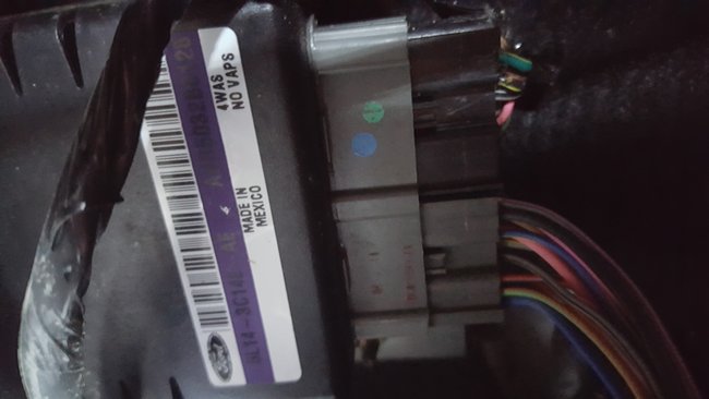

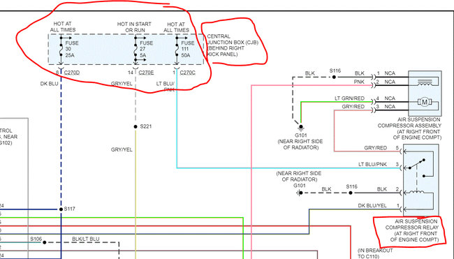

Roy, I thought you had it with the alternator / diode thought. However, I want to try something with this. Since the suspension light is on, there is an air suspension module under the dash that may be drawing power. Also, the idea that a relay is being heard needs to be looked considered.
Do this 3rd --- I attached a pic of the module. With the battery disconnected, unplug the suspension module and then do the test. The air suspension control module is mounted to the lower left side of the dash above the parking brake. Make sure the battery is disconnected before disconnecting or reconnecting the module.
Do this 1st --- There should be an air ride on off switch in the rear left of the vehicle. Chances are it is hidden behind the trim. It is a toggle switch. See if that changes things.
Do this 2nd --- If you haven't already, remove the fuses in the fuse box at the right side kick panel. That is the place you would rest your right foot if you were the passenger. See pic 2 for fuses I'm referring to. I have a feeling we found the issue, and it's related to the air ride. Note that the relay for the air ride is under the hood.
Let us know.
Apr 12, 2020 at 8:34 PM
TERRY L MENESES
  • 33 POSTS
Relay in front of washer fluid was on the right side , was that suspension relay? Also under dash I unplug both and that was air suspension control module? If so still at .44 but I started truck and charge system light is on now flashing and when I drove it , it was warning me about it every 10 secs
Apr 13, 2020 at 3:33 PM
Did you test it with the alternator unplugged?

yep, yesterday and was still the same.44.
