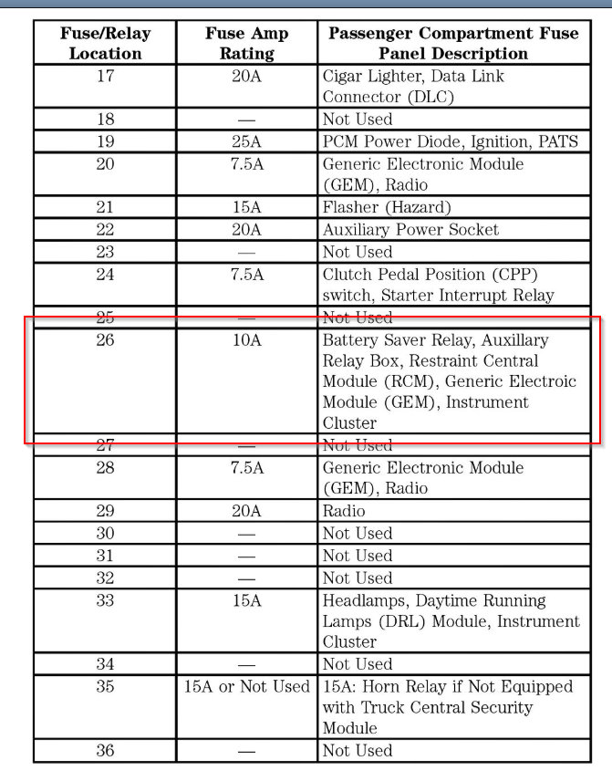

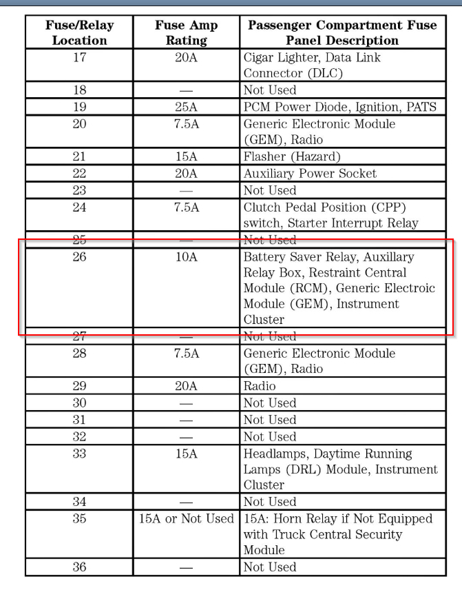

SPEEDILAD
I flipped the latch. Courtesy light out.
Tested current draw. It was .195.
Pulled fuse 26 & current draw dropped to .014. What now?

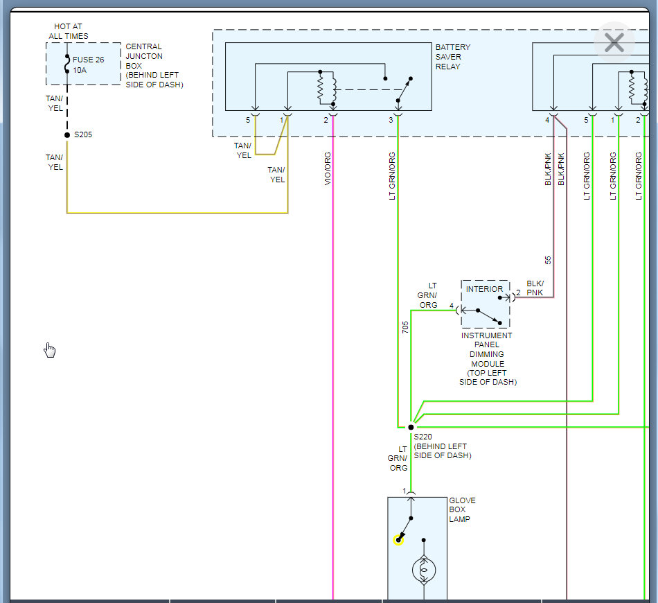

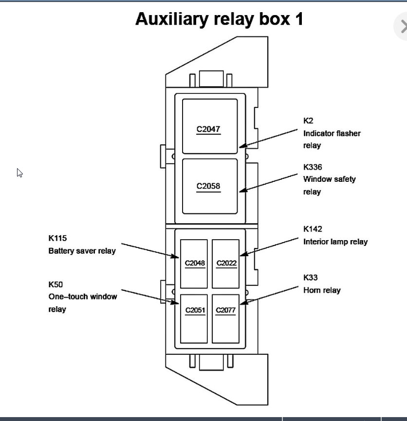

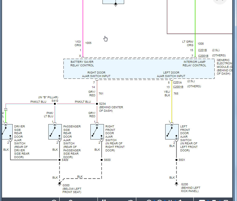

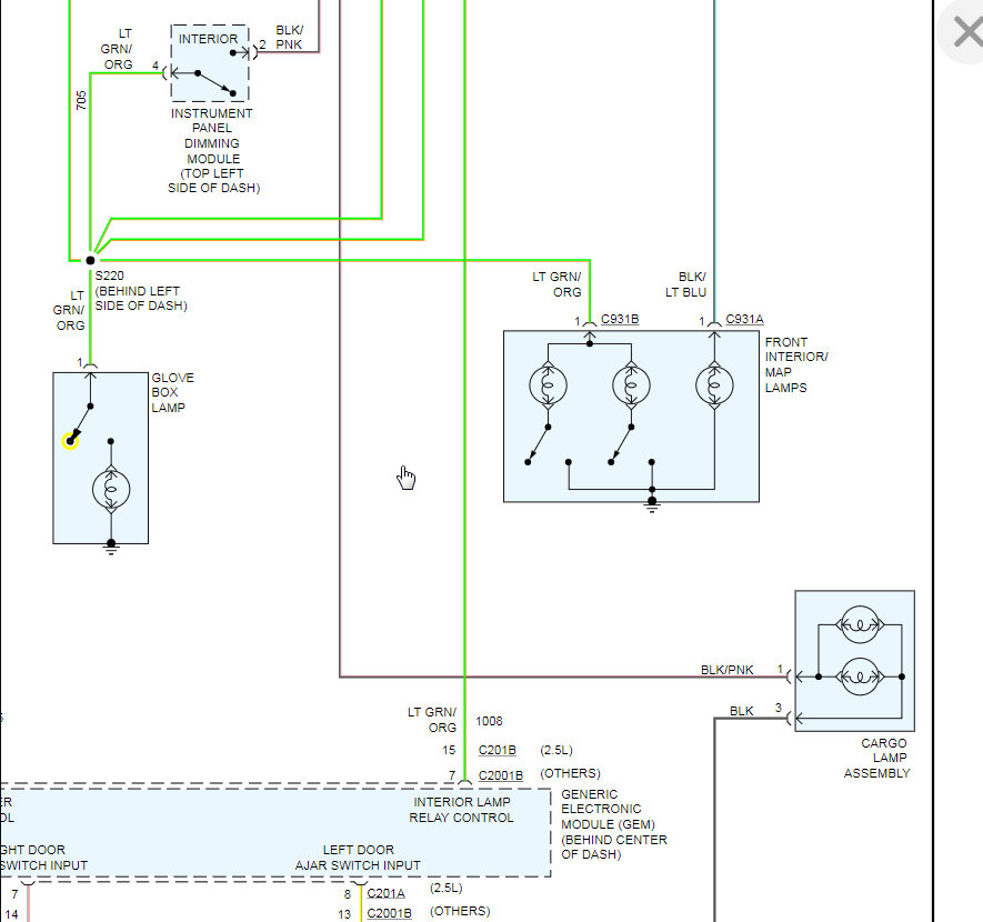

That is great. Now we need to dig into what is on that fuse. Take a look at the attachments. Basically there are a number of things that we need to eliminate to find out what the specific component is that is causing the draw.
Next thing to do is plug back in the fuse 26 and go to the auxiliary relay box and remove the battery saver relay and see if the draw goes away.
If this goes away then we need to plug the relay back in and go to each component on the relay and unhook them one at a time until it is gone.
Does this make sense? Picture this issue being a tree. The specific component draining the battery would be one leaf on that tree. Basically you have found the branch that the problem leaf is on, now we just need to narrow it down to the twig and the the leaf on that twig that is causing the issue.
