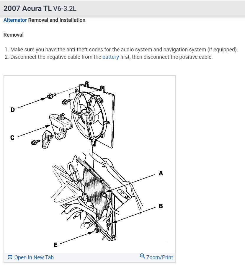

Yesterday I turned on my car and drove for about 30 seconds until the battery light came on, so I decided to turn around and drive home. Then the VSA light came on too and the brake light. After I got home, I decided to turn it off and when I tried turning it back on the car was completely dead. A few hours later a neighbor helped me to jump start it and the car would not start at all, only some lights turned on, but it wouldn’t start even after 10 15 minutes. I don’t know if I should buy a new battery or if it’s the alternator, but my car was driving fine before it didn’t make any weird noises or anything out of the ordinary.
Aug 31, 2023 at 5:31 AM
  • 55,721 POSTS

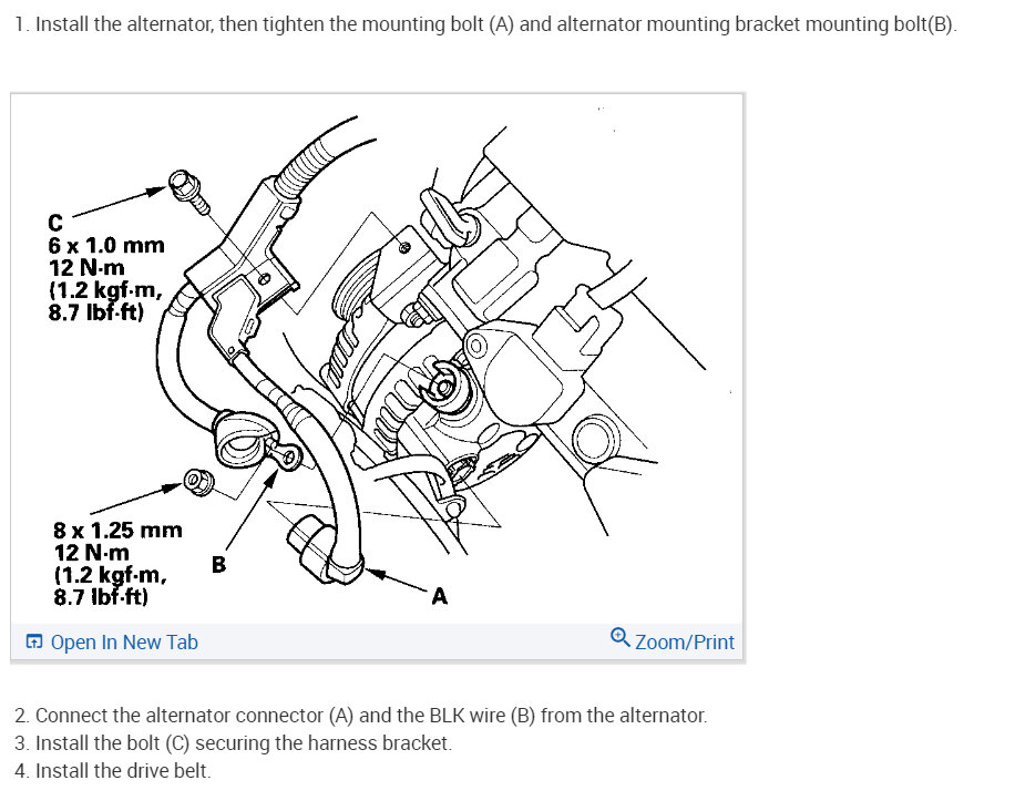

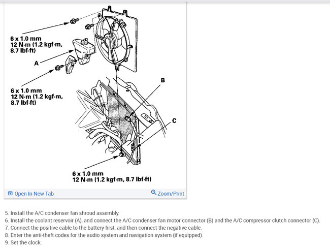

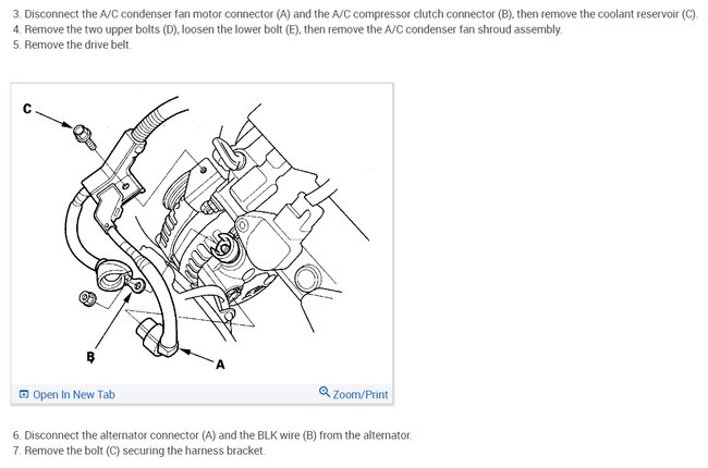

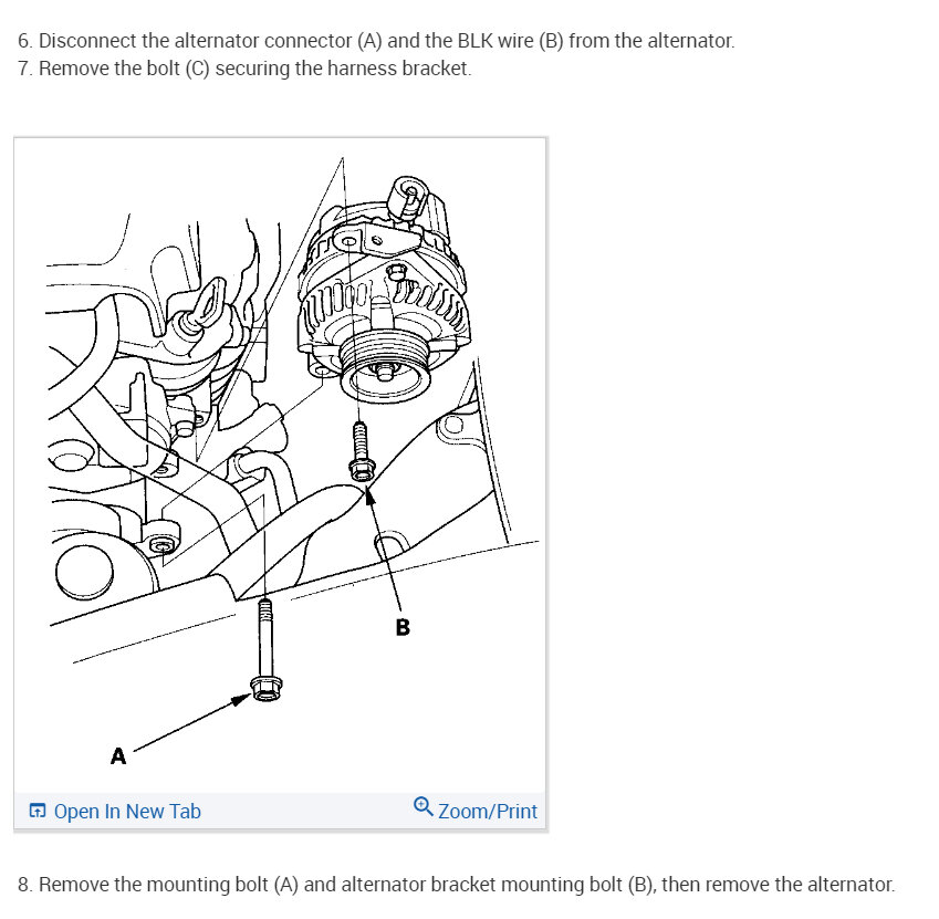

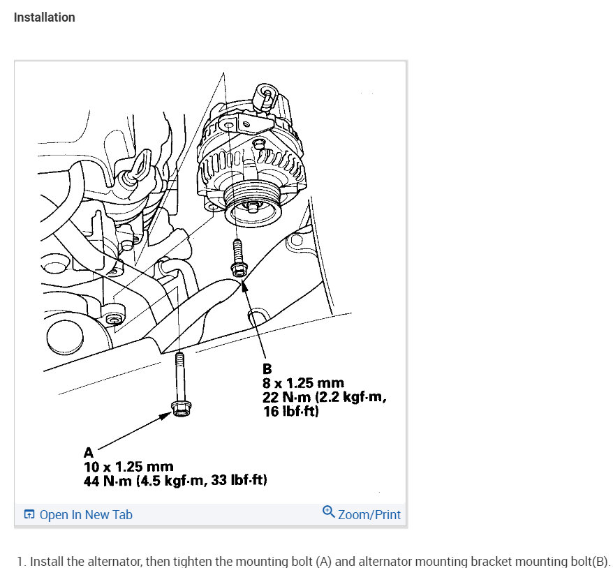

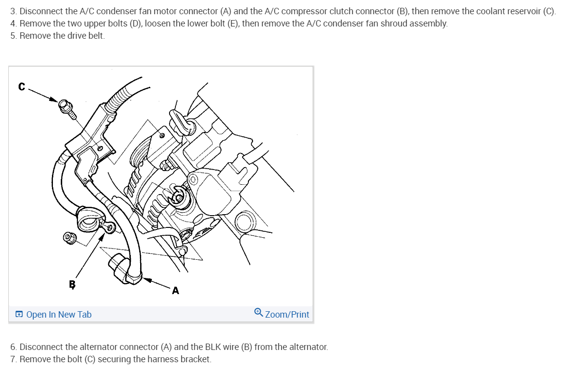

When the battery light comes on it means the alternator has stopped charging so that will be job #1, but if the battery is more than 3 years old, I would replace that as well. Here is how to change the alternator and battery out to fix the problem:
https://www.2carpros.com/articles/how-to-replace-a-car-battery
Check out the images (below). Please let us know if you need anything else to get the problem fixed.
