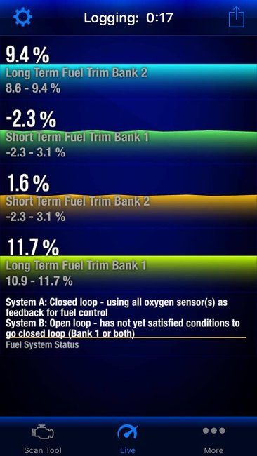

The car starts and runs fine, however it runs extremely rich. My live data scanner shows that bank A is running closed loop, while bank B is always running open loop due to unmet conditions.
Bank B stays in open loop due to unmet conditions. The only time it switches to anything else is when I press the gas and the live scanner shows both Bank A and B in open loop due to driving conditions, however when the rpm's settle bank A goes closed loop, and bank B is back to open loop due to unmet conditions.

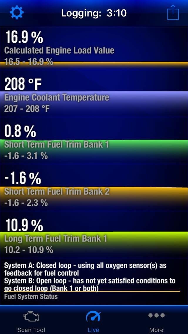

After all of this work was done the car started and the live data scanner showed that both banks where in closed loop, the car sounded great and idled perfectly around 650 rpm's for a while.
I was playing some music, and letting the car idle for a while (twenty to thirty minutes) testing things out, and suddenly I felt the idle get really rough, and I could hear some misfiring going on little pops here and there, and when I would press the gas pedal there would be missing and it wouldn't be very smooth.
I immediately pulled out my live data scanner and I was seeing.
BankA: Closed loop.
BankB: Open loop due to unmet conditions.
Coolant temperature: (around 200 degrees F at the time).
Throttle position: 0% ( no dead zones all the way to 100%).

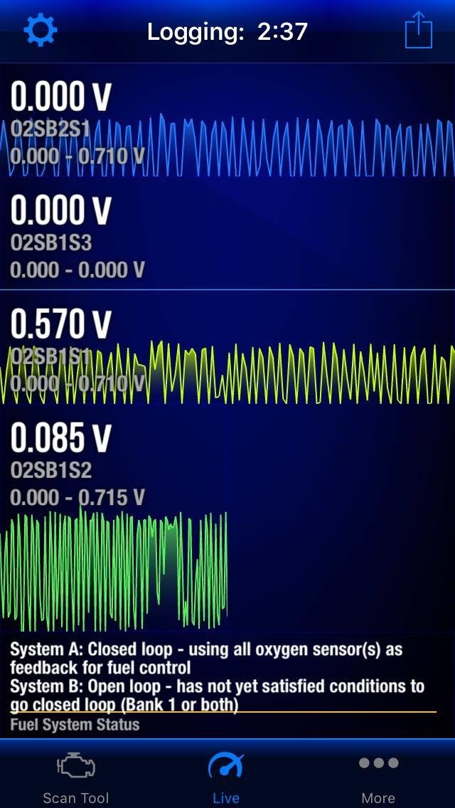

O2 Bank 1 sensor 1: swinging back and fourth between 0 and 1v
O2 Bank 2 sensor 1: swinging back and fourth between 0 and 1v
For whatever reason o2 bank 1 sensor 2 and 3 ( pre and post cat o2 on my car) are intermittent, they seem to only show up when the car is in closed loop, or diagnostic mode is triggered sometimes. the pre and post cat O2 sensors are the four wire sensors with the fourth wire being a ground, I tested the ground points, and everything looks good. Also, considering in closed loop, the sensors go between 0 and 1 volt fine I do not think they are an issue either. I have replaced them for good measure though.
O2 operation on this car (from what I have witnessed prior to this issue).
Bank A and B closed loop: all 4 sensors work
Bank A or B Open loop: only upstream sensors work (b1s1 b2s1).
Diagnostic mode bridged: all four sensors kick on and work.
Currently both upstream o2 sensors are working fine, and with diagnostic mode jumped all sensors show up just fine.
Diagnostic mode not jumped = working front o2 sensors with intermittent pre and post cat o2 sensors.

Worst of all is that the car is running super rich now.
I noticed a map sensor problem as well, if I have the map sensor hooked up the fuel trims spike, and keep climbing past 35%. There is so much fuel being added that raw fuel vapor is exiting the pipe (not water), the ECU would then attempt to make some sort of correction and the fuel trims would go back to 0 then the idle would drop quickly and sometimes stall the engine. So I put a new-used map sensor on ($140.00 plus from Ford or Mazda new). The new-used one seems to work intermittently, the short term fuel trims spike and drop, the ECU does not seem to know how to correct and the car starts misfiring, idle increasing, decreasing, and things get really rough, and sometimes the car simply stalls out.
When I disconnect the map sensor the car runs with a nice more-less smooth idle, (as smooth as it gets running half open loop) and there is no random bogging of the engine as the ECU over compensates.
Basically with the map sensor totally disconnected the car runs with long term fuel trims around 10% +- a few percents. On both banks.
I have tested the live data of the car prior to this problem with the map sensor removed, as the random bogging at idle happened in the past, and the car ran in perfect closed loop with the map sensor totally removed from the system. So I do not personally believe that the map sensor is related to this whole mess, and I am unsure if its my map sensors that are bad, or something else that is bad.
I tried to get the long term fuel trims to come down to 0% to try to reduce the rich smell of the exhaust.
I found that unhooking the vacuum line to the fuel pressure regulator causes the long term fuel trims to hover around 0-2% on each bank, +- a few percents on the short term, which I would imagine is a good number.

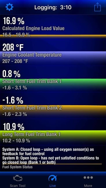

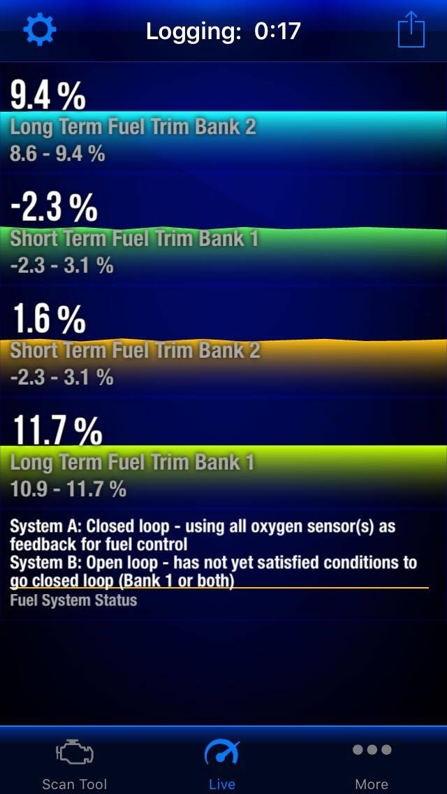

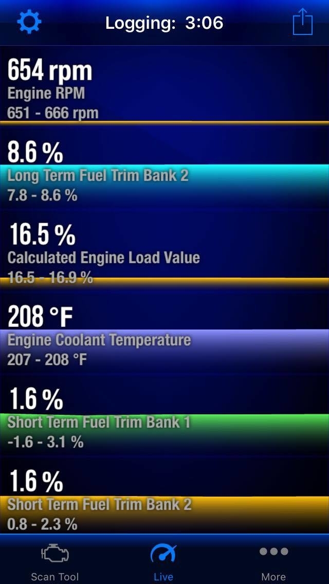

These are currently the only screenshots I have of the current O2 sensors working. In these screenshots I had the post catalytic converter o2 sensor disconnected, however I had proper readings across the board from all sensors. The fuel trims are about what I get with the fuel pressure regulator correctly connected to vacuum, the trims drop down around five or less when the vacuum line is removed from the fuel pressure regulator.

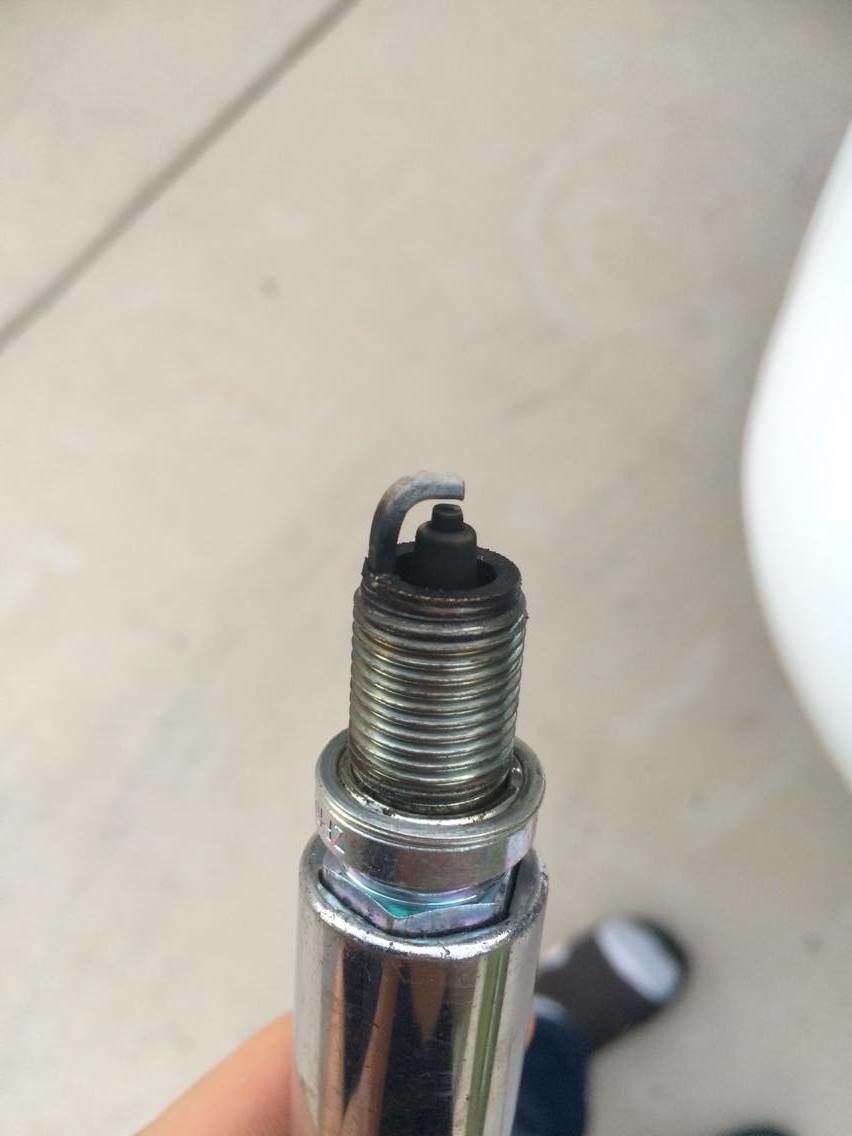

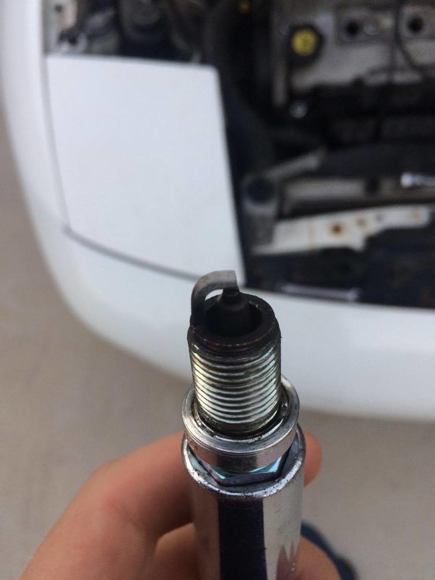

All of the spark plugs are identical in appearance. (see spark plug images)
I cannot seem to remove the pictures that all posted in duplicates. this is a tad frustrating and misleading. There are only three pictures I was expecting to post.

in those graphs the post catalytic converter O2 sensor was disconnected. However, when it is connected all sensors work normal. However the issue persists.

Plug in the sensors. Then give me a screen shot of long and short fuel trims at idle and at say 2000 rpm. Also a shot of the sensor voltages at both.
FYI, if the fuel trims are being adjusted on both banks the engine is in closed loop. It cannot be in closed loop on one side and not on the other. The ECM controls both sides in closed loop, but you could easily have a bad injector on one bank dumping fuel either through a bad injector or a failed o-ring at the bottom and it is dumping fuel directly from the fuel rail.
