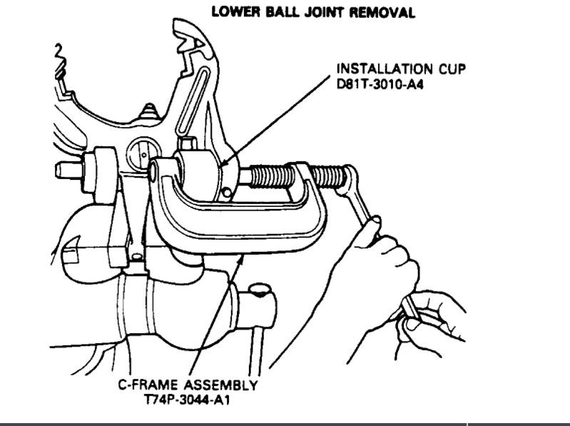

Lower ball joint not his cut halfway through but I have nothing to finish the cutting with.

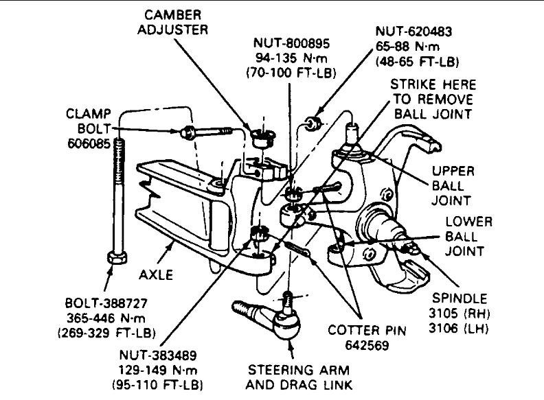

I posted the procedure below for you to view and some pictures as well.
REMOVE
1. Remove the spindle and ball joint assembly from the axle. Refer to Spindle/Service and Repair.
2. Install the spindle assembly in a vise and remove the snap ring from the lower ball joint. Remove the lower ball joint from the spindle using C-Frame Assembly T74P-3044-A 1 or equivalent and Receiver Cup D81T-3010-A or equivalent. Turn the forcing screw clockwise until the ball joint is removed from the spindle.
3. Assemble C-Frame Assembly and receiver cup on the upper ball joint, and turn forcing screw clockwise until ball joint is removed from the spindle.
NOTE: Always remove lower ball joint first.
CAUTION: Do not heat the ball joint or the spindle to aid in removal.
Ball Joint Service
Ball Joint Service

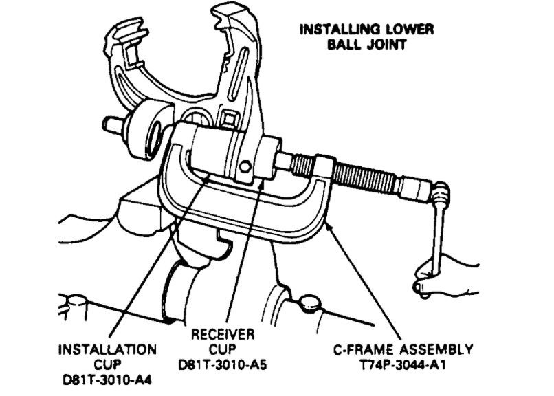

INSTALL
NOTE: Lower ball joint must be installed into the spindle first.
1. To install the lower ball joint, assemble C-Frame Assembly, Ball Joint Receiver Cup (D81T-3010-A5) and Installation Cup (D81T-30 10-A1 and D81T-3010-A3) or equivalents inside cup (D81T-3010-A4 or equivalent) in position on the spindle. Turn forcing screw clockwise until ball joint is seated.
CAUTION: Do not heat the ball joint or axle to aid in installation.
2. Install the snap ring onto the ball joint.
3. To install the upper ball joint, assemble the C-Frame in position on the spindle and repeat Step 1.
4. Install the spindle and ball joint assembly
