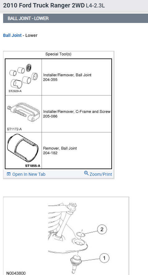

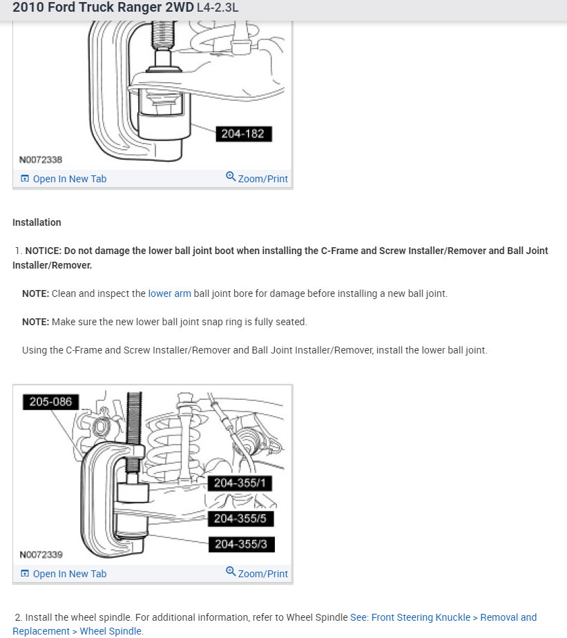

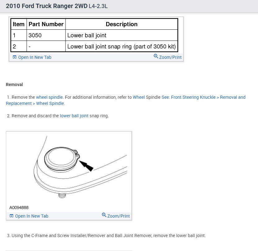

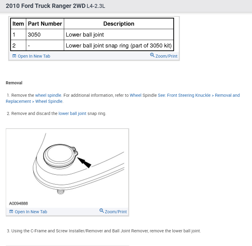

The ball joints cost around $20.00 to $25,00 each.
As for the installation and you take it to the shop it will depend on their shop rate. It should be around 2-3 hours of labor. So, the total price will depend on the shop rate.
https://www.2carpros.com/articles/how-to-release-a-ball-joint
