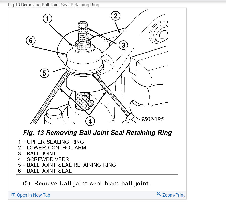

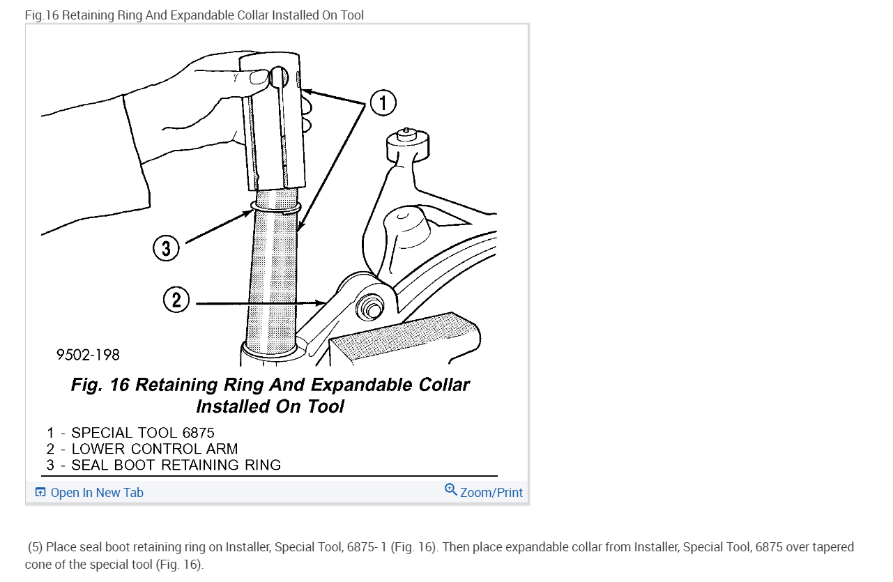

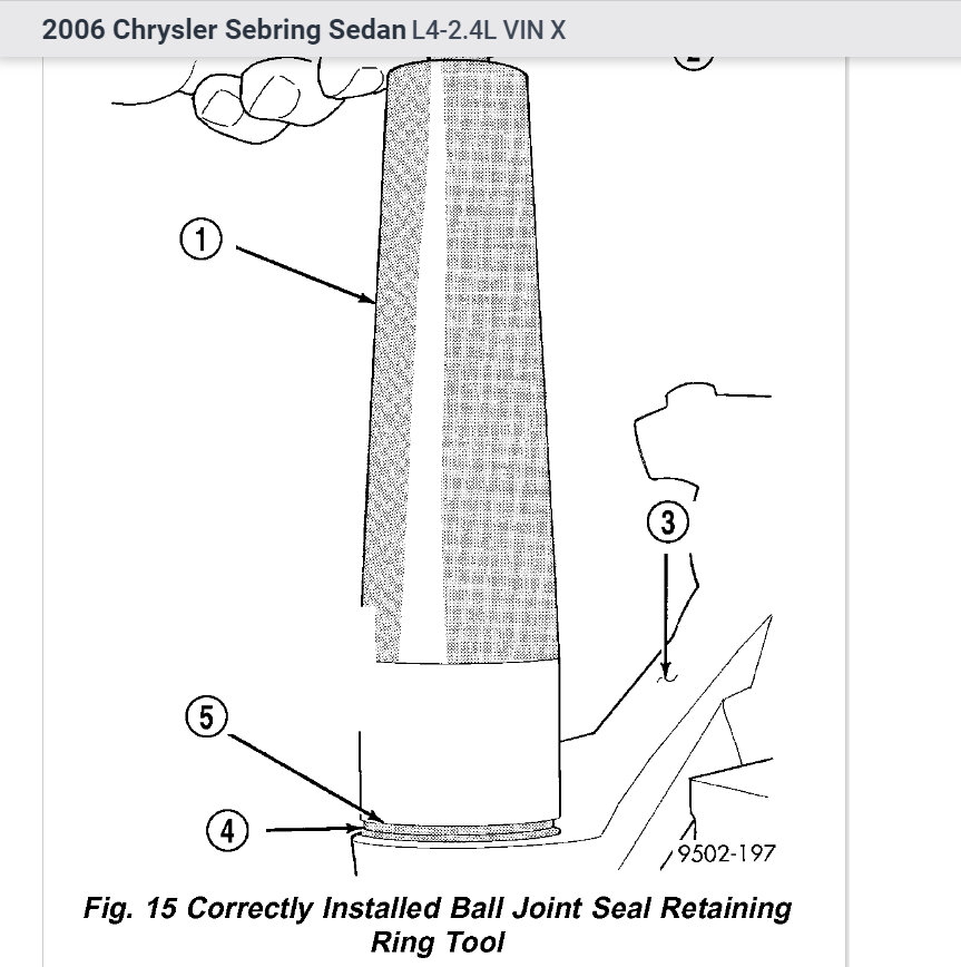

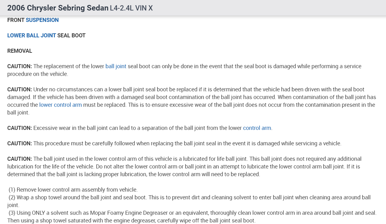

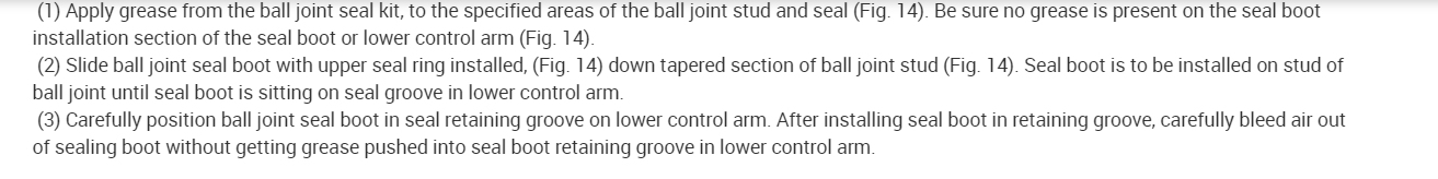

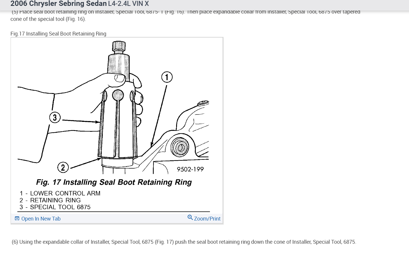

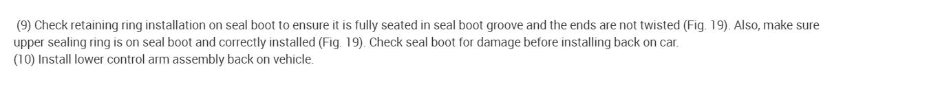

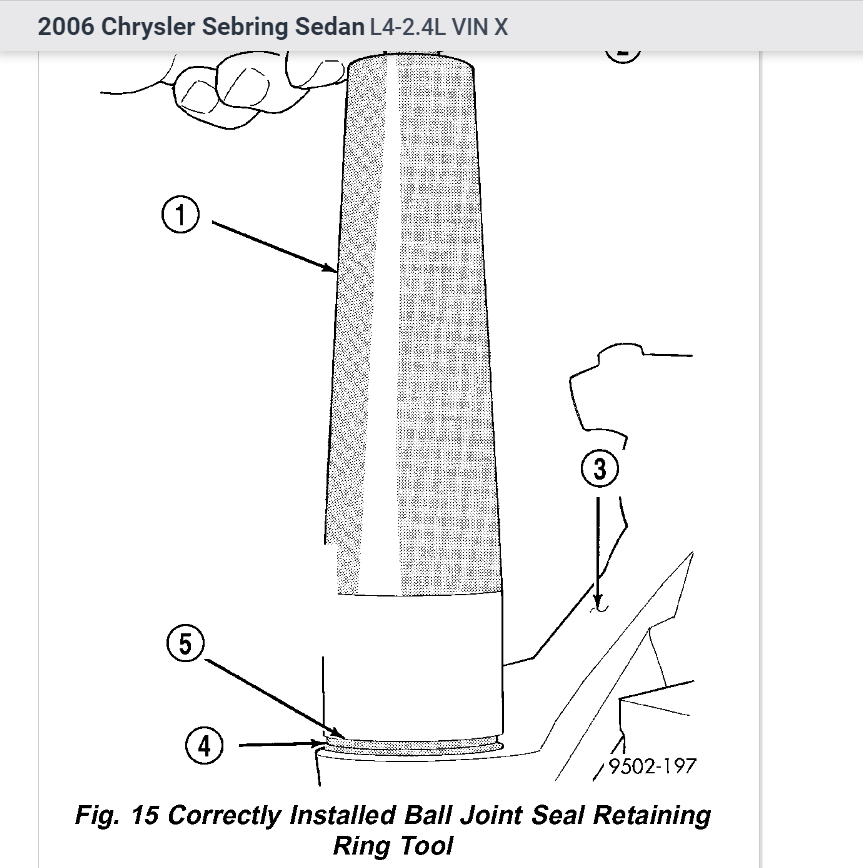

How do I remove a broken ball joint with no screw and ball?
Mar 18, 2023 at 10:56 PM
  • 54,832 POSTS

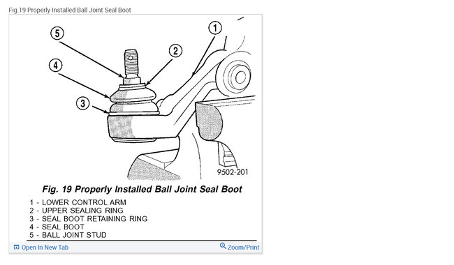

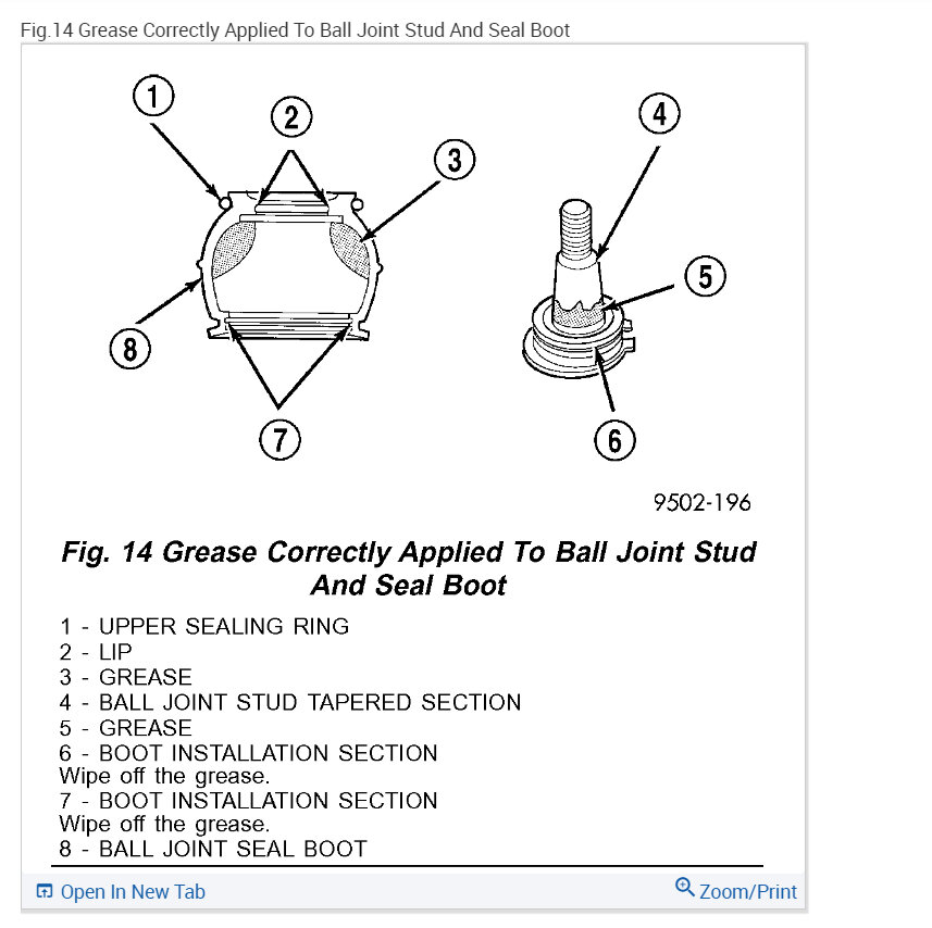

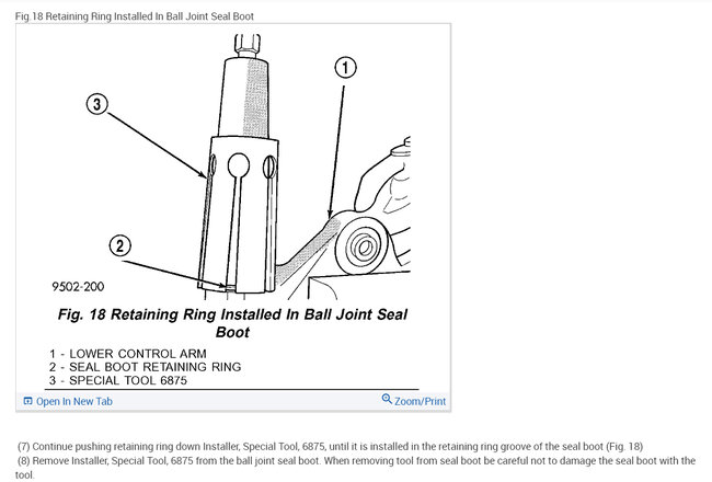

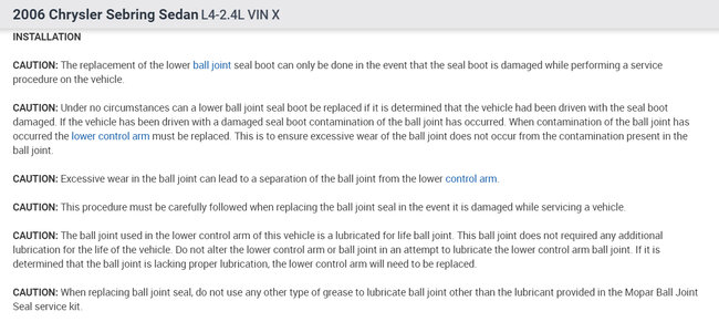

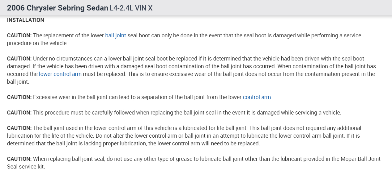

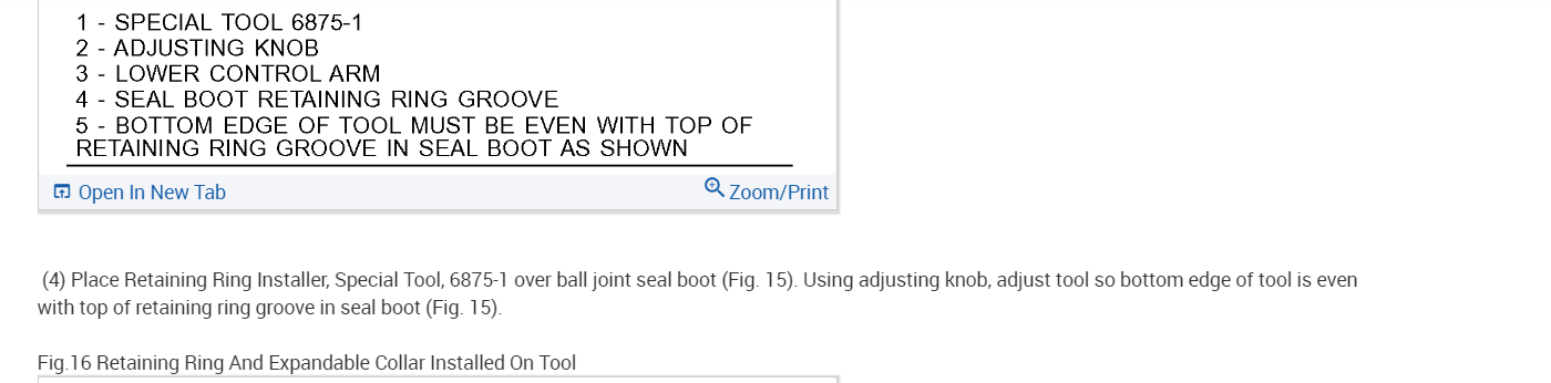

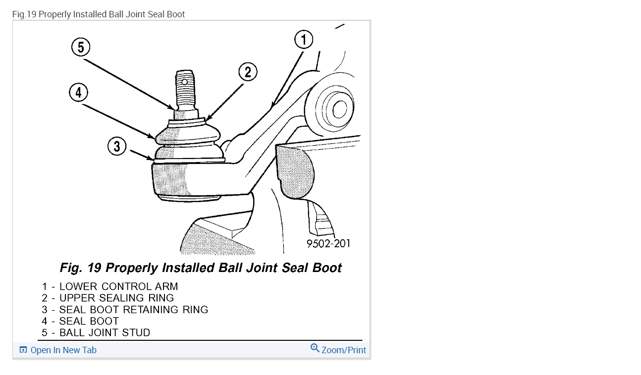

Can you upload a picture or video of the problem so we can help? Here are the instructions in the images below for a normal ball joint replacement. Have you considered a lower control arm? Here is one on amazon for $62.00.
