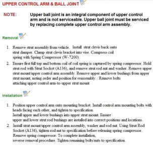

Suspension problem
2001 Chrysler Sebring 6 cyl Two Wheel Drive Automatic
how do i get it out???
May 20, 2010 at 7:52 AM
BLUELIGHTNIN6
  • 16,542 POSTS
upper or lower? is this on the coupe or convertible?
May 20, 2010 at 8:57 AM
APARKER1022COMCAST.NET
  • 12 POSTS
SEDAN... it's the upper... my wife hit a pot hole... the ball joint popped right out of the housing and is now in two pieces... and i can't get the ball pin out of the caliper housing... the bottom of the pin has a spot to put a wrench to un losen but it's stripped. I cant get vise grips to losen it they wont catch because of the roundness of the ball joint... what do u suggest to get it off? do i need some kind of pully or jus some kind of un human strength??? lol
May 21, 2010 at 3:08 AM
BLUELIGHTNIN6
  • 16,542 POSTS
https://images.2carpros.com/forum/automotive_pictures/261618_Noname_2223.jpg
