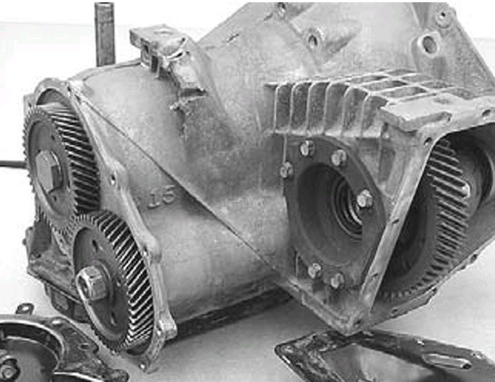

Okay. I am going to say that at this point if it is a repetitive clicking only when the vehicle is moving in tight turns that this is going to be inside the differential and not the strut.
If it were a single pop, then I would think a strut could cause this, but a repetitive clicking is something that is turning or related to this like what you replaced prior. So, I suspect it is one of the splined axles where they go into the differential at this point.

Okay. Thank you for clarifying that. It doesn't change much at this point because if everything you have done but it is important to know if it while driving straight and not turning when it makes the noise.
However, this means it is still in something that is rotating but changes when you enter into a turn. This would point again to the differential.
I would have suspected a wheel bearing but clearly that has been covered which leaves an internal diff issue.

Well, apparently, it's not because I still have that same issue. NEW- Strut, Sway Bar Stabilizer, Wheel Hub and Bearing, Lower Control Arm, Tires, CV Half Shaft. Let me add a more detailed description of this thumping. You have a tire blow out and the belt shreds slapping into the wheel well, this is the thumping sound. No "vibration" as per say but when it thumps you can feel it more like that blown tire beating the fender apart. You don't need to even leave the drive to test it as it's coming in reverse too. I might add I had noise on the passenger side in the beginning, but it got resolved by replacing a CV Half Shaft and a defective wheel hub and bearing assembly then the driver side came into play then I changed the CV Half Shaft on that side right away. Also, I was looking to my rebuild guide for this 41TE transaxle and it doesn't seem logical that differential would be the problem (see photo) since the half shaft splines go deep into that gear in the differential. I called the AMACO mechanic in Utah. I saw when the transaxle was damaged (the end gear area) and he said it's highly unlikely the differential is the problem since no thumping when operated off the ground. His explanation was that had it be the differential there'd be radical noise coming from both sides of the car not just the driver's side. Missing something here.
