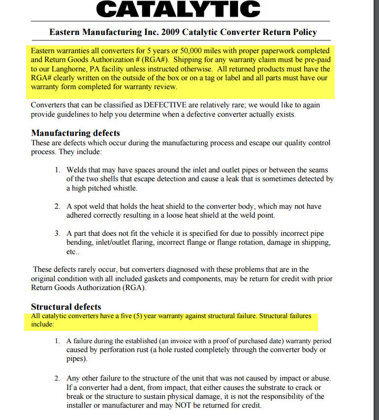

Talked to the mechanic's assistant and he stated that that should not happen with today's after market cats. He told me that they are heavy metal and should not burn out a cat within two weeks. Told me to get it checked and bring it to their shop to take a look at it. This will be the second time I have taken it back
Tuesday, April 12th, 2016 AT 3:27 PM
HMAC300
  • 48,601 POSTS
Take this vehicle to another shop other than the one that it was repaired at. Iforgot to send the pics I printed regarding converters. They are warrantied for that your problem should be tested with the information that I sent to you in previous replies. Read this pic. I think you are asking for more trouble if you take this to the same shop. They shouldn't burn out like that . I don't know what else to tell you so I have no other comments or suggestions.
Tuesday, April 12th, 2016 AT 4:53 PM
JMCMAHA
  • 13 POSTS
Thank you very much. I appreciate your help! One last question. It is an aftermarket. Is the warranty you attached good for aftermarket cats as well? I am taking it to another shop. Thank you!

HMAC300
  • 48,601 POSTS
The warranty that I posted in the pic is from an aftermarket cat maker. And amen to what cardio doc is saying. That is only one maker others are different but most have a warranty they have to by law. I have nothing else to say.
