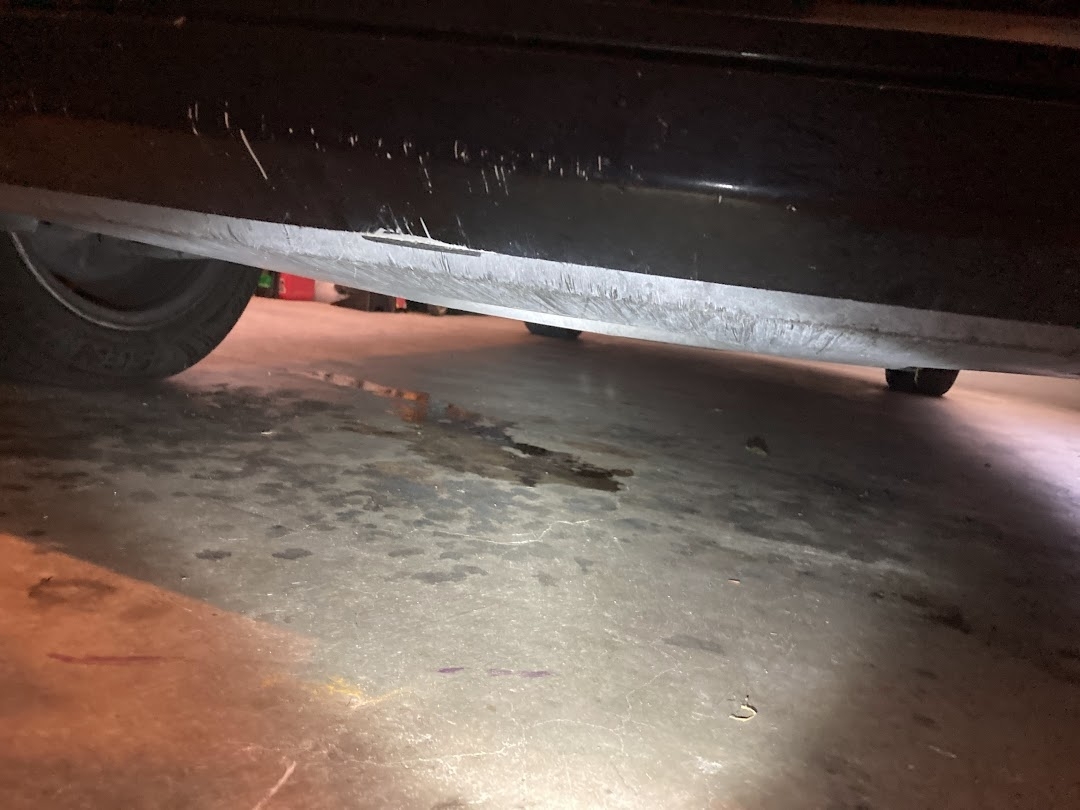

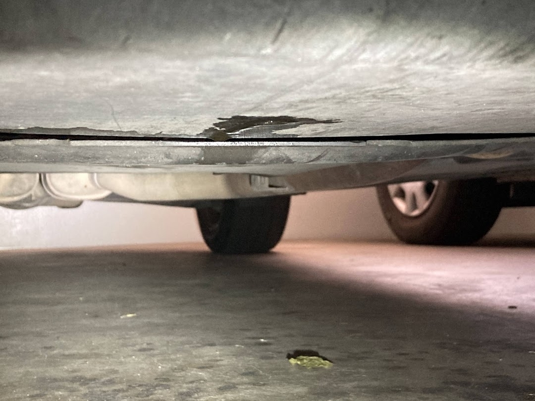

Recently, an oil leak has developed towards the bottom of my car. It has gotten really bad and has started leaving puddles everywhere.
I was wondering where it could possibly be leaking from? I've checked the valve cover gaskets so far and they are all good. I am suspecting it is possibly the oil pan gasket or the drain plug washer, but I am not sure.
I haven't jacked up the car yet. Before I do, is there some sort of common area that these Mercedes tend to leak oil from?
I have some images of the leak to hopefully give you guys a better idea of where it's leaking from.

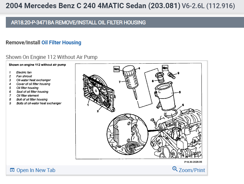

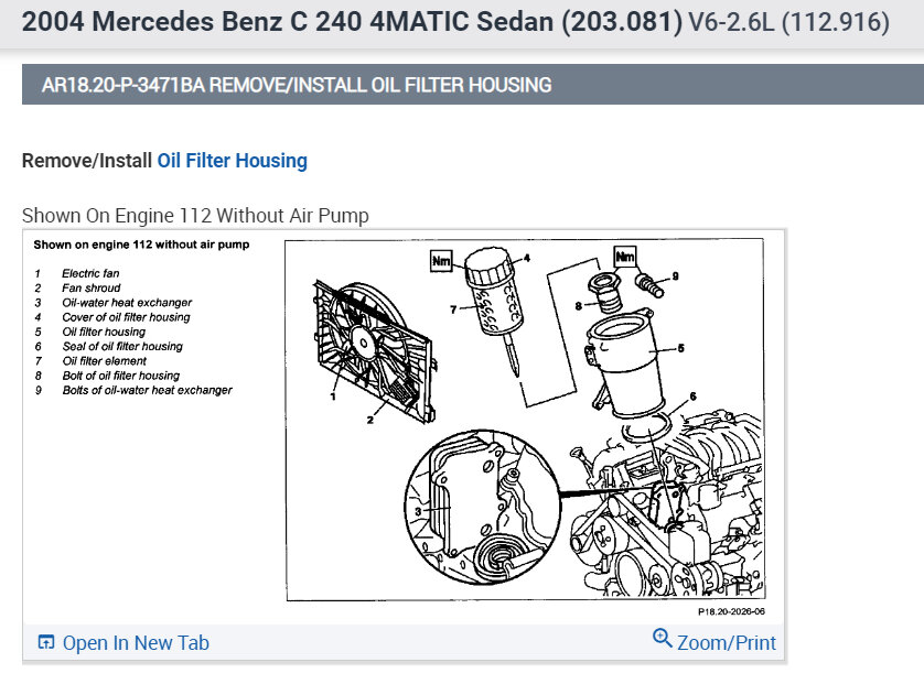

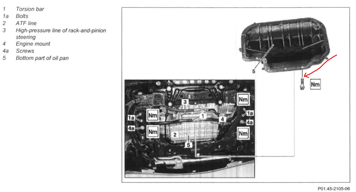

Thanks for the images. The oil filter and oil pan drain plug is a common place for the engine to leak oil. Here is a guide that can help find the leak as well:
https://www.2carpros.com/articles/engine-is-leaking-oil
I would raise the car up and remove the bottoms skid pan. Use a flashlight to see if you can find the source of the leak. This guide can help:
Here is a video of the oil filter and drain plug in a similar car:
https://youtu.be/Oaeqh38c6Z4

The drain plug is alright and even the front and rear seals are good too. The fluid also seems sticky. I changed the power steering fluid recently. Is it possible that there could be a leak somewhere?
Aug 13, 2023 at 3:13 AM
  • 55,399 POSTS
Yes, that is possible. Can you tell if it is power steering fluid or engine oil? Also check the power steering fluid to see if it is low, this can help us determine what kind of fluid is leaking.
