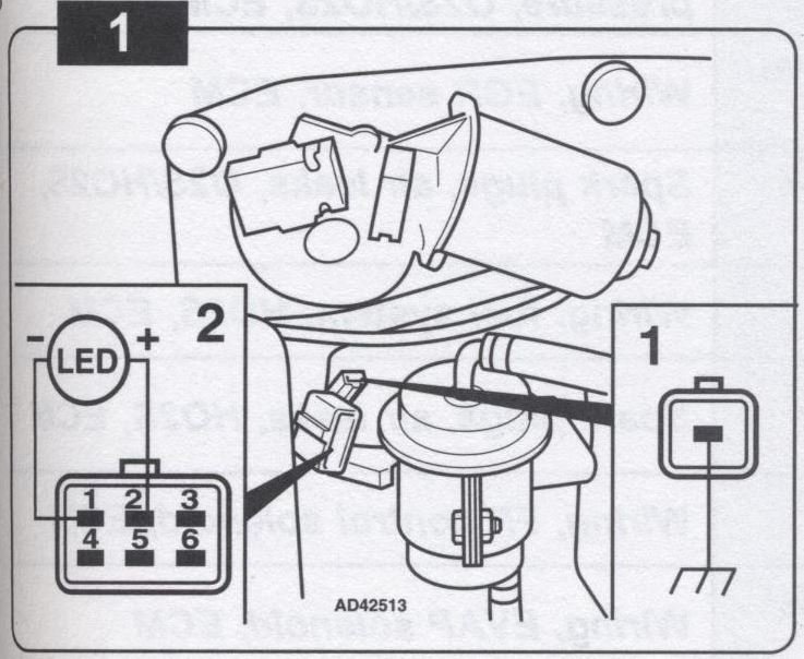

driving along, check engine light comes on with no change in performance. I am trying to pull the code so I grounded the one wire that's attached to the green plug on passenger side under the hood. Then I turned the ignition on expecting the check engine light to flash telling me what code has been set. The check engine light is not flashing, it just remains lit. What am I doing wrong? thank you
Apr 11, 2021 at 9:25 AM
STEVE W.
  • 15,409 POSTS

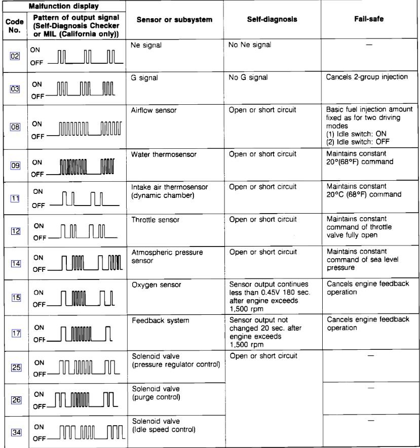

You have half of the process. You ground the green wire then you need an LED test light connected between pins one and two Then count the flashes on the LED. If it's an engine code it should be in the attached chart. Pull the code(s) and post them and we can see what the issue is.

I am confused about one thing. I am using a test light between terminals one and two, not an LED test light. Is there a difference? When I look up LED test light it looks like a regular test light.The test light did not flash, the check engine light on the dash did not flash.
Apr 27, 2021 at 2:50 AM
STEVE W.
  • 15,409 POSTS
Needs to be an LED light and attached so the ground is on pin 1 and the tip is on pin 2. Then the LED will flash the codes. The LED blocks current in one direction and that tells the ECU to go into diagnostic mode.

got the LED light and it flashes, trying to read the flashes.
May 6, 2021 at 3:15 AM
STEVE W.
  • 15,409 POSTS
The easiest way to do that is to set it up and just start counting the flashes, write them down and then stop when you see them start to repeat again. So say it flashes 1-4, then 0-3 then 1-5 then you see 1-4 again, Stop and the codes are the 2 digit numbers you find. If you really have a problem see if you can record them in a video and post that on here and we can try reading them.

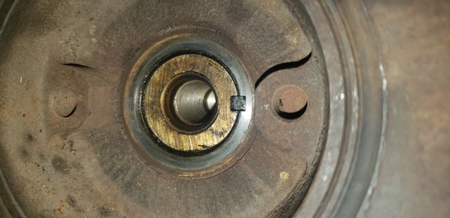

Its struggles with power on hard acceleration, seems like it's choking itself out. I have no fault codes. I have had to get the ECUs rebuilt on these trucks in the past and have had this one rebuilt. Here is the pulley, keyway is 1200 and the timing mark is at TDC.
Dec 5, 2021 at 4:57 AM
STEVE W.
  • 15,409 POSTS
Okay, just wondered if it may have slipped, have seen it happen a few times. Nothing like trying to set timing when the target is always moving around. Here's a test, you say bumping the timing up helps, try moving it a bit higher and then see if the top end power improves, if it does it would mean that the timing isn't advancing the way it should. What does the mark show if you rev it in park? Being a 1990 they generally don't set codes until things are really bad. Sort of like someone who won't go to the doctor for anything less than a torn off limb or a bullet wound, everything else is just "wear and tear" I've seen OBD I cars that never set a code but were barely able to run from all the things actually wrong with them.

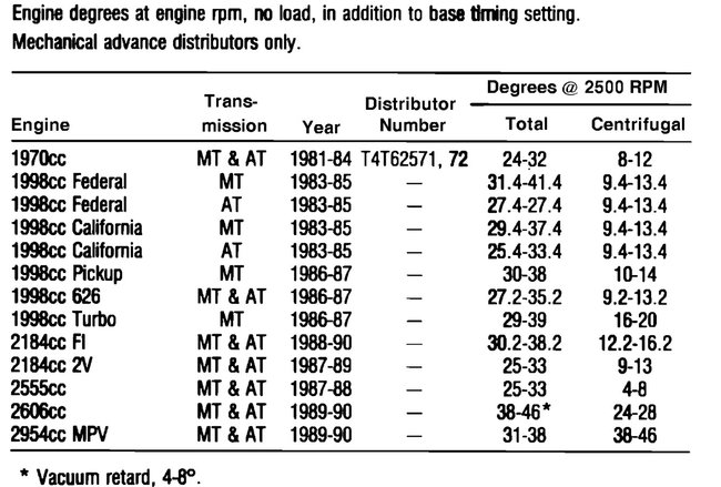

The timing barely moves at all while revving it up, maybe 3 degrees. I was told by another mechanic, which means the ECU is still bad. That sound correct to you????
Dec 5, 2021 at 7:35 PM
STEVE W.
  • 15,409 POSTS
The timing not changing is likely the root cause as it needs to advance as the rpms rise, when it doesn't you get the issues, you have. That distributor should have a mechanical advance in it as well as the electronic system, from your description I would say the issue is the mechanical parts as failures in the electronics would set a code due to the timing being off, the mechanical parts however won't set a code as they are not monitored. It's also possible as you see no advance at all that it's a combination of both.

ECU rebuilder found nothing wrong with my ECU, they sent me a known working ECU. I double, triple checked the timing pulled the valve cover off to make sure the distributor was going in correctly. Same hesitation problem runs great at 12* btdc, still no check engine light.
