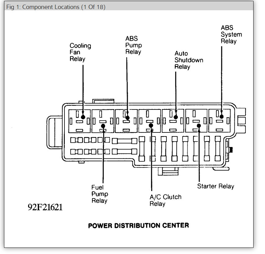

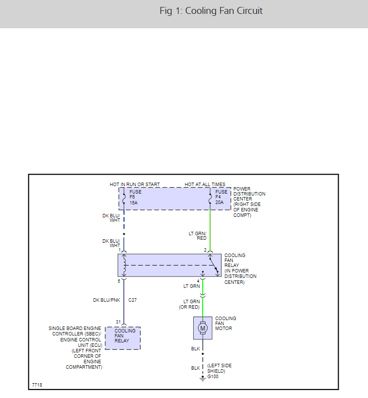

My vehicle has a fan operated by the engine and pulleys but there is also an auxiliary fan and that is not coming on. Sometimes the temperature gets above normal so I went to AutoZone to see if they list a cooling fan switch or sensor and no they do not list one. So I am wondering where else to look. Is there a relay or something else to look for? If so what is its location? Thanks for your help.
Nov 4, 2018 at 5:46 AM
  • 55,746 POSTS
It sounds like the relay is bad or the fan is bad. Here is a guide to help you run some test and the fan wiring diagrams so you can see how the system work with the relay location:
Check out the diagrams (below). Please let us know what you find.
